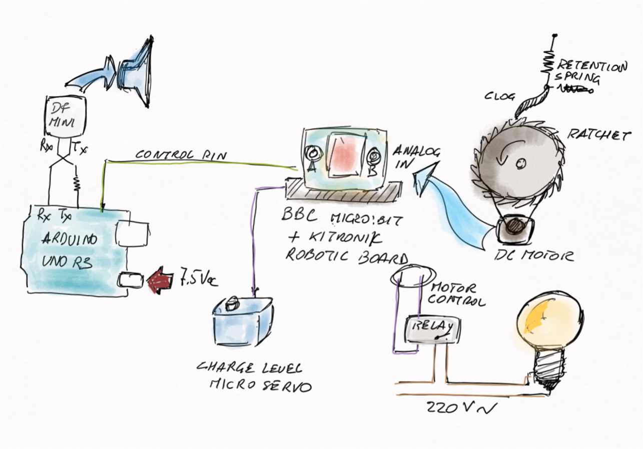

The project design shown in the above image is divided into two parts: the music generation and al the control and the musical box simulator.

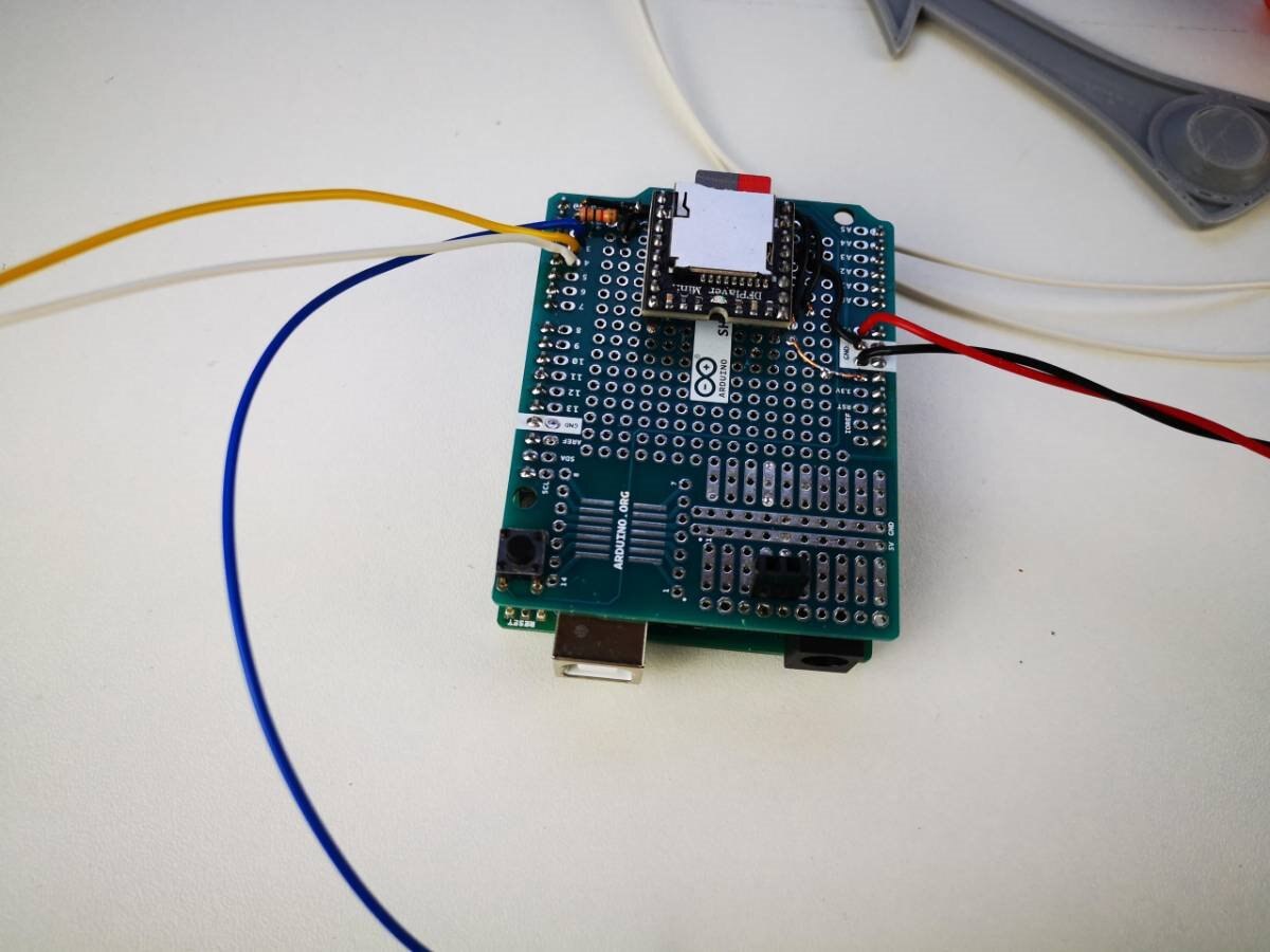

The core of the mp3 music player is based on the DFPlayer Mini Mp3 produced by DF Robot; The player includes all the features we can find in a commercial mp3 player:
  • six levels equalizer preset
  • track selection
  • volume control
  • amplified speaker output
  • earphones output
It also includes a microSD card reader to store up to 32 Gb of music in a maximum of 100 folders with up to 255 tracks per folder.

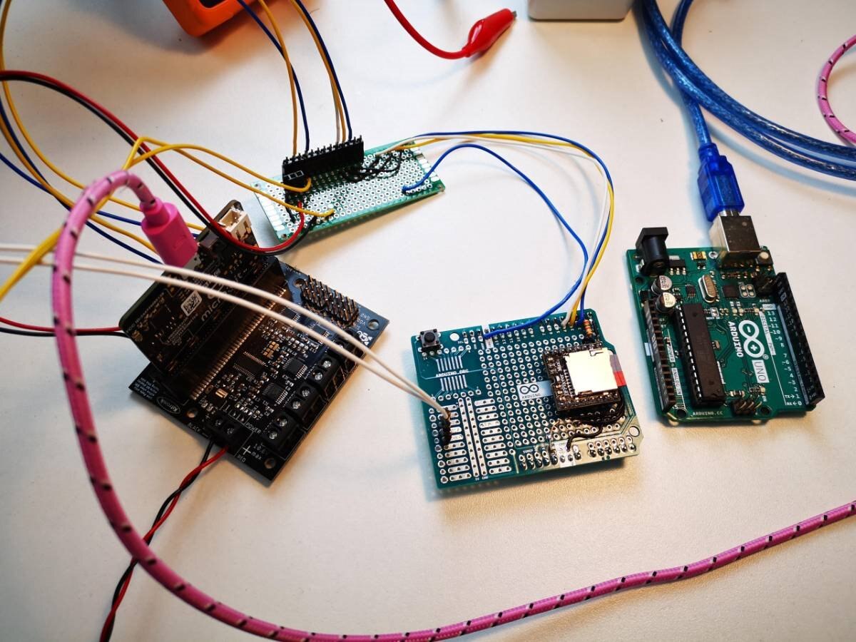

Above: The Arduino prototype shield with the DF Player mini mp3 player assembled over the circuit.
The DFPlayer Mini can be controlled in several ways, including buttons only: you can make your stand-alone mp3 player without any extra microcontroller but just some buttons and a battery. Very interesting instead is the RS232 control feature of the device, perfect to interface with the Arduino. The DF Player mini works at 5 Vcc and its low power consumptions make possible to power the player directly with the Arduino 5V. Every track of the playlist should be named following a numerical order, in the format 0001.mp3, 0002.mp3, etc. More details on how this device work can be found on the DF Robot documentation page: https://wiki.dfrobot.com/DFPlayer_Mini_SKU_DFR0299

In the Setup() function the mp3 player is initialized through the library, included in the sketch; after the initialization, the serial connection becomes unavailable for programming the Arduino sketch via USB. For this reason when the Arduino should be programmed the shield should be removed.
Above: when the Arduino board should be programmed the mp3 player – that I assembled on the prototype Arduino shield – should be removed to keep the serial port free for connecting to the computer using the USB to serial cable.

It is needed to add a 1K resistor in series to the Rx signal on the player side (corresponding to the Tx signal of the Arduino board) to avoid interferences on the audio quality due to to the serial transmission connection.

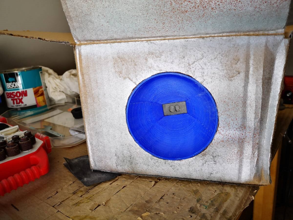

The audio output signal of the mp3 player is already amplified, supporting any speaker with 8 Ohm impedance and power not higher than 1W. I have used a square sized micro speaker (about 1,5x3x0,5 cm) mechanically amplified by a 3D printed large cone. This solution worked particularly well as the music box tracks have very few bass frequencies in their tracks.

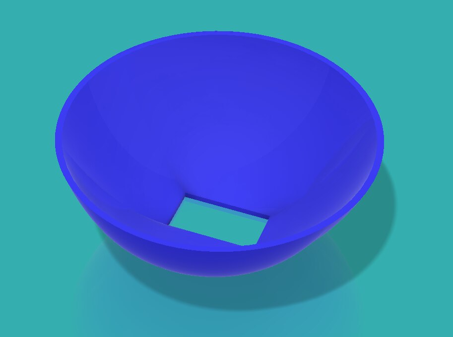

Above: the 3D printed semispherical speaker cone providing a good and audible sound level

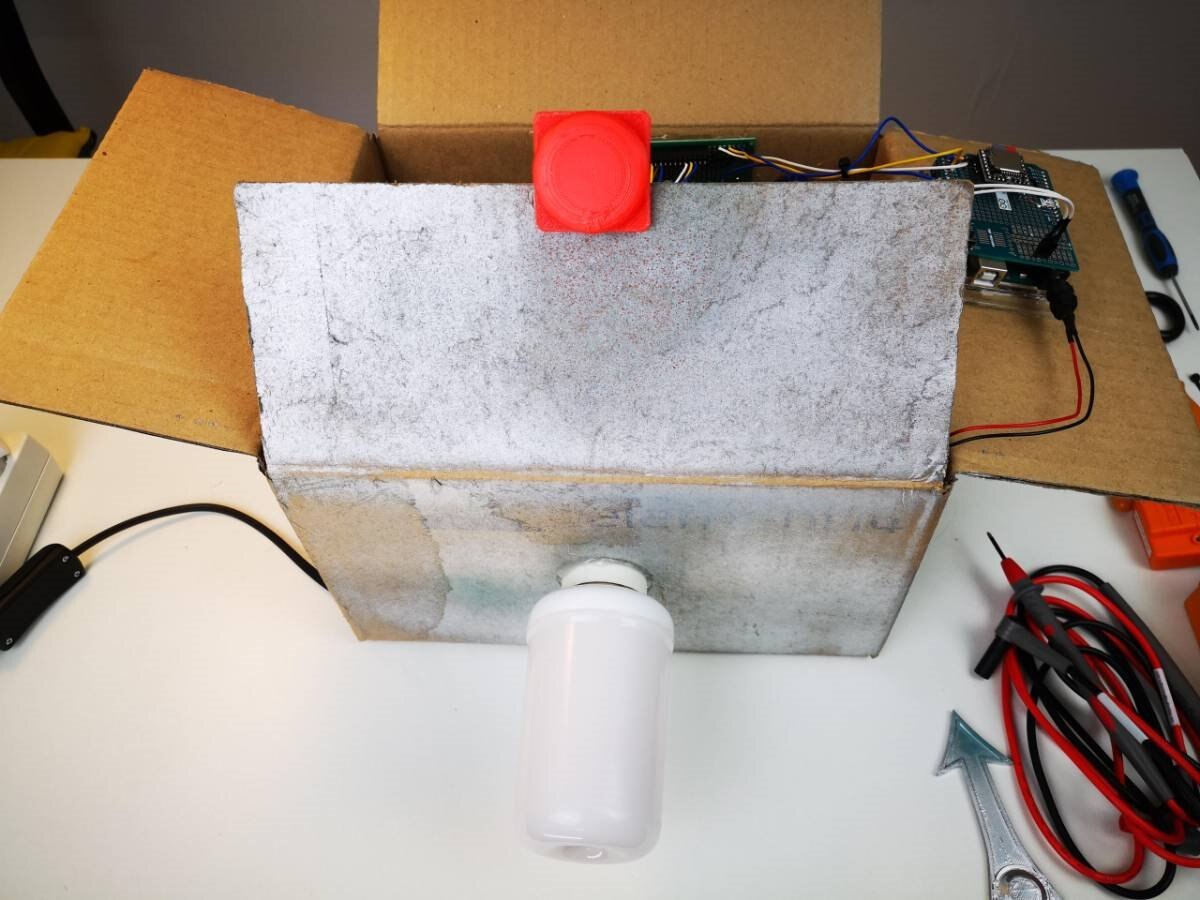

Designing the Box and Making the Components

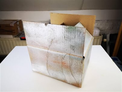

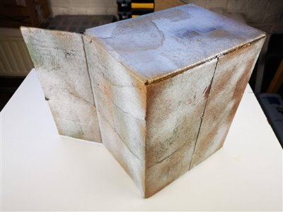

First of all, I got the right size cardboard box to convert it in the musical box container; it comes from one of the last Element14 shipments image I transformed in a rugged metal surface with a couple of spray-paint colors.
Below: the finished cardboard container box

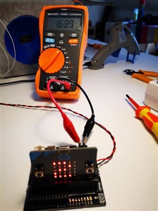

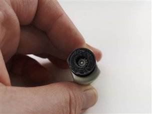

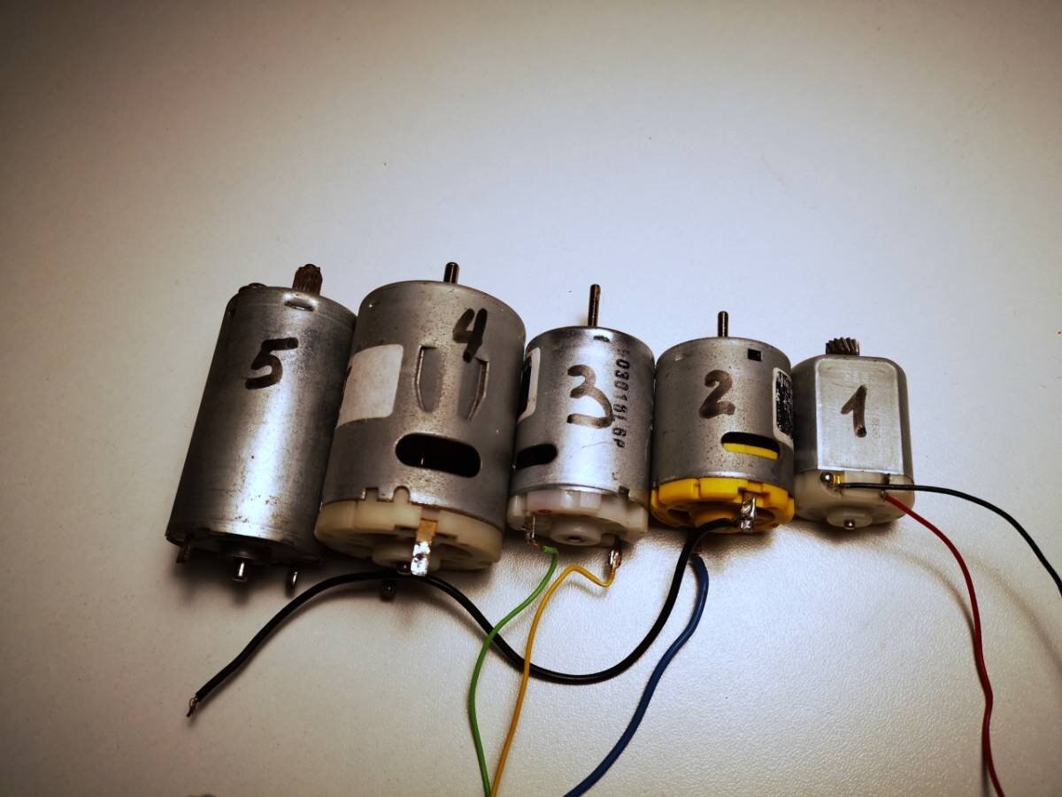

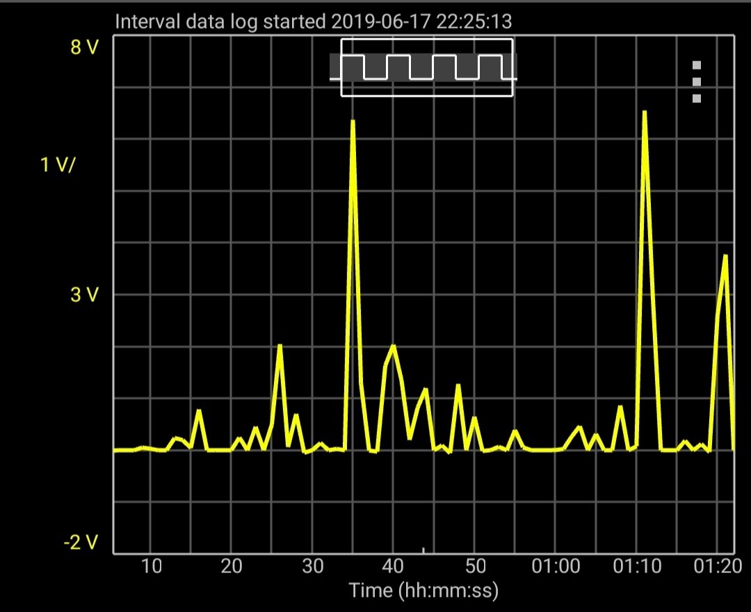

Below: the five DC motors I used to test their ability to generate DC power; the best resulted to be number 1
To test the motor giving the better result I have recorded some samples of the voltage reached while rotating the shaft of every motor.
Above: the voltage detection graph of motor #1 selected for the project

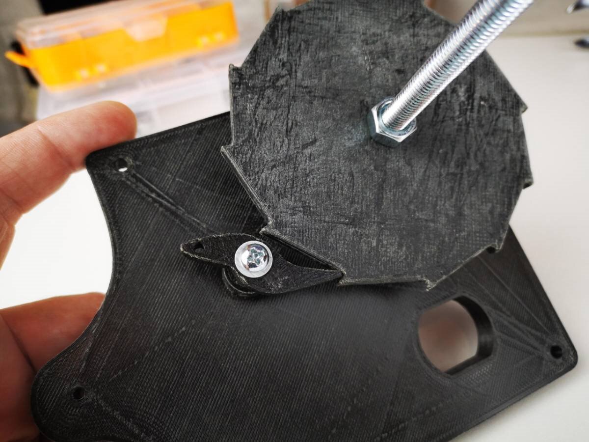

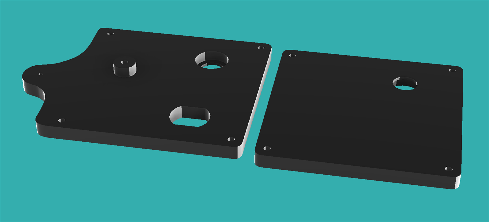

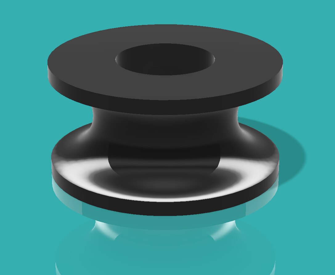

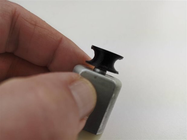

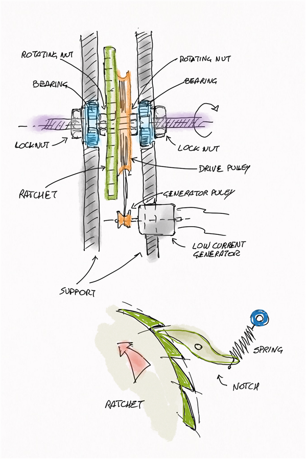

After selecting the right DC motor I designed and 3D printed a pulley, shown in the images below.

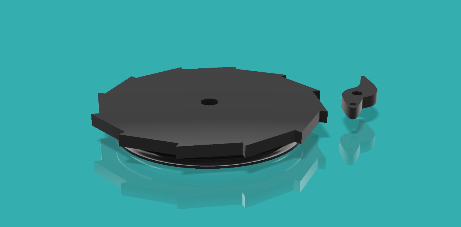

Around the motor shape, I designed and 3D printed the ratchet as in the schematic design shown below
The image gallery below shows the rendering of all the parts, designed with Fusion360

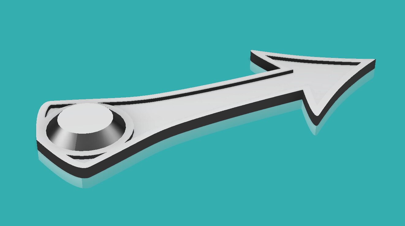

The charge level arrow

The speaker cone to further amplify the mp3 player output. The rectangle hole is for a square smartphone speaker

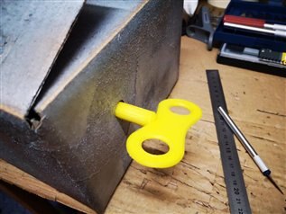

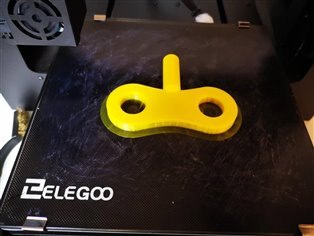

The spring-charger key
The generator (DC motor) transmission pulley

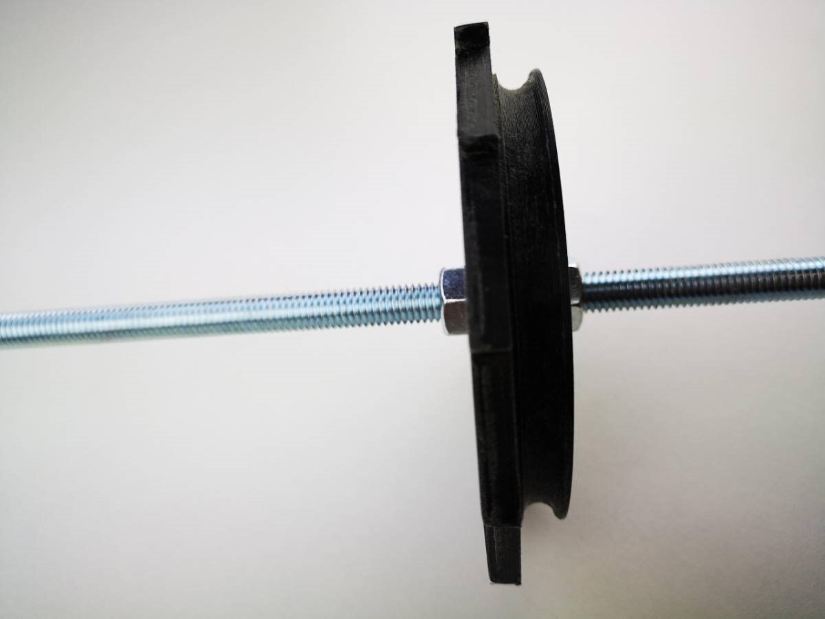

The ratchet with the pulley shape on the bottom side and the notch to simulate the sound effect of the spring-charger
The two sides of the ratchet

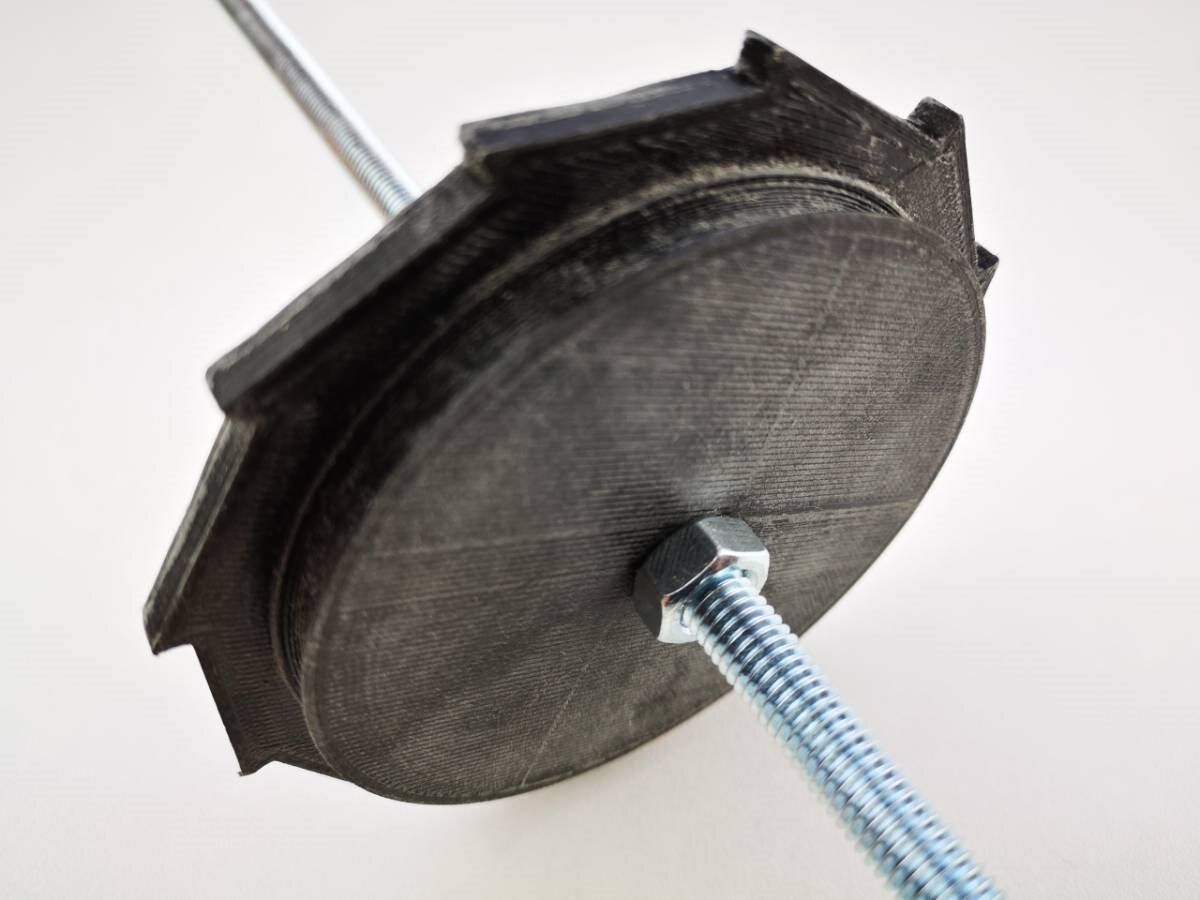

The image gallery below shows the finished parts and the assembly sequence, accordingly with the design above. This spring-load simulator and low-power generator is the most complex mechanical part of the entire project.
{gallery} The Ratchet Parts and Assembling

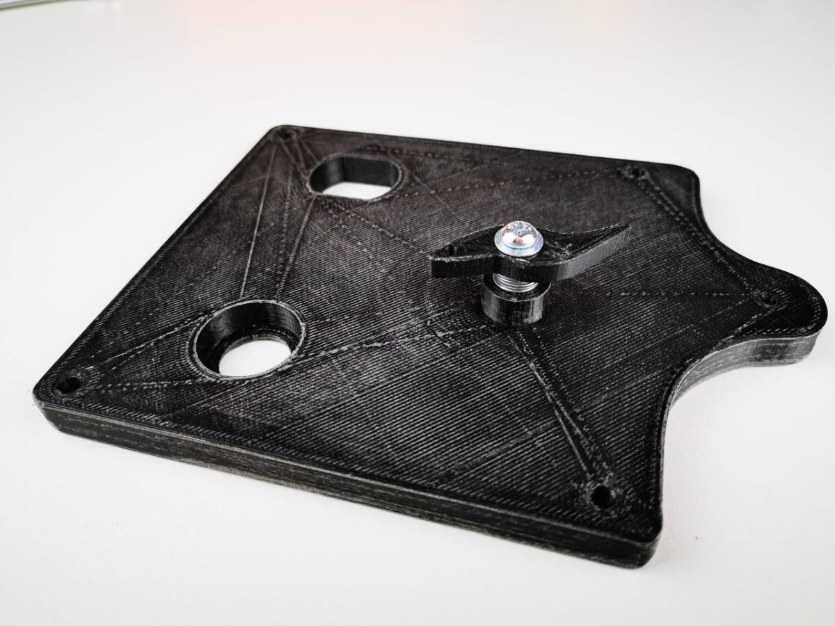

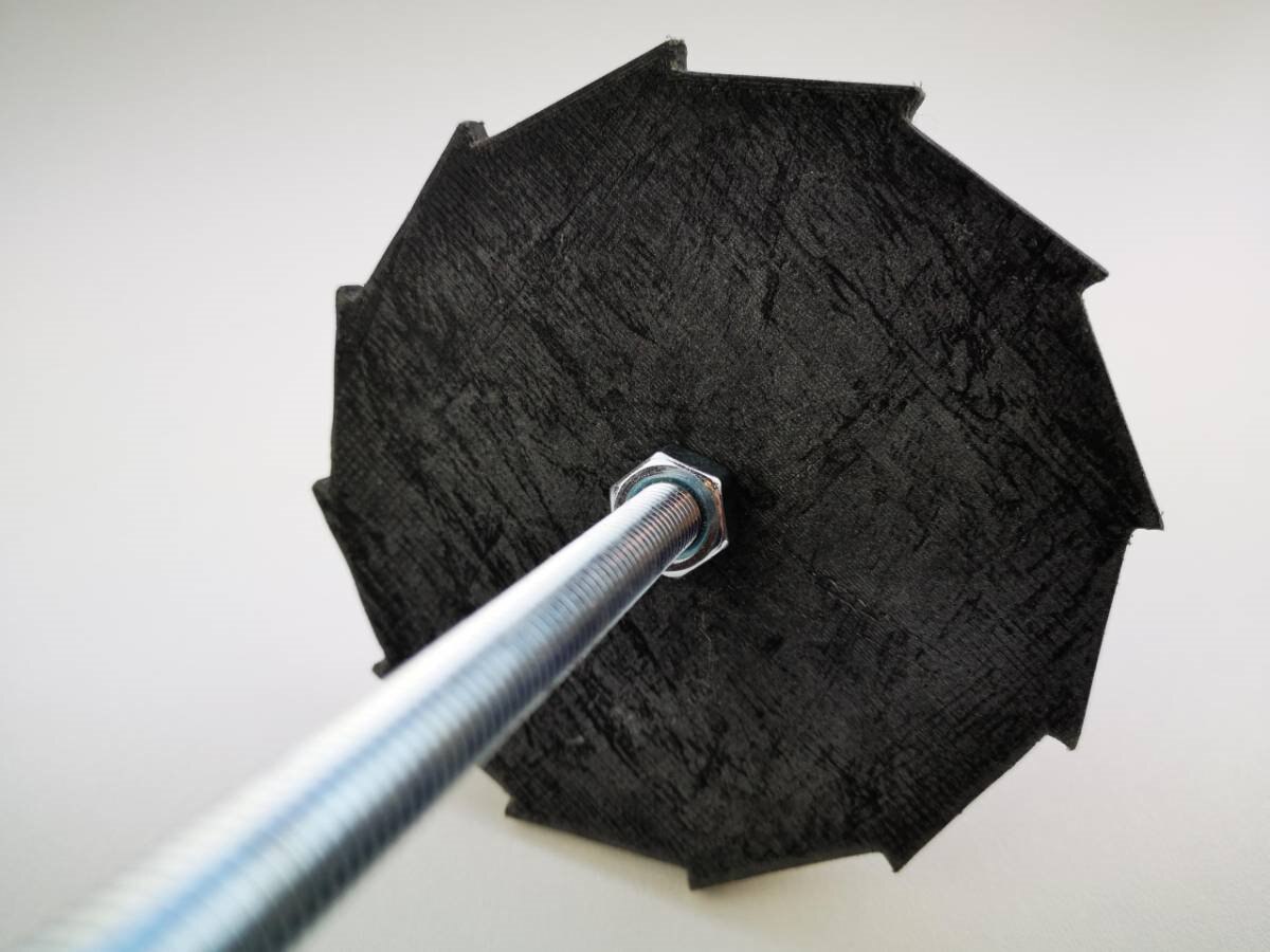

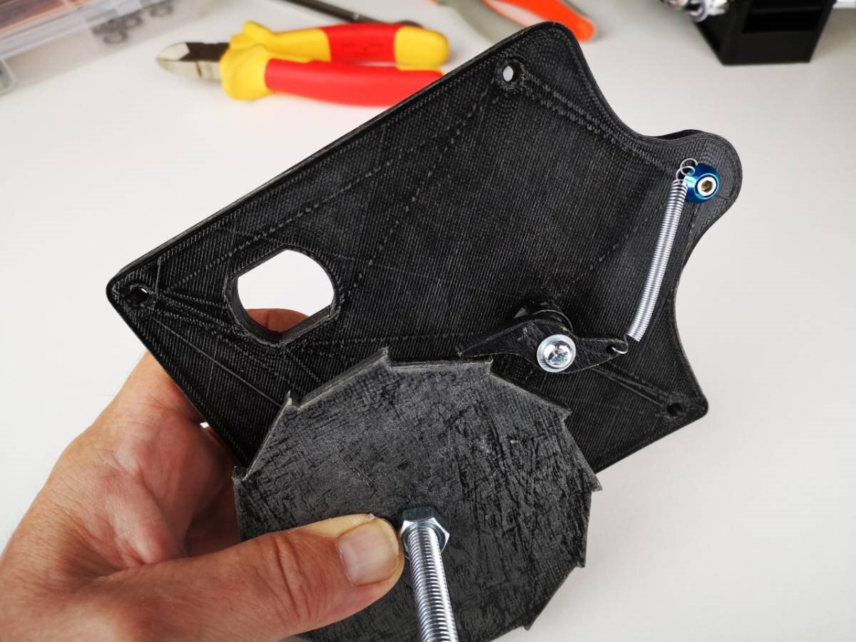

The ratchet 3D printed with the pulley side to rotate the DC power generator locked on the M4 threaded bar

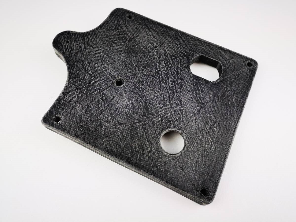

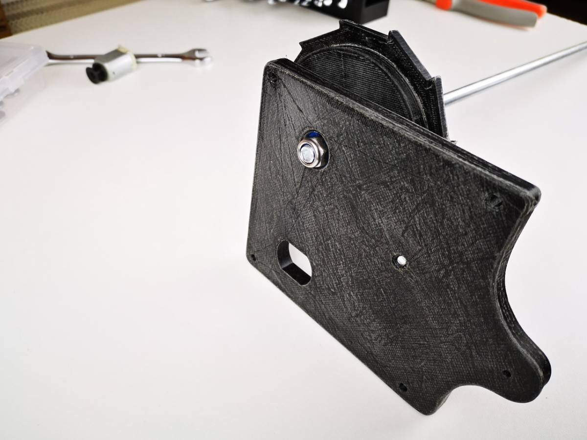

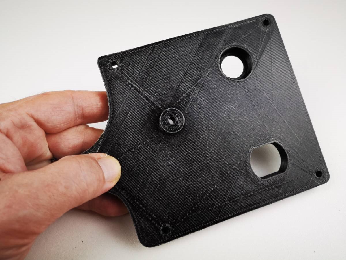

The motor wall, internal view
The motor wall, external view

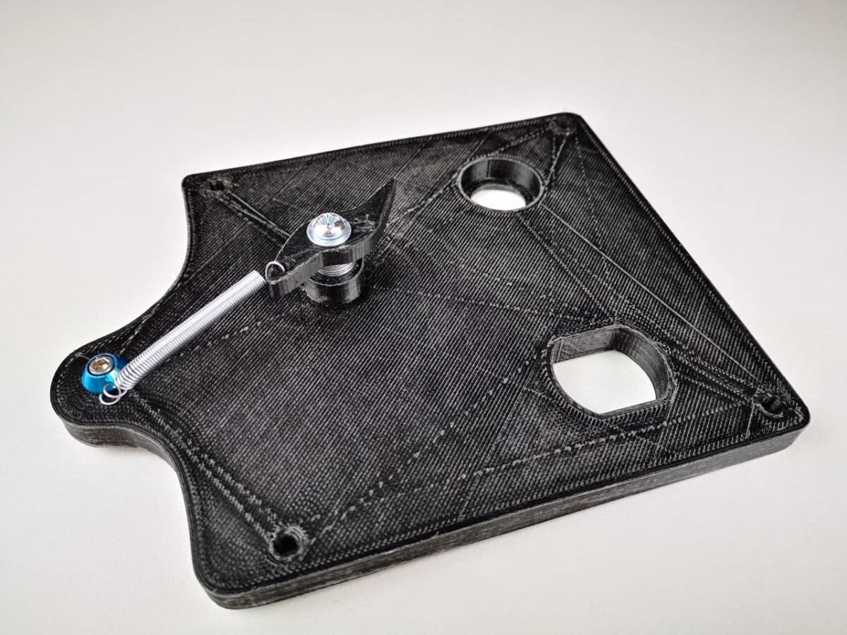

The motor-side wall with the notch to test the right distances
Notch leveling, detail
The motor side-wall with the ratchet fixed to the bearing
Testing the right positioning and leveling of the ratchet and notch

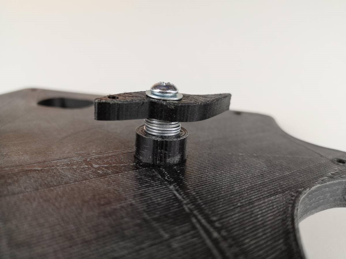

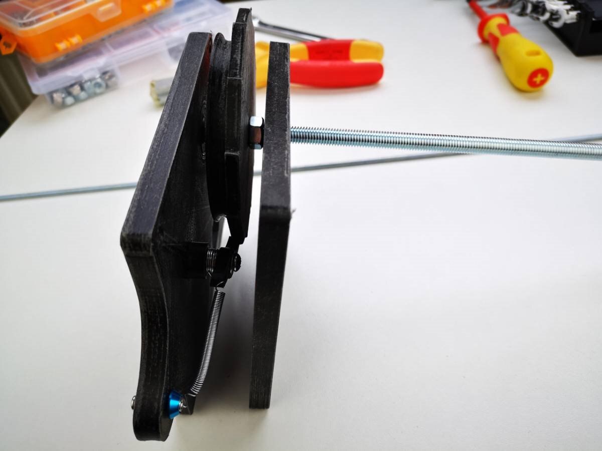

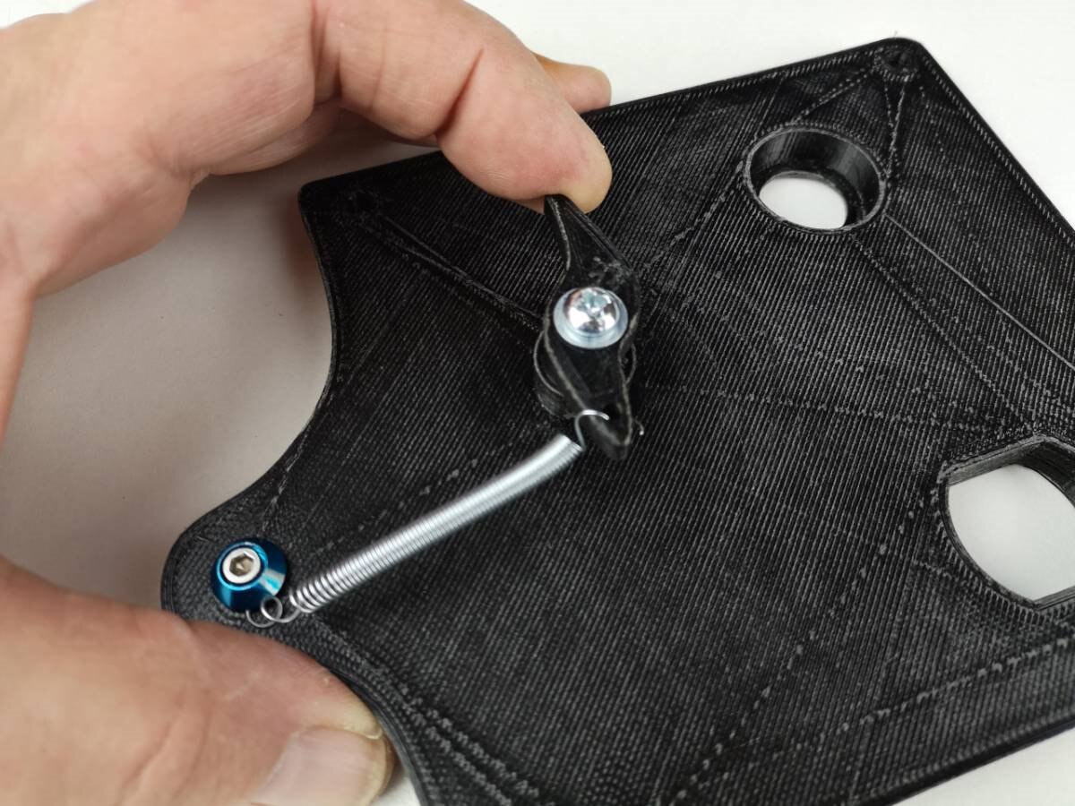

The notch and tension spring in place. The right eight respect the ratchet is obtained with a series of washers
Testing the notch assembly with the tension spring

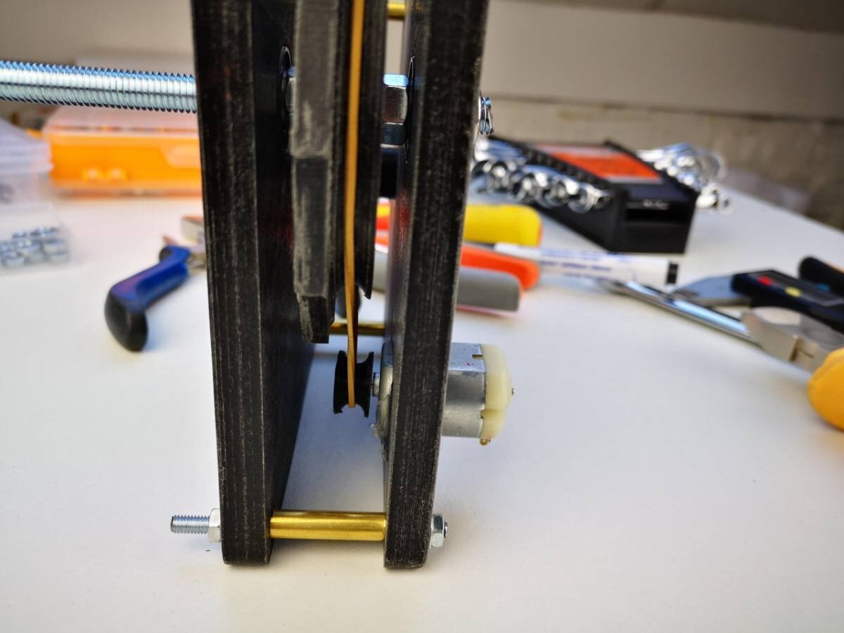

The internal setting of the ratchet and notch with the tension spring. The role of this design is to recreate the physical effect and sound of the real spring-loaded chargers

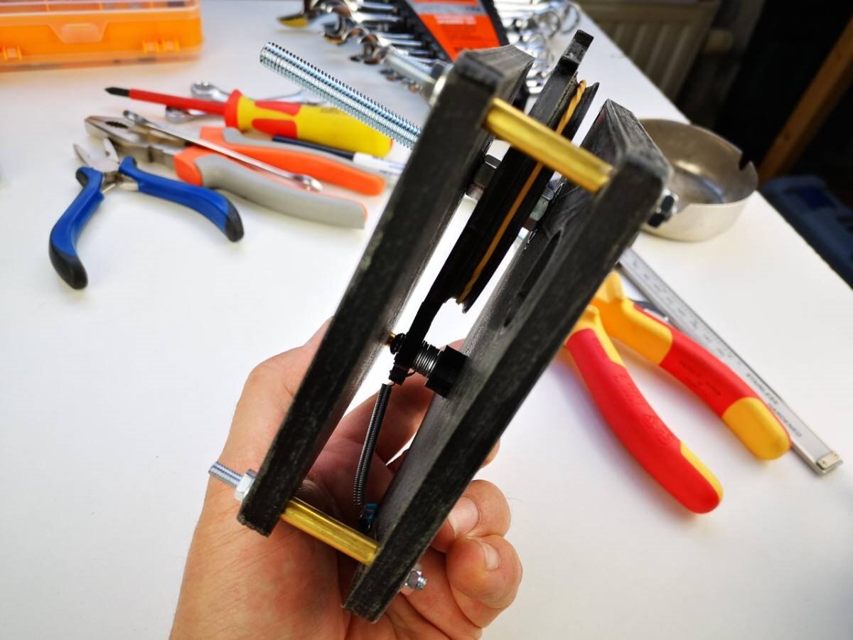

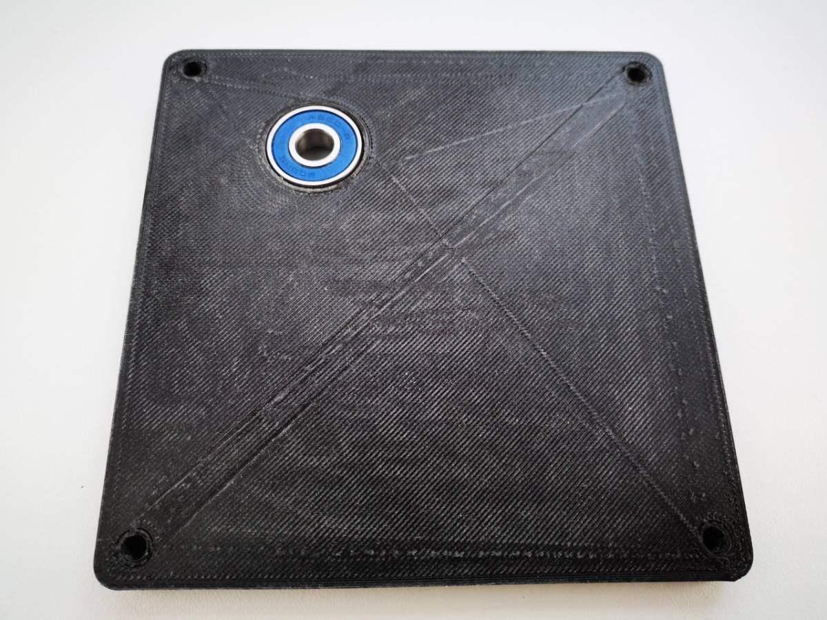

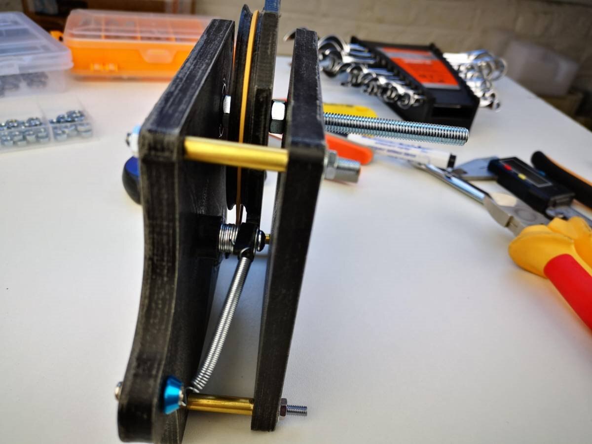

The right side of the ratchet shell. Note that to reduce the number of nuts both bearings are faced to the external side si that only one M4 nut by side will keep them in place and lock the rotating structure

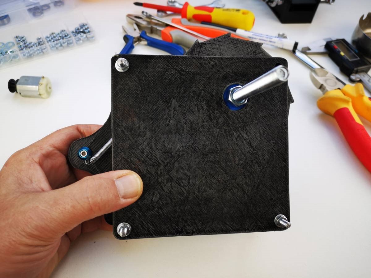

Per-assembled view of the ratchet to measure the right distance for the brass separator pipes
The charging side of the ratched with one of the two lock-nuts to keep the bearing firmly in place
The two sides are kept together at the right distance with four M2 Allen screws and nuts with a brass pipe separator in the middle
The finished part, motor/generator view
The finished part, notch spring view
As shown in the image gallery above the ratchet is assembled with an M4 threaded shaft; the longer part is outside the musical box hosting the 3D printed big charging key screwed on it as shown in the images below.
After this part has been finished, I have made a short test program to read the generated power every half rotation of the key through one of the three analog ports of the BBC micro:bit mounted on a Kitronik Robotic Board to find the right reading value in order to avoid undesired effects if the key is not rotated correctly as should happen in the original mechanism. The images below show the counter detection of two of "key charging" events and the relative measured voltage.

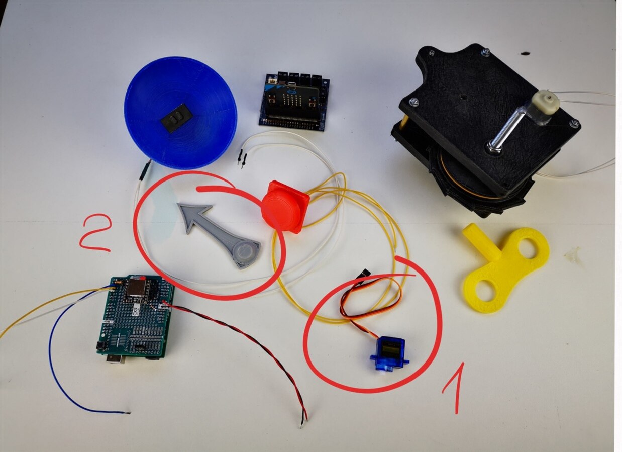

The charge level indicator should be a gauge showing when the musical box is full-charged and will decrease as a track is played. This feature can be easily reached with a few lines of code using the features of the Kitronik board that can easily control up to eight servos.
Above: the charge level servo [1] and the 3D printed and metal-painted gauge [2]

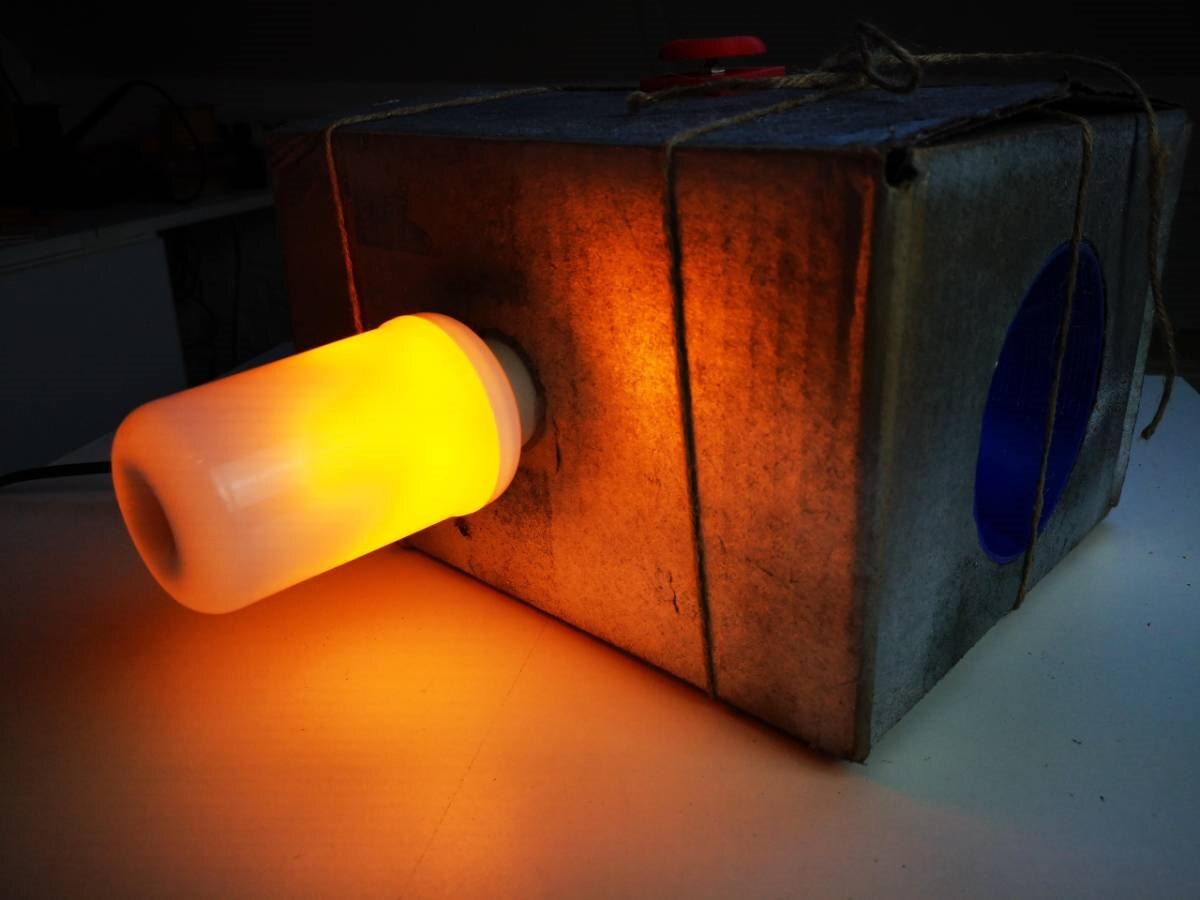

The Fire Lighting Effect
When I saw a banner somewhere on a site advertising this low-power LED light resembling a very realistic flame burning effect I loved it a lot and bought a couple of them, just in case. And this was the case to add a nice effect to the box. The problem is that these are common lamps working at 220V AC. Thanks to the Kitronik robotic board, I have used one of the motor output to control a 5V Finder relay to drive the lamp. All the features of the project have been controlled by software with the micro:bit.

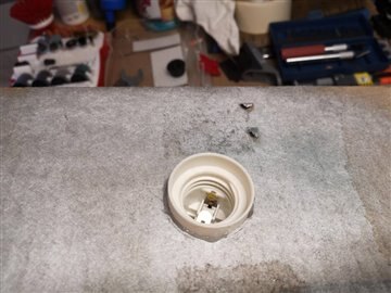

The last two parts added directly to the box has been the lamp holder and a top button, simulating the musical box button to release the spring and start the music.

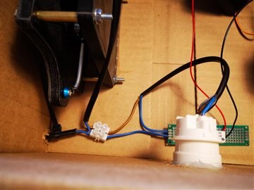

The Lamp Holder and the Relais
Below: the lamp holder hot glued to one of the box sides
One of the 220V AC wires of the lamp holder (blue wire on the right image) is soldered on the small prototype PCB hosting the Finder relais. the right and black wires from the relais PCB control the relais through the Kitronk robotic board.

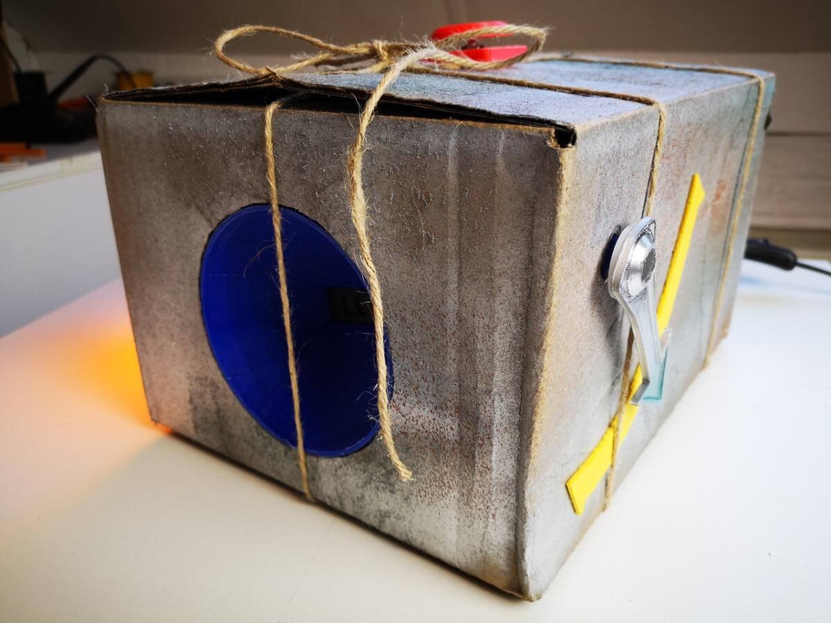

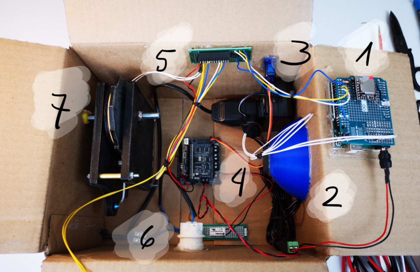

It was possible to include all the components as well as the power supply in the musical box container.
  1. The Arduino based mp3 player controlled by the BBC micro:bit
  2. The speaker 3D printed cone glued to the side of the box
  3. The servo controlling the charge level gauge
  4. The BBC micro:bit plugged on the Kitronik robotic board
  5. The signals collector board with the connectors
  6. The lamp holder and the relais board
  7. The ratchet component

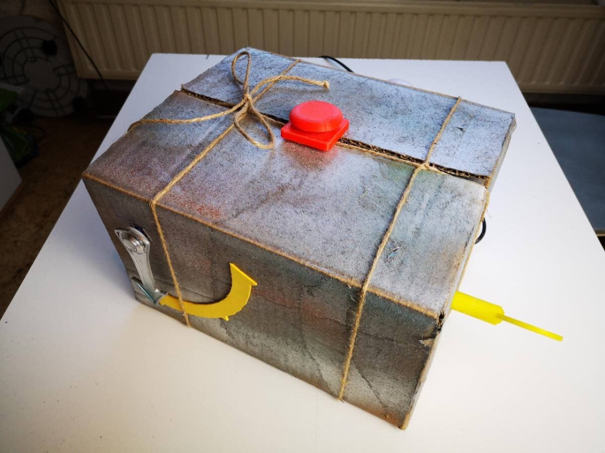

Below: view of the assembled musical box ready for testing

    pins.digitalWritePin(DigitalPin.P11, 1)
    basic.pause(500)
    // Set the Arduino player control pin to (off)
    pins.digitalWritePin(DigitalPin.P11, 0)
// Update the arrow servo status accoringly with the
// charge level and eventually disable the music
// playing if the charge level is 0
function updateCharger () {
    basic.showString("" + chargeLevel)
    Kitronik_Robotics_Board.servoWrite(Kitronik_Robotics_Board.Servos.Servo1, arrowPosition)
    // If the light is on, power on the realay, else power
    // if off
    if (chargeLevel == 0) {
        Kitronik_Robotics_Board.motorOn(Kitronik_Robotics_Board.Motors.Motor1, Kitronik_Robotics_Board.MotorDirection.Forward, 0)
        // As the carillon is full charged, set the playing
        // flag
        isPlaying = false
    } else {
        playNewSong()
let analogIn = 0
let isChargingCount = 0
let isPlaying = false
let lightStatus = false
let stepDeg = 0
let chargeLevel = 0
let countCharger = 0
let arrowPosition = 0
// Disable all the output of the Kitronik Robotic
// Board
Kitronik_Robotics_Board.allOff()
Kitronik_Robotics_Board.servoWrite(Kitronik_Robotics_Board.Servos.Servo1, 0)
// Initialze the motor 1 (light relay control) as off
// Arduino Player control pin off status
let playerOff = 1
// Arduino Player control pin on status
let playerOn = 0
// Current position in DEG of the servo controller
// arrow.
arrowPosition = 0
// Number of charger reads to have a valid charging
// count
countCharger = 5
// Current level of charge. Start from zero up to
// maxChargeLevel
chargeLevel = 0
// Max number of charge level. Every level of charge
// plays a song
let maxChargeLevel = 6
// The servo rotation steps in DEG every charge
// setting
stepDeg = 15
// The light status controlled by the relais on motor1
// powered when the music is playing
lightStatus = false
isPlaying = false
basic.forever(function () {
    // Only if it is not playing the chager can be used
    if (isPlaying == false) {
        readCharger()
        // Check if the carillon is full charged and start
        // playing
        if (chargeLevel == maxChargeLevel) {
            // Change the lilght status controlled by the
            // background process
            lightStatus = true
        } else {
            lightStatus = false
        updateControls()
