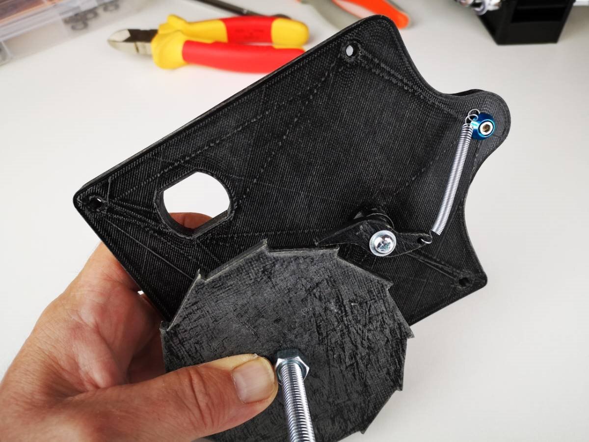

The Ratchet
Designing and making the ratchet has been the most challenging part of the project design;  The idea was to recreate an oversized ratchet, like those used in the spring-loaded real musical boxes (aka Carillon, from which the name of the project) but also recreating the real behavior. So, how to send to the micro:bit information on the status of the charge done manually with a spring-loaded manual charger emulator? Just using an electric generator! I have tested a series of DC motors until I found one that also when rotating the shaft at low speed was able to generate about 0.5 V.
Below: the five DC motors I used to test their ability to generate DC power; the best resulted to be number 1
To test the motor giving the better result I have recorded some samples of the voltage reached while rotating the shaft of every motor.
Above: the voltage detection graph of motor #1 selected for the project
After selecting the right DC motor I designed and 3D printed a pulley, shown in the images below.
Around the motor shape, I designed and 3D printed the ratchet as in the schematic design shown below

The image gallery below shows the finished parts and the assembly sequence, accordingly with the design above. This spring-load simulator and low-power generator is the most complex mechanical part of the entire project.
{gallery} The Ratchet Parts and Assembling
The ratchet 3D printed with the pulley side to rotate the DC power generator locked on the M4 threaded bar
The motor wall, internal view
The motor wall, external view
The motor-side wall with the notch to test the right distances
Notch leveling, detail
The motor side-wall with the ratchet fixed to the bearing
Testing the right positioning and leveling of the ratchet and notch
The notch and tension spring in place. The right eight respect the ratchet is obtained with a series of washers
Testing the notch assembly with the tension spring
The internal setting of the ratchet and notch with the tension spring. The role of this design is to recreate the physical effect and sound of the real spring-loaded chargers
The right side of the ratchet shell. Note that to reduce the number of nuts both bearings are faced to the external side si that only one M4 nut by side will keep them in place and lock the rotating structure
Per-assembled view of the ratchet to measure the right distance for the brass separator pipes
The charging side of the ratched with one of the two lock-nuts to keep the bearing firmly in place
The two sides are kept together at the right distance with four M2 Allen screws and nuts with a brass pipe separator in the middle
The finished part, motor/generator view
The finished part, notch spring view
As shown in the image gallery above the ratchet is assembled with an M4 threaded shaft; the longer part is outside the musical box hosting the 3D printed big charging key screwed on it as shown in the images below.
