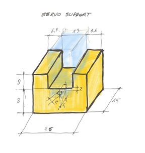

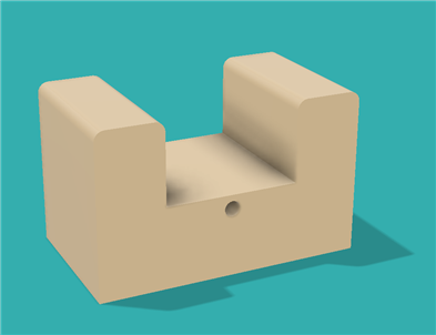

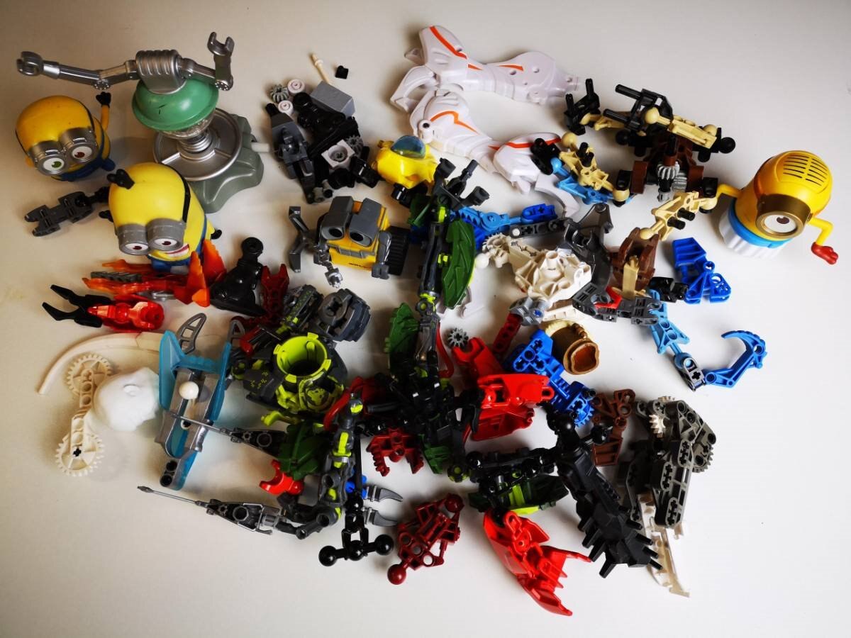

A simple 3D printed block elevates the micro servo to execute the entire movement cycle at the necessary height, accordingly with the pieces I used for the arm. In fact, one of the characteristics of the Malem Robotica Useless Box is... using pieces of robot toys. Koen provided me a bunch of parts I used to create six similar arms. The image below shows only a part of the selection of pieces I had available.

I avoid boring to show every detail of the assembly process with images as it is better to look at the making-of in the video below. Instead, point the attention on a last-minute problem I had to solve for sure. It was Friday night, less than 24 hrs from the workshop. The use of a micro servo allowed me to have the electronics working – including the two LEDs – powered by the Arduino 5V pin, and using 6 AA 1,5V battery pack; unfortunately, the servo arms were too weak to operate the switch. The lucky solution I found, in my opinion, added a touch of originality to the building; using six different shaped parts of the toys every switch has been customized with a small lever to reduce the force needed by the micro servo to change its position.
