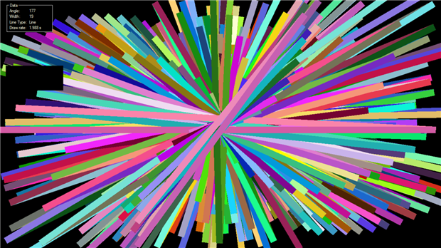

My project is an electronic Art App controlled by Arduino Uno.

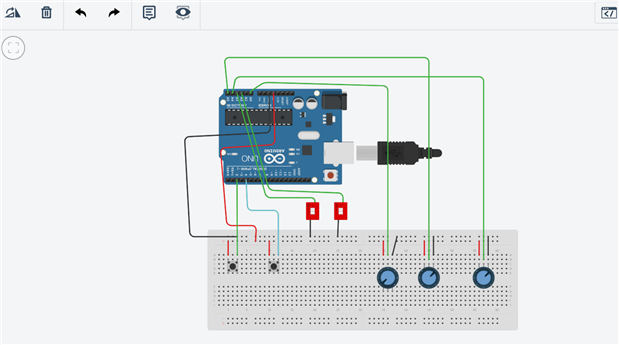

The app connects to Arduino port. goes full screen, and starts drawing abstract geometrical figures based on parameters it reads from the Arduino. The user can can control what the app is drawing using potentiometers, switches, and a push button. Everything can be controlled by Arduino, there is no need for keyboard and mouse (after connecting to Arduino port). App can be used for meditation, or just to relax. Drawings can be saved in real time using push button.
Push button 1 – clears app screen
Push button 2 - save the screenshot of the drawing
Switch 1 – Start/Stops drawing
Switch 2 – controls line type. Line type can be an Arc (Bezier curve) or a straight line
Potentiometer 1 – controls line width
Potentiometer 2 – controls an angle for a drawing
Potentiomenter 3 - controls drawing speed

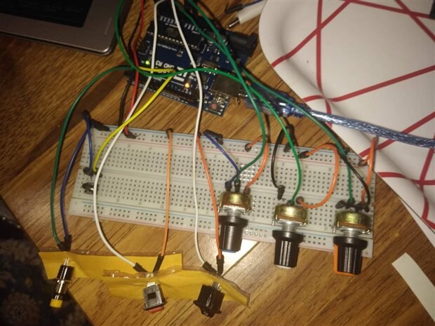

Fun fact: When testing the board I ran into a problem that all analogRead() functions returned incorrect values. I could not figure out why, it was driving me crazy. I was sure that I fried both of my Arduinos somehow. But finally I figured out that connections on my $1 breadboard were not wired properly. I changed the breadboard and everything started working right away.
Schematics (updated):

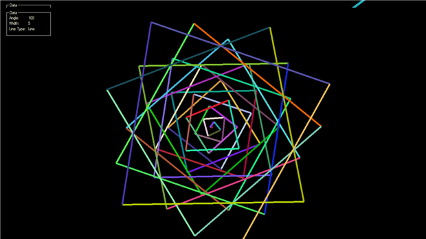

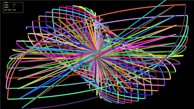

Couple of screenshots:
and
and
This is how the board looks like:
