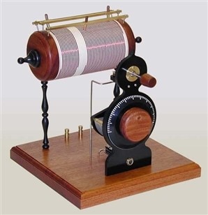

Electromagnetic waves can come from satellite stations, wireless internet, radio stations, and digital broadcasts. An RF harvesting system captures and converts electromagnetic energy into usable continuous voltage using an antenna and a rectifier circuit as its fundamental building blocks. imageThe theme the month is Energy Harvesting , and when the subject of harvesting energy from RF frequencies was mentioned in the theme doc, Project14 | Energy Harvesting: Build Projects that Scavenge Energy from Wasted Energy Sources! , the crystal radio was listed as one of the earliest examples.  Like many of you, I have nostalgia for the old radio.  I still look back fondly to listening to baseball games on the old AM dial.  My radio happened to also double as an alarm clock, it displayed the time in red LED, and plugged into the wall.  The thing I remember most about it was listening to Jack Buck and Mike Shannon call St. Louis Cardinals games on KMOX. With a good radio, KMOX's nighttime signal can be heard in most of the Central United States and into Mexico and Canada.  I've heard baseball games during station wagon car rides when on family trips, in the country side close to Western Pennsylvania (don't remember where exactly but it was a long way from the Midwest), when I was growing up. There could be a lot of static depending on where you were or what the weather was like outside. As it turns out,  that static was simply the radio picking up naturally occurring energy on the RF spectrum. All these invisible radio waves traveling such vast difference. When I found out that anyone can actually create your own crystal radio, one that does not need to be plugged in the wall, so you could presumably listen to Cardinal games without a battery or a power cord, this fascinated me all the more.  I dug up some interesting information about these things when I was preparing this months theme and because its a subject I find interesting I thought I'd share with the rest of the community. image

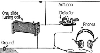

This information is borrowed from the excellent article I found here.  To build a crystal radio you need essentially four parts. You need wire (such as magnet wire) to catch the radio waves and allow you to tune the radio. You'll need a crystal/diode.  If you want to be totally authentic and use a real crystal you have to be very specific about the type of crystal that you are allowed to use.  Galena, a crystal form of lead is a popular option.  If a crystal radio uses a real crystal it is called a "cat whisker set" due to the way the wires dangle over the crystal.  Using a real crystal can be frustrating because you'll constantly need to hand tune them while listening or you'll lose your signal. You can avoid the headache and use a modern diode such as type 1N34A.   A modern diode is essentially cat-whiskers with a fixed and unmovable design.  Next, you'll need a high impedance or a ceramic earphone. Modern earphones require power so the one's you have lying around won't work.  You'll need an extremely sensitive earphone that will react to tiny vibrations in your circuit.  If you're going to do anything other than a basic crystal radio you'll need to use a resistor (if your antenna is longer).  To build your crystal radio you'll need to make the coil and turn the coil into a radio.   If this peaks your interest then check out the steampunk article here!
