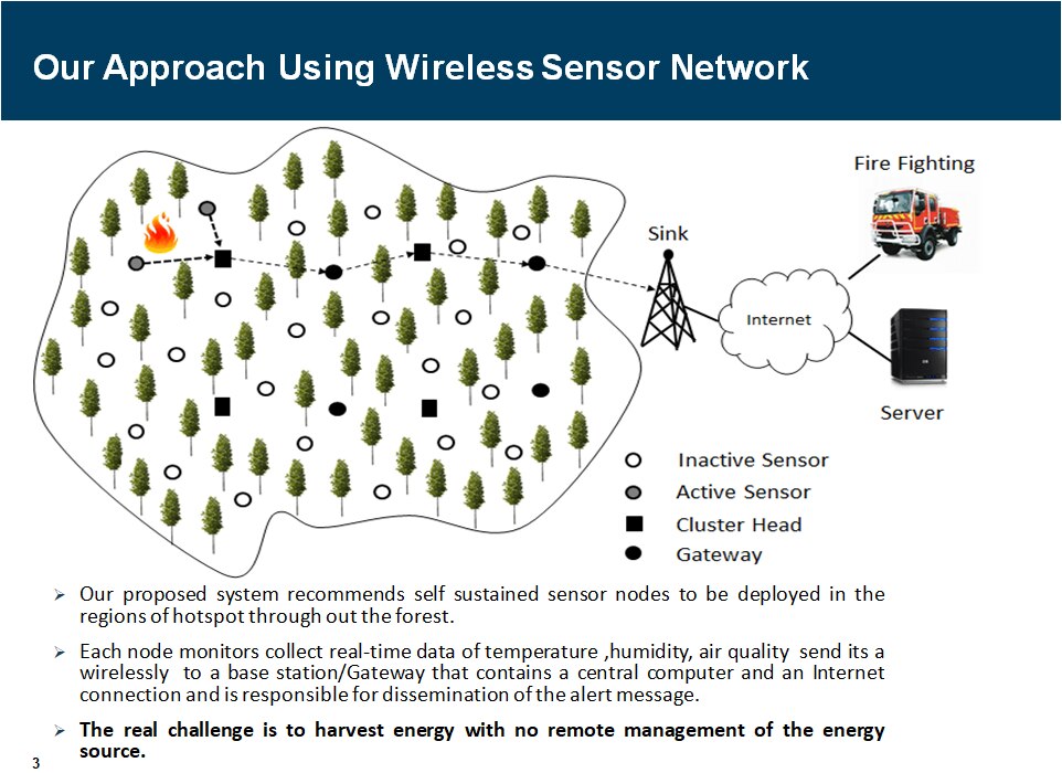

    This is a very interesting project. I couldn't work out what powers the cluster heads and gateways though. Do they not need to be power continually to be able to receive from the sensors and forward the…

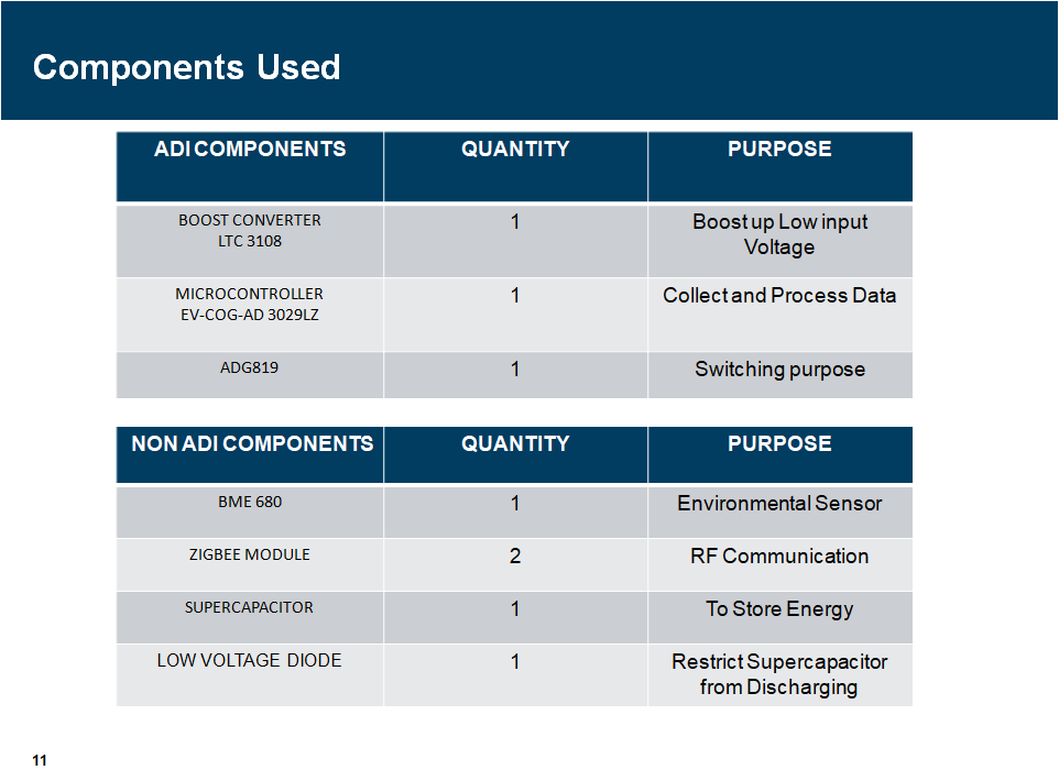

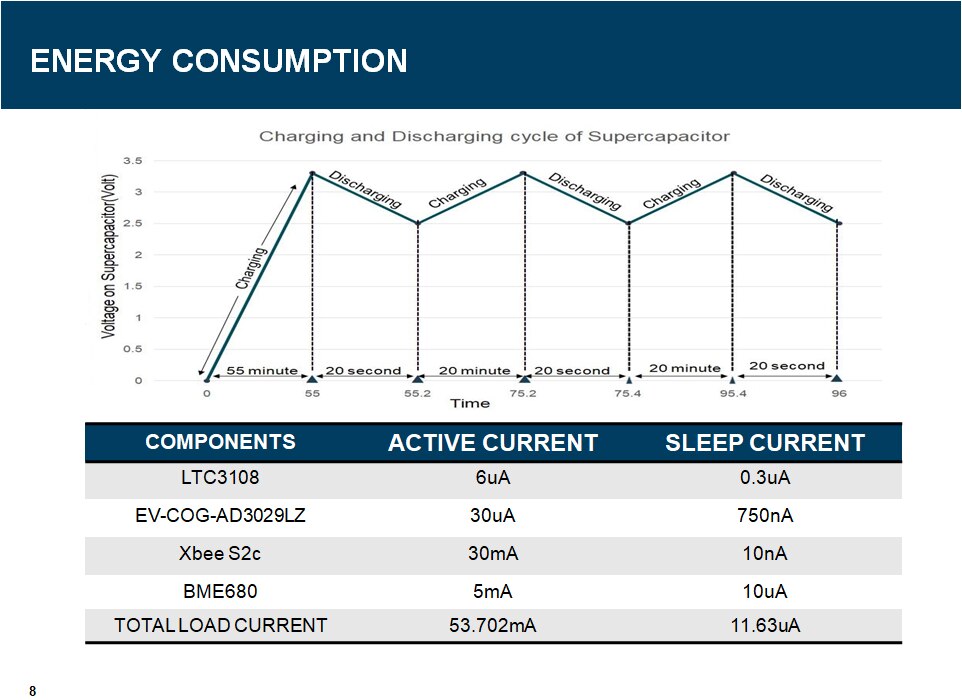

    Sir here we are using a recovery diode PMEG4002 in between the voltage booster and super capacitor .

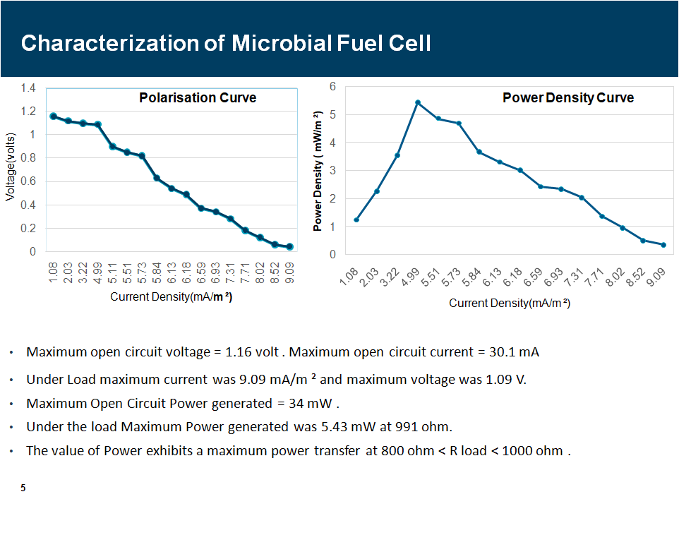

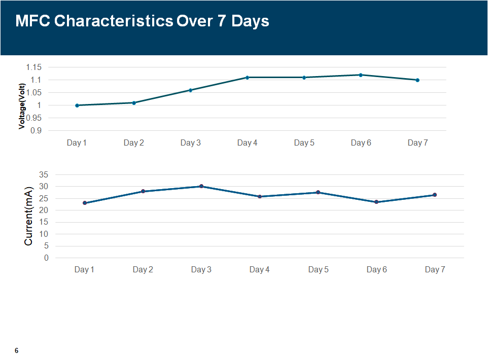

    pratyush_cetb Though, there are some points like, if maximum voltage of MFC which 1.16 volts( from chart, which I assume are logged from this MFC project readings) than how come did you managed to charge super capacitor and that too with low current. Also, Creating MFC video is not clear on how you did it. And somehow everything worked as you've shown in video.
    A bit confusing for me.
    -Mudz

    We have designed the power management scheme as the microbial fuel cell will charge the supercapacitors in every 20 minutes and then wake up sensor node sense the data for 50 seconds and start charging again. And this cycle goes on.
