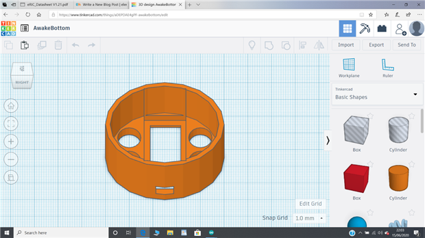

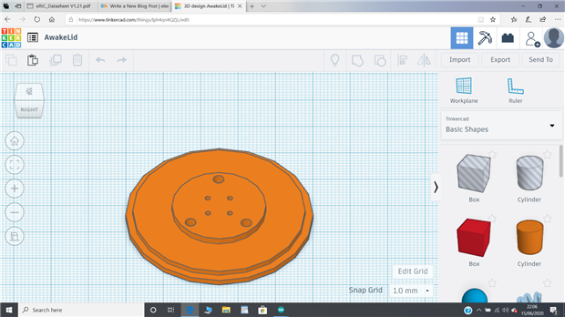

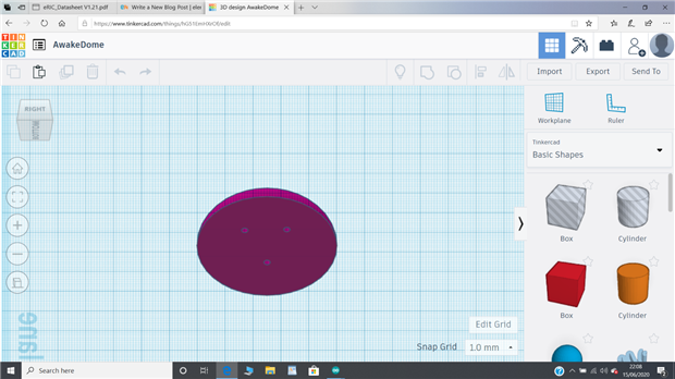

I decided that I wanted a big button that I could easily find in the dark to start the timing interval. As I didn't have one I designed one using TinkerCAD and printed it with my 3D printer. It consists of three parts, the base holder which will contain the Nano, a lid to hold the switch, and a spring mounted dome to activate the switch. I couldn't find any suitable springs to I decided to use the spring effect in the small push button switch I had to create that effect instead. I was only using one small push button so needed three balancing screws to hold the dome part level at exactly the correct height above the button switch. The movement of the push button is less than 1 mm so the spacing and levelling is very important.
This is the base part with a slot at the bottom that is exactly the same size as a Nano and which will hold it securely with an interference fit. There is a hold in the side for the USB cable. The holes in the bottom were originally just to save filament but in the end I had to use them to put wires to external components. I originally wanted to get all the components inside this base but I made it too small so had to run external wires to some components.
Below is the lid which is an interference fit onto the top of the base and just contains a fitting for the switch and three holes for the levelling screws.
The third part is the dome that rests on top of the button and is levelled by the three screws. You cannot see very clearly but the dome has three pillars inside that the levelling screws fit into.

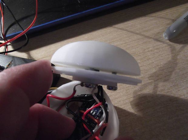

I was very pleased with the operation of this dome - button combination as I am not a mechanical engineer as it seems to do the job required quite well.

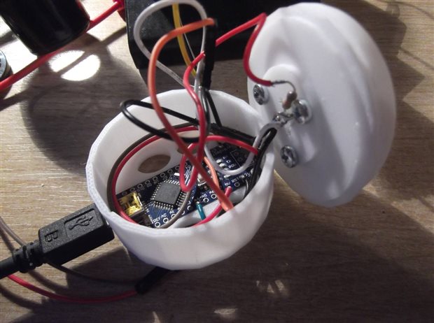

The base showing the Nano installed and the wiring is shown below. I had planned to avoid messy wires and fit them all inside the base, but I didn't make the base large enough so that didn't happen. Ah well, maybe next time.
The dome showing the button and three levelling screws is shown below. It is not that clear but you can just about see everything important.

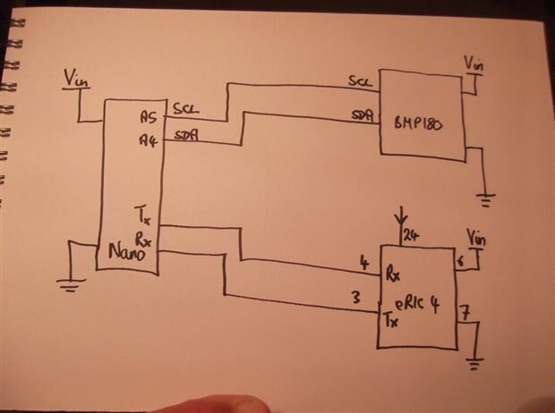

In order to be able to measure the temperature a separate circuit is required that will be placed outside, well away from the alarm part. The circuit for this is shown below and consists of the Nano, a BMP180 pressure and temperature sensor and an eRIC 4 radio transceiver module (http://www.lprs.co.uk/assets/files/eRIC_Datasheet%20V1.21.pdf ). I didn't have time to 3D print a case for this module.
I originally wanted to use both the temperature and the pressure measurements to alter the additional time period as low pressures typically mean it is raining or generally not very nice, but time ran out before I was able to incorporate that measurement. It would have been good to also measure light levels and rain but I didn't have a sensor for those parameters. Obviously I could have made a connection to the internet and scrapped all these values from web pages but I wanted to use the eRIC 4 radio transceivers as well as the BMP180 sensor module because I had them both.

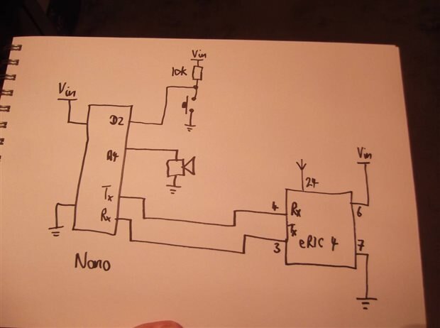

The circuit diagram for the timer/alarm unit which is fitted into the round button 3D printed part is shown below. This consists of just a Nano, a simple push-to-make switch to start the timing, a small sounder and the other eRIC 4 radio transceiver.
