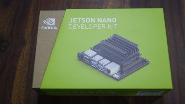

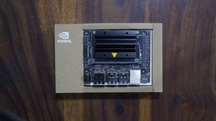

Step 1: Getting Started with NVIDIA Jetson Nano
NVIDIARegistered Jetson NanoTm Developer Kit is a small, powerful computer that lets you run multiple neural networks in parallel for applications like image classification, object detection, segmentation, and speech processing. All in an easy-to-use platform that runs in as little as 5 watts.
NVIDIA Jetson Nano
image image
Specification- Developer Kit I/Os
  • USB
  • 4x USB 3.0, USB 2.0 Micro-B
  • Camera Connector
  • 1x MIPI CSI-2 DPHY lanes
  • Connectivity
  • Gigabit Ethernet, M.2 Key E
  • Storage
  • microSD (not included)
  • Display
  • HDMI 2.0 and eDP 1.4
  • Others
  • GPIO, I2C, I2S, SPI, UART
You’ll also need:
  • microSD Memory Card (32GB UHS-I minimum)
  • 5V 4A Power Supply with 2.1mm DC barrel connector
  • 2-pin Jumper
  • USB cable (Micro-B to Type-A)
  • USB camera / Pi camera
For a limited time only, bring the Jetson Nano Developer kit home for just $89.To learn more about the Jetson Nano, do watch the webinar from hackster.io and I recommend to check this amazing tutorial from NVIDIA.

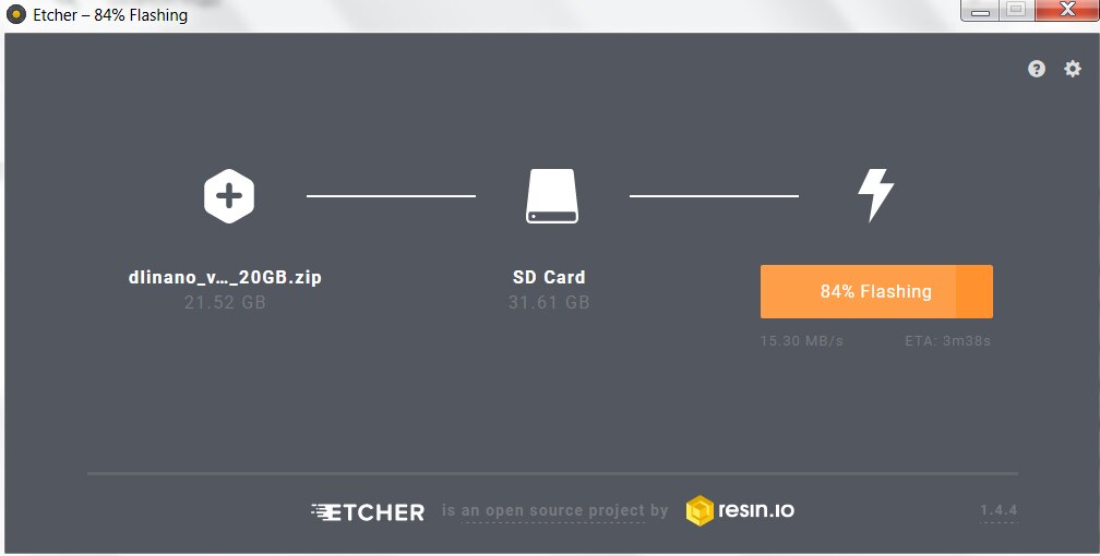

Step 2: Burn NVIDIA Image to the SD card
We will need at least a minimum of 32GB SD cards for the Jetson Nano. Download the image from NVIDIA DLI AI Jetson Nano SD Card Image v1.1.1
  • Format your microSD card using SD Memory Card Formatter from the SD Association and disconnect once done
  • Download Etcher and installs it.
  • Connect an SD card reader with the SD card inside.
  • Open Etcher and select from your hard drive the Jetson Nano Developer Kit SD Card Image.imgor.zipfile you wish to write to the SD card.
  • Select the SD card you wish to write your image to.
  • Review your selections and click 'Flash!' to begin writing data to the SD card

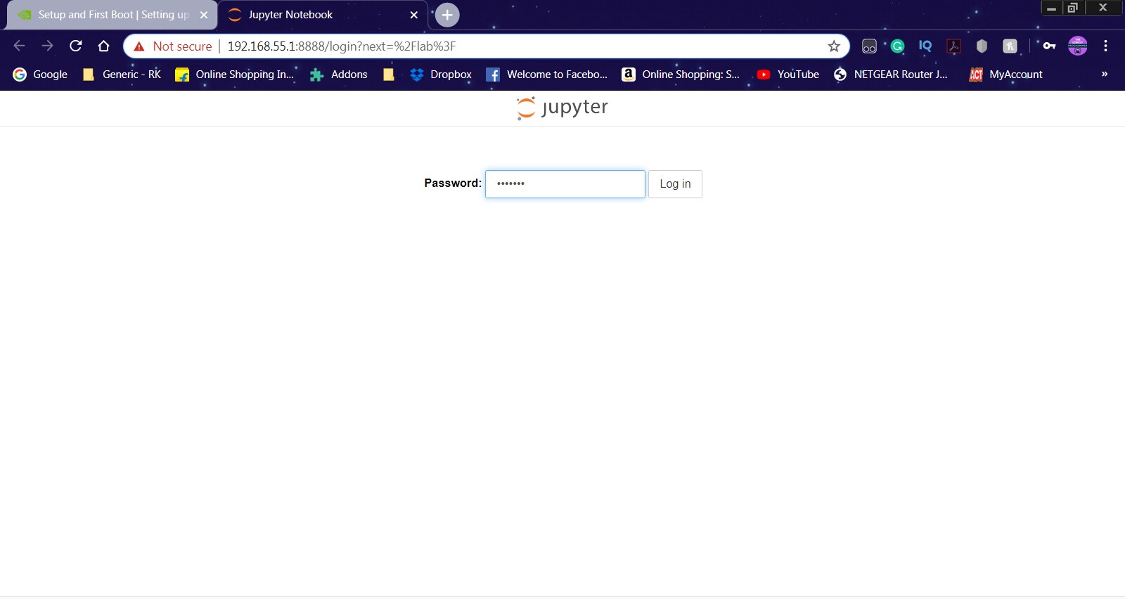

Step 3: Logging Into The JupyterLab Server
  • Open the following link address :192.168.55.1:8888 . The JupyterLab server running on the Jetson Nano will open up with a login prompt the first time.
  • Enter the password:dlinanoand click the Login button.
Now we have logged in to the JupyterLab Server.

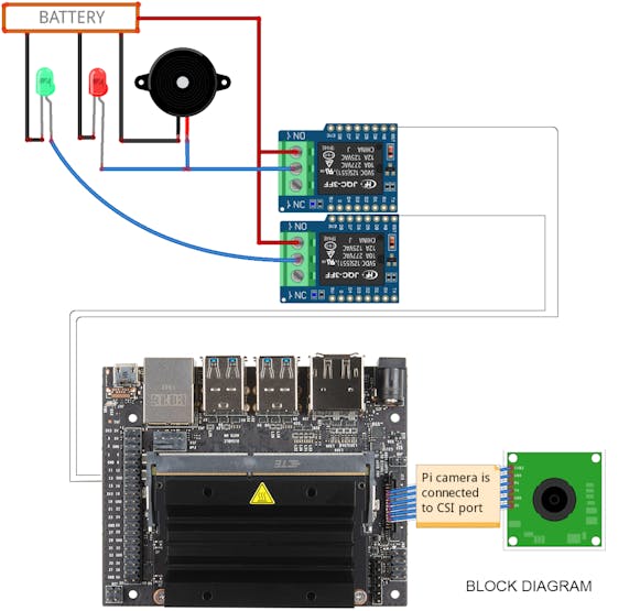

Step 4: Block Diagram & Components
The Block Diagram of this circuit is given below.
Block Diagram
Block Diagram
To make these connections, I've used separate connectors for power, and relay output.
PI-CAMERA
The Pi-camera is connected to the CSI port of the Jetson Nano.
Pi Camera Module V2 Pi-cam to Jetson Nano
RELAY BOARD
We connect the Buzzer and an Emergency light using a relay circuit to the GPIO pins 18 & 23 of the Jetson Nano.
RELAY DRIVE CIRCUIT
RELAY DRIVE CIRCUIT

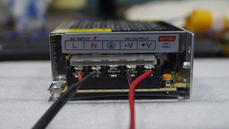

POWER SUPPLY
The Power Supply is used to deliver the power for the Status Light, Emergency Light, and the Alarm.
Power Supply
Power Supply
The Industrial grade Light Indicators and Buzzer are used to show the status and alert signal to the security (user).
Relay Board ---> Jetson Nano
Vcc ---> +5V
IN1 (Pass Light)---> 18
IN2 (Alert Light & Buzzer) ---> 23
GND ---> GND
The Industrial grade Light Indicators and Buzzer are connected to the GPIOs of the Jetson Nano.
Sensor Connection
Power Supply Connection
Sensor Connection Power Supply Connection
The Overall connection is shown below.
Overall Connection
Overall Connection

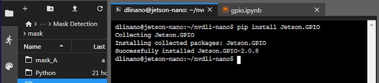

Step 5: GPIO Integration
After reading a lot of forums, I tried to interface GPIO on the Jetson Nano. We need to install the Jetson GPIO Python library using the following command:
pip install Jetson.GPIO
If you face any issues in importing this package, do try the following command to import the package.
sudo -H pip install Jetson.GPIO
Installing Jetson.GPIO lib

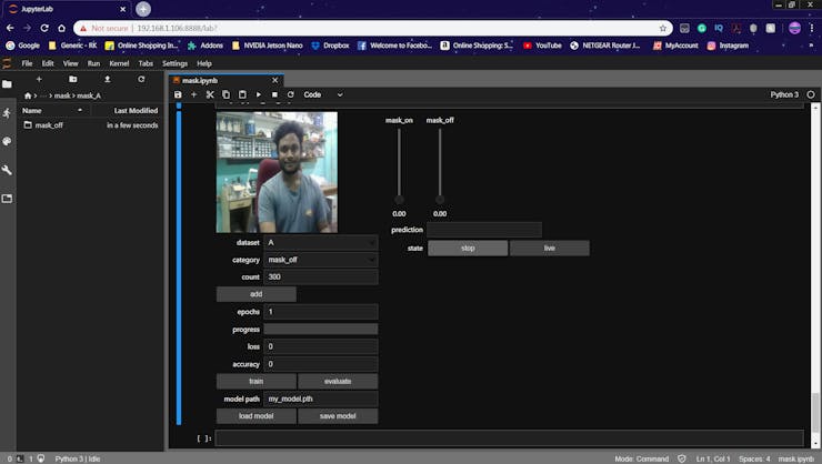

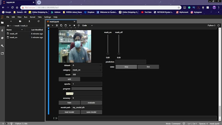

Step 7: Collecting the Dataset
The first step in this project is data collection. The System has to identify the presence of masks and classify whether the person wears a mask or not.
Although most of the libraries are pre-installed, we install several libraries to the Jetson Nano using pip install <package_name> command.
torch
torchvision
dataset
ipywidgets
traitlets
IPython
threading
time
Thanks to NVIDIA DLI, here we make some minor tweaks to the classification example and addition of GPIO interface to the project.
TASK = 'mask'
CATEGORIES = ['mask_on', 'mask_off']
DATASETS = ['A', 'B']
TRANSFORMS = transforms.Compose([
    transforms.ColorJitter(0.2, 0.2, 0.2, 0.2),
    transforms.Resize((224, 224)),
    transforms.ToTensor(),
    transforms.Normalize([0.485, 0.456, 0.406], [0.229, 0.224, 0.225])
datasets = {}
for name in DATASETS:
    datasets[name] = ImageClassificationDataset(TASK + '_' + name, CATEGORIES, TRANSFORMS)
We have installed all the required dependencies for this project. The Data-set is made by collections and arrangements of the images under the appropriate label.
For this project, we classify the image as either 'mask_on' or 'mask_off'. Initially, we created 300 images each for the dataset labels 'mask_on' or 'mask_off'. More Images were collected with different peoples and with a different background.
Collecting Dataset for without Mask
Collecting Dataset for with Mask
Collecting Dataset for without Mask Collecting Dataset for with Mask
The image is captured for each label ('mask_on', 'mask_off').

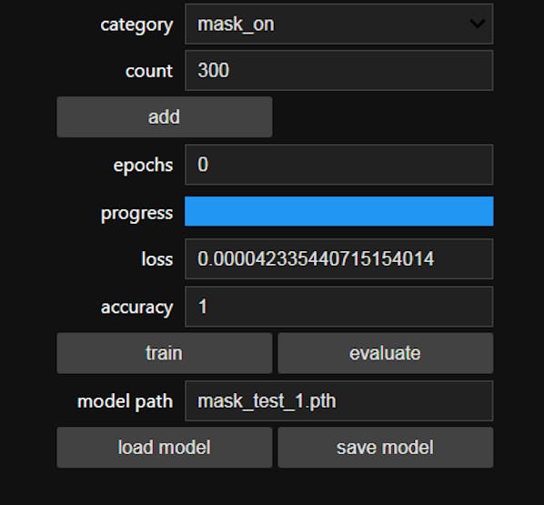

Step 8: Designing a NN & Training the Model
The Core of this project is an image classifier that classifies one of three categories. To make this Classifier, we use the pre-trained CNN (Convolutional Network) called ResNet18.
Here we use PyTorch and CUDA to generate the ResNet model which can identify the presence of a mask. The images which we generated in the previous step are used to train the model. The model is trained using the Dataset generated for a number of Epochs (Cycles) mentioned.
The model is configured with the hyperparameters as shown below.
device = torch.device('cuda')
model = torchvision.models.resnet18(pretrained=True)
model.fc = torch.nn.Linear(512, len(dataset.categories))
BATCH_SIZE = 8
optimizer = torch.optim.Adam(model.parameters())
While the model is training, you can find the loss and accuracy of the model for each Epoch, and the accuracy increases at some point in time after a few Epoch.
Model Training
Model Training
Once the train button is pressed, the model will be trained using the selected Dataset for the given epochs. I've trained the model for epochs = 10 and saved the model.
It roughly took 10 minutes to generate the model with the highest accuracy after 10 epoch and that is really quick when compared to other hardware. Thanks to NVIDIA.

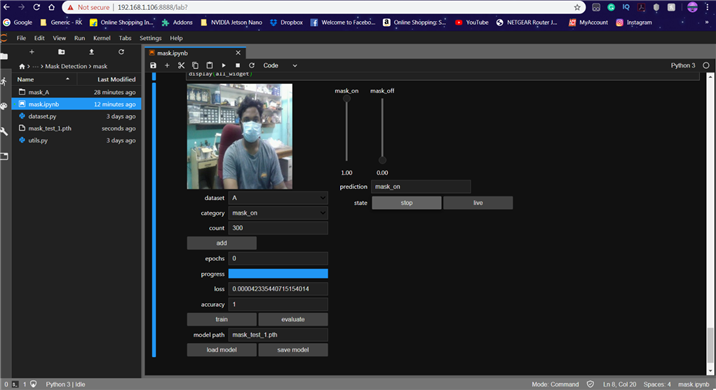

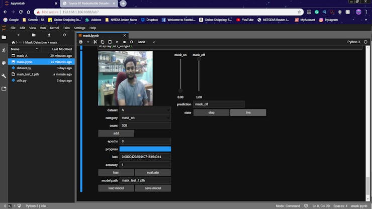

Step 9: Testing the Model
Once the model is generated, It produces the output file "my_model.pth". This file is used as the source to test whether the system can identify the presence of masks and able to differentiate the people.
The camera reads the test image and transform the required color model, and then resize the image to 224 x 224 pixel (Same size used for model generation). The images which were used for training the model can be used to test the generated model.
Once the model is loaded and the image is acquired by the camera, the model predicts the captured image using the ResNet model loaded, and make the prediction for the mask detection.
Test for without Mask Test for with Mask
Test for without Mask image
The Prediction is displayed in the Text Label and the Slider is changed according to the prediction.

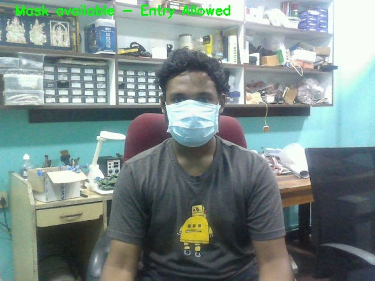

Step 10: Mask Detection Test
By taking a boolean into consideration, the presence of the mask is detected. The boolean is set to '1' when the prediction is mask_on. Similarly, the boolean is set to '0' when the prediction is mask_off.
A function is used to print the overlay to the captured image. The overlay text depends on the prediction value from the above step.
Some of the example images are shown below.
Overlay - Without Mask Overlay - Without Mask
