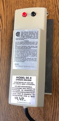

Some EPROM erasers use a G4T5 4W 254nm UVC lamp.  I had a couple in my stash, so I decided to try this out.

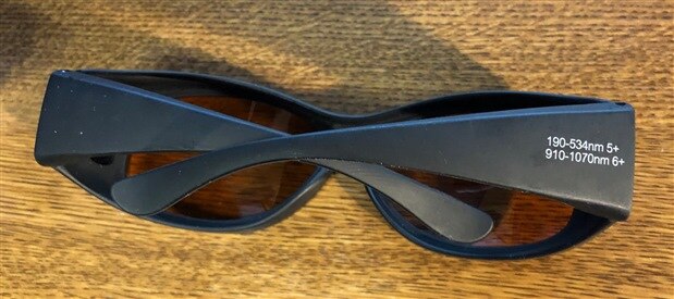

When working with lasers and other high power light sources, I use safety glasses with high optical density.
These are from Cascade Laser Corp model LSEG-YAGD
https://www.cascadelaser.com/lseg-yagd.html
The OD = 5+ with these glasses at 254nm which equals an attenuation factor of 100,000

1) First find an old UV EPROM eraser.

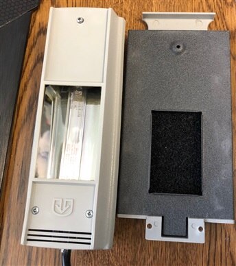

2) Remove the IC tray to expose the UVC lamp.  Make sure to first unplug the device and don't get oil
on the lamp by touching it.

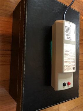

3) Find a large black box and cut out a hole and attach the lamp.

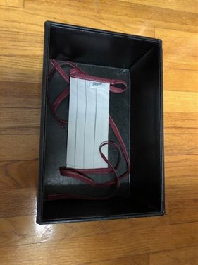

4) Insert mask or ??? in the box to be disinfected.
5) Irradiate for 10-30 seconds or CDC recommendation (>600 µJ/cm2),
then flip the mask over and irradiate the other side.
*** WARNING  ***  Do Not Look Into Lamp *** Skin and Eye Damage Will Occur ***
