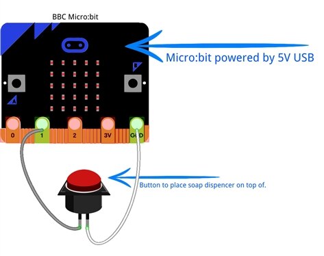

Once the Micro:bit is powered, you can set the time it takes to erase the image on the device’s LED screen. The screen is a 5x5 LED matrix if you don’t already know. Press the “B” button to increase the time.
There will be an image placed on the screen. I used a variety of images already in the Library. The system waits for a button press.
The soap dispenser would be placed on a very sensitive button. In my project, I ended up using a button I salvaged from a demolished factory. In my original plans would have been a contact switch with a travel of a micrometer. However, my salvaged button travels about 2.54 cm (an inch). I give it a gusto press, and the sequence starts.
A spiraling dot will erase the image and flash the screen with a square. You’re done washing!
It will reset to the next image and wait.

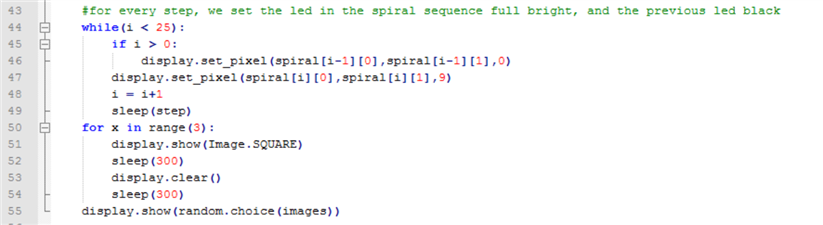

A little bit about the code:
The main feature of the program spirals the image down to nothing. It does this by drawing a bright LED, and a “black” LED behind it. A black LED is just turned off if you are wondering.
Then the code flashes a square three times when the spiral finishes.

The schematic is the simplest I could make for a first version. Wire it up like the drawing.
