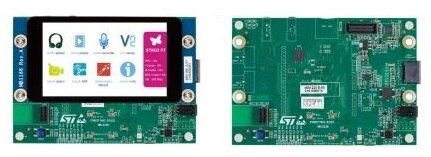

2.1 The STM32F7 discovery kit .
The 32F769IDISCOVERY Discovery kit is a complete demonstration and development platform for STMicroelectronics ArmRegistered CortexRegistered-M7 core-based MCU. It features four I2Cs, six SPIs with three multiplexed simplex I2S, 2xSDMMC, four USARTs, four UARTs, three CAN buses, three 12-bit ADCs, two 12-bit DACs, two SAIs, 8- to 14-bit digital camera module interface, internal 512+4-Kbyte SRAM and 2-Mbyte Flash memory, USB HS OTG and USB FS OTG, Ethernet MAC, FMC interface, Quad-SPI interface and SWD debugging support.

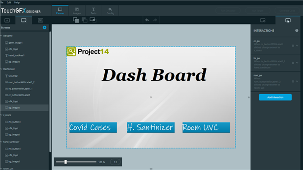

4 GUI with TouchGFX

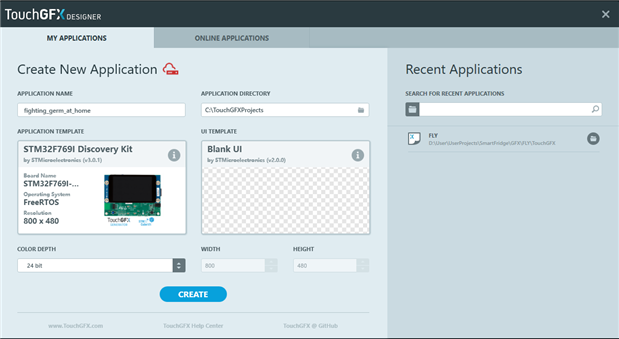

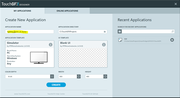

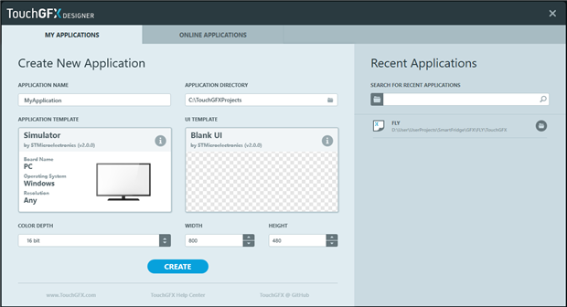

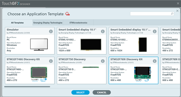

4.1  Create the GUI design with touchGFX.
Assign project name of Fighting_germ_at_home
Select STM32768 Disc as hardware platform,

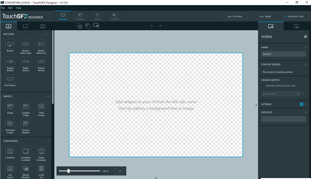

The empty UI appears,

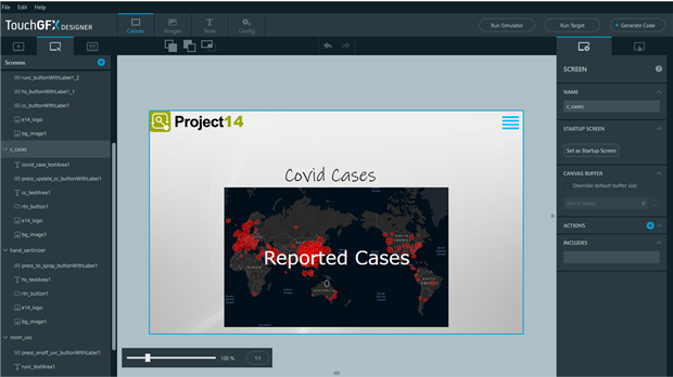

Create screens one by one with widget on the left panel.
The DashBoard screen,
The covid cases screen, since there are overlaps , the demo show empty in the image part, I shall correct it later.

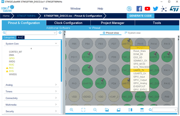

5 Hardware Porting with CubeMX

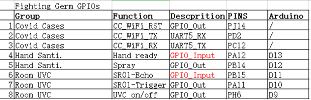

5.1 Select cubeMX project generated with this Chip-pins configurated in UI interface below,
Here is the configuration  pin Map.

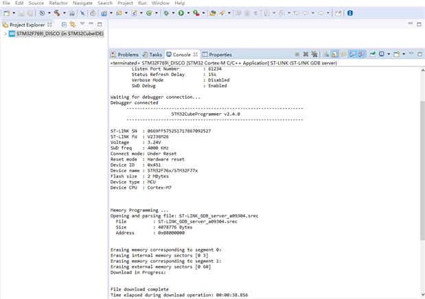

5.2 Generate Code again for new project code. Reload the design file above in CubeIDE, build the project and flash the code into the STM32F769 Disc Dev Board. The simlilar UI is show one the hardware again.
