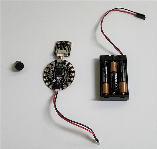

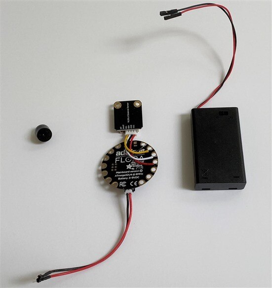

The Flora has a battery input range of 3.5V to 16V so I had a wide range of choices for power.  I ended up using a AAA battery pack which conveniently included a power switch.  For the audible alert I used a DC buzzer that draws ~13mA @ 3.3V so I could drive it directly from a digital IO pin.
Here are the front and back views of the electronic parts:

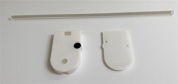

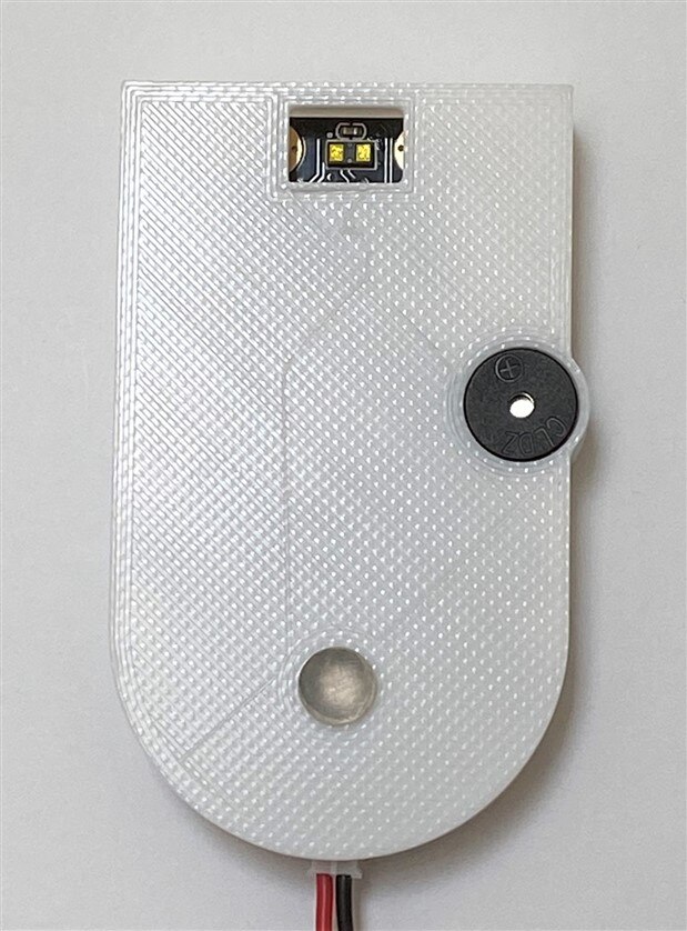

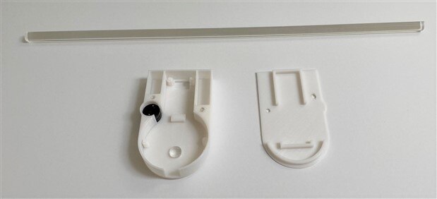

I 3D printed a case and back cover to house the components.  I ran into a couple of issues with the case.  As you can see in the above images the VL53L1X sensor is on the same side of the PCB as its connector and likewise for the Neopixel on the Flora PCB.  That meant that those components are somewhat "sunken" into the case.  In the case of the sensor I had to enlarge the window in the case in order not to interfere with the FOV which was giving me false readings.  For the Neopixel I needed to find a way to channel the light to the top of the case.  I bought a 8mm diameter plexiglass rod and cut a short 5mm segment with my Dremel.  I inserted that segment into the case just above the Neopixel.  That worked well to direct and diffuse the LED light.
Here are the inside and outside views of the case components: (the buzzer and plexiglass segment are already inserted)

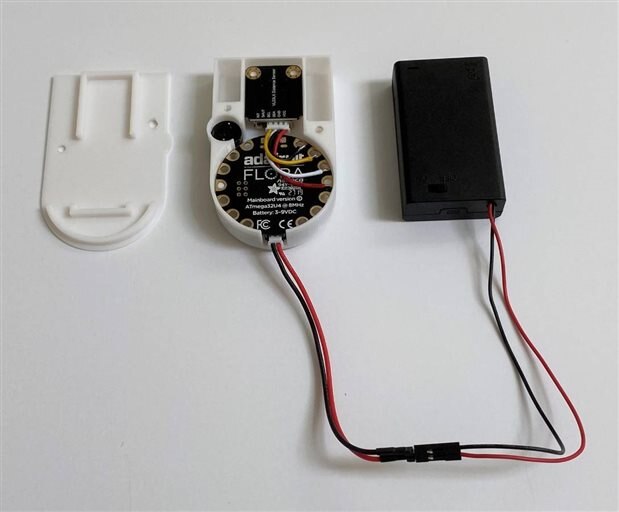

And a view of the PCBs mounted in the case:
A close up of the front of the SDAS:
