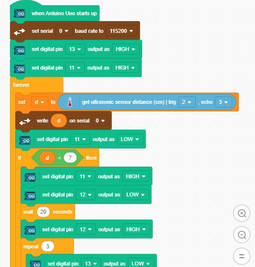

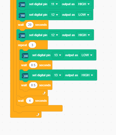

I used program called PictoBlox to code Arduino. It is a scratch based application to basically write Arduino Programs. Its free and opensource.
I generally just use Arduino IDE, but wanted to try this for simple projects and it works really great and you can do things fast. I could write the whole code (more like drag and drop) in less than 15 minutes.
They have great tutorials on their website. A must read for this powerful tool.
The code is very simple and extremely easy to read.
Here is the file. https://bit.ly/20sHandwash
The converted Arduino Code:

void loop() {
    //put your main code here, to run repeatedly:
    d = getDistance(2, 3);
    Serial.println(d);
    digitalWrite(11, false);
    if((d < 7)) {
        digitalWrite(11, true);
        digitalWrite(12, false);
        delay(20 * 1000);
        digitalWrite(12, true);
        for(int i = 0; i < 3; i++) {
            digitalWrite(13, false);
            delay(0.5 * 1000);
            digitalWrite(13, true);
            delay(0.5 * 1000);
        delay(4 * 1000);
