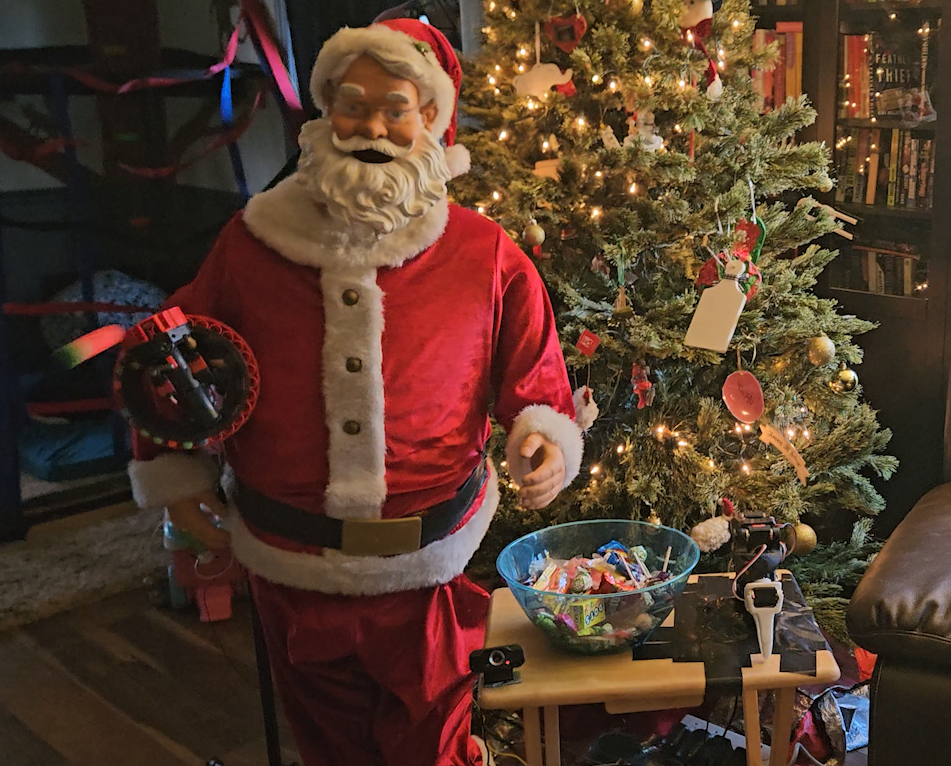

Step 1: The Setup
This runs on a Raspberry pi, and the audio plays through a usb speaker. It uses a webcam for the computer vision, where we just take and process a frame at the correct time. We use an ultrasonic sensor to determine if someone has walked in front to begin with, so we're not just looking for someone at all times. As we'll get to, this uses a paid api so even though it doesn't cost a lot, it makes that much more sense (and cents) to not just have it running nonstop.

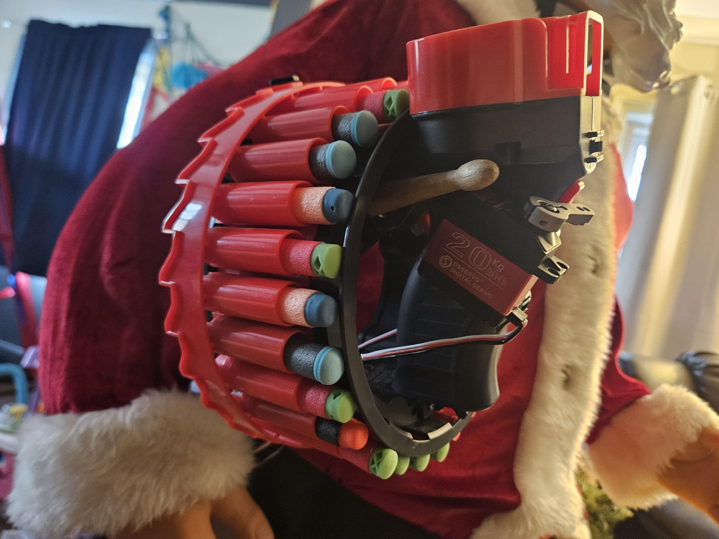

Step 2: Adding the Nerf Gun
Sometimes the simplest solutions are the best ones. I found a nerf gun that could be powered on and then run just by pulling the trigger, as opposed to all the ones that need pulled back after firing each time. The first setup I tried involved threading a string around its activation trigger and its firing trigger, which actually would've worked in full if not for the fact that I somehow broke the nerf gun in the process. So, I instead got 2 fairly strong servos and just glued them right onto the nerf gun. It worked absolutely perfectly. I was extra careful about programming how much to move them, where I did little iterations until it worked just right, so as to avoid damaging the nerf gun, but I found the sweet spot and we were ready to rock. It's a goofy project, so a slightly goofy setup just feels right. And, to that end, you'll notice from the close-up that the element that helped correctly seat the nerf gun on the stand were a couple of drum sticks. If it works, it works.

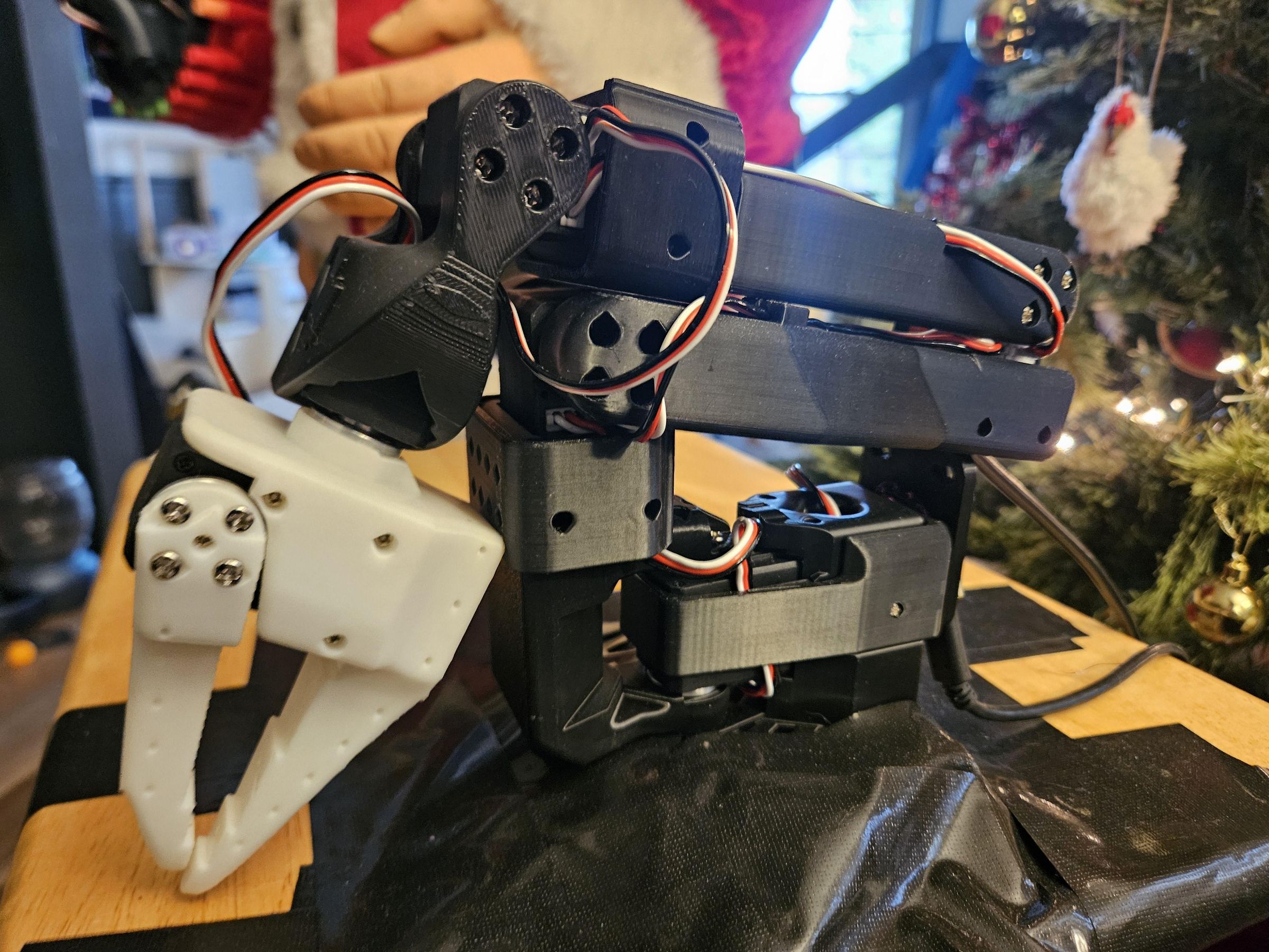

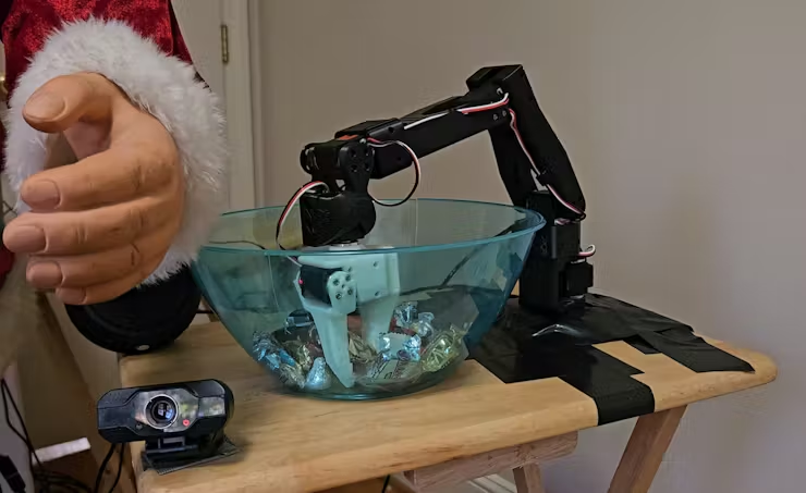

Step 3: Candy Throwing Robot
I had recently made a candy throwing robot and had intended to use it for Halloween (for obvious reasons). I instead ended up making an absolutely massive box fort, as one does. So, I realized that this was the perfect element for completing Judgmental Santa, where he would have something to do when he judged someone nice.
The robot arm is an SO-ARM100 I got from SEEED. It's meant to be used by having a leader arm that you move around, where the follower arm copies its movements. Instead, I have it programmed to go through a set of motions that have it reach into a candy bowl, wind back, and move forward quickly as it opens its hands such that it throws the candy. The arm was having a lot of issues by this point (seemingly from wear and tear) so I ended up making its path a little easier so it wouldn't have to work as hard against gravity, which didn't throw the candy quite as well but it got the job done.
One nice thing of this as well is that the setup for the robot arm called for the use of the little table that it is, indeed, duct taped to. This way it has a place to be and there's a place for the bowl of candy, but it also acted as an intuitive place to keep the ultrasonic sensor. Having it positioned on or around Santa was distracting.

# Function to throw candy using LeRobot arm
def youre_nice():
    print("Executing 'you're nice' action - throwing candy!")
    try:
        # Load the sequence file
        file_path = Path(SEQUENCE_FOLDER) / f"{ROBOT_SEQUENCE}.json"
        if not file_path.exists():
            print(f"❌ Sequence file not found: {file_path}")
            print("Skipping candy throw - sequence file missing")
            return
        with open(file_path, "r") as f:
            data = json.load(f)
        sequence = data["sequence"]
        # Connect to motors
        config = FeetechMotorsBusConfig(port=ROBOT_PORT, motors=MOTORS_CONFIG)
        motor_bus = FeetechMotorsBus(config)
        motor_bus.connect()
        print("✓ Connected to robot motors")
        # Remove all limits
        print("🔓 Removing all limits...")
        for motor_name in MOTORS_CONFIG.keys():
            try:
                motor_bus.write("Min_Angle_Limit", 0, motor_name)
                motor_bus.write("Max_Angle_Limit", 4095, motor_name)
            except Exception as e:
                print(f"⚠️ {motor_name}: {e}")
        # Set speed
        speed_settings = {
            "very_slow": {"acceleration": 50, "max_accel": 50},
            "slow": {"acceleration": 100, "max_accel": 100},
            "medium": {"acceleration": 150, "max_accel": 150},
            "fast": {"acceleration": 254, "max_accel": 254},
        settings = speed_settings.get(ROBOT_SPEED, speed_settings["slow"])
        print(f"⚙️ Setting speed to {ROBOT_SPEED} with LOCKED torque...")
            try:
                motor_bus.write("Mode", 0, motor_name)  # Position Control
                motor_bus.write("P_Coefficient", 32, motor_name)  # Higher P for stronger hold
                motor_bus.write("I_Coefficient", 0, motor_name)
                motor_bus.write("D_Coefficient", 64, motor_name)  # Higher D for stability
                motor_bus.write("Lock", 1, motor_name)  # LOCK=1 to hold position against gravity
                motor_bus.write("Torque_Limit", 1023, motor_name)  # Maximum torque
                motor_bus.write("Maximum_Acceleration", settings["max_accel"], motor_name)
                motor_bus.write("Acceleration", settings["acceleration"], motor_name)
        # Enable torque
        motor_bus.write("Torque_Enable", TorqueMode.ENABLED.value)
        print("⚡ Torque ON - throwing candy!")
        # Execute the sequence
        print(f"🍬 Throwing candy with sequence: {ROBOT_SEQUENCE}")
        for i, step in enumerate(sequence):
            pos = step["positions"]
            duration = step["duration"]
            position_num = step["position"]
            pos_str = " | ".join([f"{motor}:{position:4d}" for motor, position in pos.items()])
            if position_num == 1:
                print(f"Position {position_num}: {pos_str} (moving to start)")
                for motor_name, position in pos.items():
                    if motor_name in MOTORS_CONFIG:
                        motor_bus.write("Goal_Position", int(position), motor_name)
                time.sleep(1.5)
            else:
                if duration == 0:
                    print(f"Position {position_num}: {pos_str} (SUPER FAST)")
                            motor_bus.write("Goal_Time", 200, motor_name)
                    time.sleep(0.4)
                else:
                    print(f"Position {position_num}: {pos_str} (SMOOTH ~{duration}s)")
                    time.sleep(0.8)
        print("✓ Candy thrown successfully!")
        # Disable torque
        motor_bus.write("Torque_Enable", TorqueMode.DISABLED.value)
        motor_bus.disconnect()
        print("✓ Robot disconnected")
        print(f"❌ Error throwing candy: {e}")
        import traceback
        traceback.print_exc()
        print("Continuing without candy throw...")

Step 5: The Result
Combine a goofy AI vision flow, a nerf gun, and a robot arm and it turns out you do indeed get good Christmas-y fun. Getting this version together was particularly motivated by a big family reunion we had this year, and having Judgmental Santa join the festivities was really enjoyable.
Hope you enjoyed this crazy creation. Merry Christmas.
