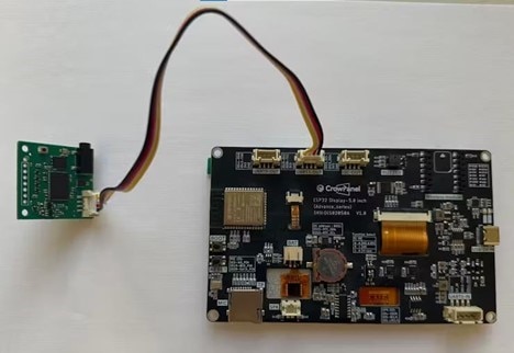

The project runs on a compact MCU-based system with a capacitive touch screen and a tiny speech synthesizer module.
Each quiz item consists of an image, a short text line, and a spoken phrase.
The device displays an animal, waits for a tap, and then plays the corresponding spoken hint.

The system consists of two main parts:
  1. a touchscreen interface running on the Elecrow CrowPanel, and
  2. a TinyTTS module that generates speech offline.
The CrowPanel displays a simple grid of animal images. Each image corresponds to a short description line stored in the project assets. When the user taps an animal, the CrowPanel sends a small UART message to the TinyTTS module. The message contains the ID of the selected animal, which determines what phrase should be spoken.
The TinyTTS module receives the command and immediately synthesizes the corresponding audio line on-device. The output is sent directly to a small speaker. Because everything runs locally on microcontrollers and does not rely on cloud services, the reaction feels instant: touch → message → speech.
This architecture makes the system easy to extend. New quiz items require only an additional image and a short text string. The speech module handles all audio generation internally, without external audio files or pre-recorded samples.

Hardware Assembly
Connect the CrowPanel to the TinyTTS module over UART (TX-RX and GND), attach a small speaker to the TinyTTS audio output, and power the CrowPanel from a 5V USB source.
