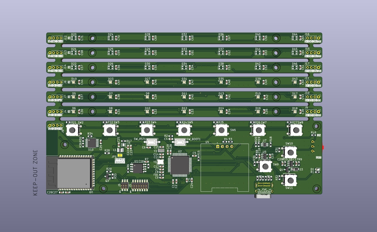

  1. Make the device game specific. last time i made it multipurpose (Nebula wall art and pixel frame) for a competition purpose. it still serves well for those purposes
  2. I want to make the device smaller. V1 PCB was around 210x210mm making it less portable and making cases on my Ender S1 Pro was very difficult, i had to hack it to print more than the standard print area
  3. I Dont want touch. We both prefer the haptics of a click
  4. Fix the battery circuit. Last time i made a mistake with battery circuitry and would only work on the USB-C cable attached. Effectively breaking the "on-the-go" function
  5. I want to have ESP32 to enable over the internet play as well as "LAN Play" via the ESP-Now , but will use STM32F103 as main, to conserve battery.
  6. I also want to make the PCB cheaper to manufacture. The 210x210mm was expensive, so this time i made it modular that way anyone who wants to recreate this, can choose any LED or LED Strip of their choice. I am gonna go with Wurth LEDs. I fell in love with them because of the seriously awesome reliability. But as i said before, you can use any other LEDs
  7. PCB to be made in white Solder masks, helps make the light at projection plate more uniform and hide the hotspot better.
  8. Improved button placement.
  9. I also wanted an animation of the chip falling down on the column to get a more realistic feel

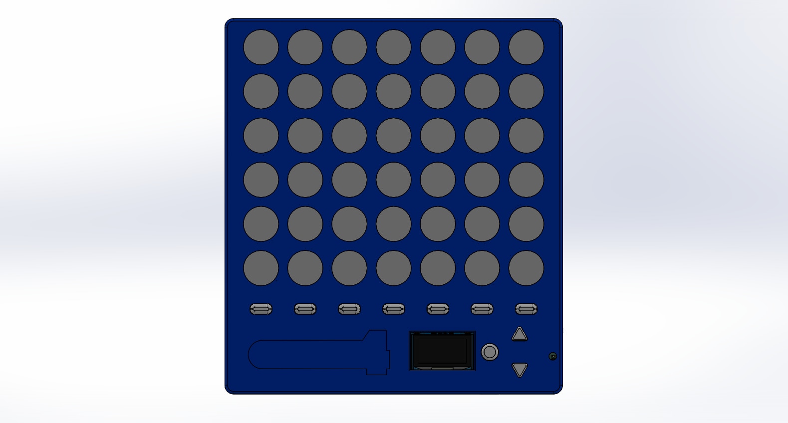

And so the Concept Began
  1. The Buttons are now towards the right side, and can be accessed by one hand.
  2. The Column buttons are also easily reachable by thumbs when the hands are gripping it in both hands
  3. The size is around 170mmx150mm, portable yet, big enough for the feel of the game.
  4. A placeholder for sticker
  5. The Thickness is 15mm. The Restrictions come from the PCB and the Distance between the LED and diffuser needed to make an uniform Glow
  6. For the PCB I made it such that there is a Control Board and LED strips. Each can be cut off and used independently.

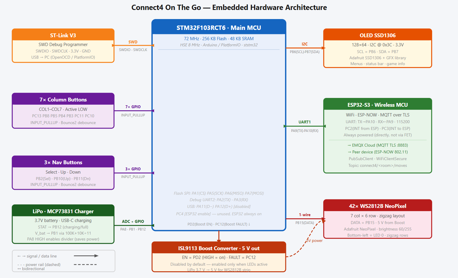

The Embedded Design
As said before the main brain is the STM32F103RCT6. I Opted STM32 because it is a healthy balance between power usage, capability and community acceptance. The ESP32-S3 works as co-processor only to transmit data via MQTT Over Internet or ESP-NOW for a local play. An MCP73831 to manage the LiPo Charging, along with Ideal FET Design for a crude power path circuit. AP2112K was a tough choice. It provided 600mA of Current before it started sagging, ESP needed a healthy 500mA during start, I was sure that Rest of the circuit took less than 100mA. For powering the LED, i used a Boost converter Renesas ISL9113ER7Z with input straight from the VSYS (After the power path circuit) it varied from 4.8V when USB is plugged in to Lowest LipO Voltage 3.7 Volt. This way, the LED's current draw will not be through any LDO. I added in a 16Mb Flash chip storing statistics. To Measure Battery while minimizing drain i took reference from https://en.ovcharov.me/2020/02/29/how-to-measure-battery-level-with-esp32-microcontroller/  . The 7 Column Switches and the Selector switches are from Wurth and have pull ups. I also used 74AHCT125 as a Level Shifter to convert the 3.3V Logic to 5V to keep the LEDs happy. I used MOSFET as a high side switch to turn on the ESP32 whenever network is required.
Here is the Architecture and Schematic for the
The Mistakes Made
  1. During the enthusiasm i Forgot to add pull up pins for ESP32 GPIO0 and RST, and had to patch the PCB.
  2. I used 1.27mm pitch connectors for programming the STM32 and The ESP32 but I kept the pin too close that i couldn't plug in both the connector cable at the same time
  3. The Power indicator LED is randomly placed
  4. Not sure why, but the MOSFET Switch leaked 2.8V into ESP whenever it was supposed to be turned off/. Better use Load switch like TPS22918DBVT

Pin Map (STM32)
Function Pin(s) Notes
Boost 5V Enable PD2 HIGH = 5V on
Boost Fault PC12 LOW = fault
ESP32 INT from PC2 Input, interrupt from ESP32
ESP32 INT to PC3 Output, wake/interrupt to ESP32
ESP32 Enable PC4 MOSFET gate UNUSED — ESP32 directly powered
ESP32 UART TX PA9 USART1 TX -> ESP32 RX
ESP32 UART RX PA10 USART1 RX <- ESP32 TX
Column switches PC13,PB8,PB5,PB4,PB3,PC11,PC10 COL1-COL7, active LOW, INPUT_PULLUP
SW1 (Select) PB2 INPUT_PULLUP
SW2 (Up) PB10 INPUT_PULLUP
SW3 (Down) PB11 INPUT_PULLUP
OLED SCL PB6 I2C, SSD1306 @ 0x3C
OLED SDA PB7
Charge STAT PB12 MCP73831: LOW=charging, HIGH=full/no batt
Flash CS PA1 SPI1 (SCK=PA5, MISO=PA6, MOSI=PA7)
Battery ADC EN PA8 NTJD1155L gate; HIGH enables divider
Battery ADC PB1 100K+10K divider; V_bat = V_adc * 11
Debug TX PA2 USART2
Debug RX PA3
USB D- PA11 Disabled for now
USB D+ PA12
LED Data PB15 DotStar or NeoPixel
LED Clock PB13 DotStar only (APA102)

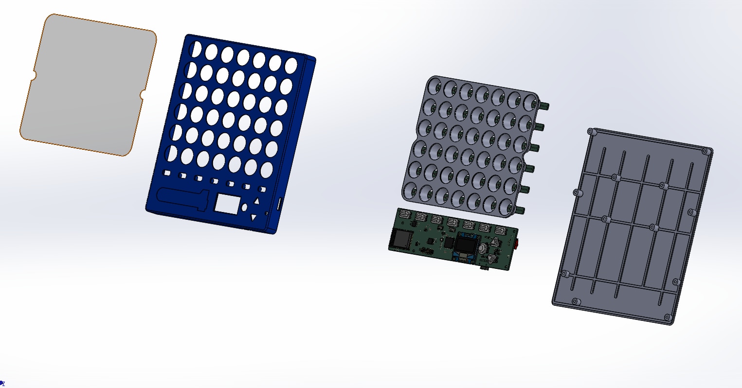

The Casing
The Casing consists of
Part Material Notes
Front Case eSUN Silk Blue PLA Holes for buttons, OLED, LED grid, and USB-C port

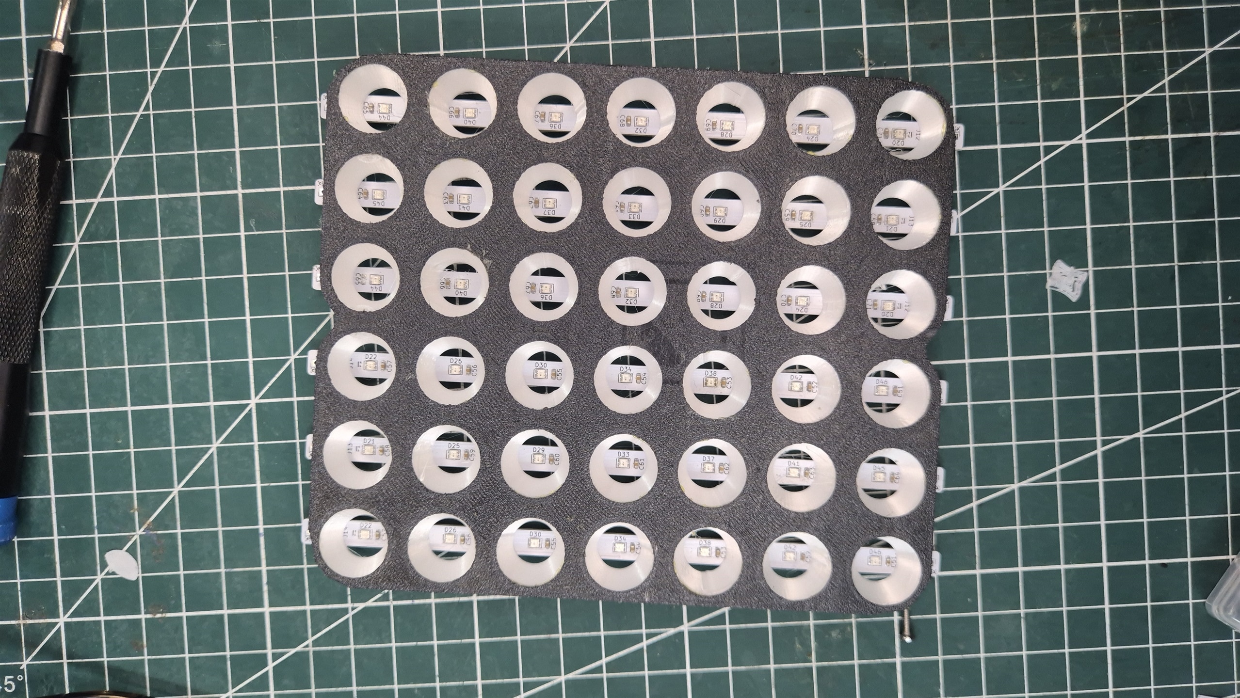

LED Cones eSUN PLA+ White One cone per LED; focuses light onto the diffusion sheet
LED Diffusion Base eSUN PLA+ Black Holds all 42 cones at correct spacing; sandwiches diffusion sheet between itself and the front case
Back Case eSUN PLA+ Black Closes the enclosure; screws to front case
All files are available along with the Github repo

Focus Cones
Adding Screw insertsScrew Inserts for the Cones
Gluing the Cones to the Base
Arranged LED Matrix

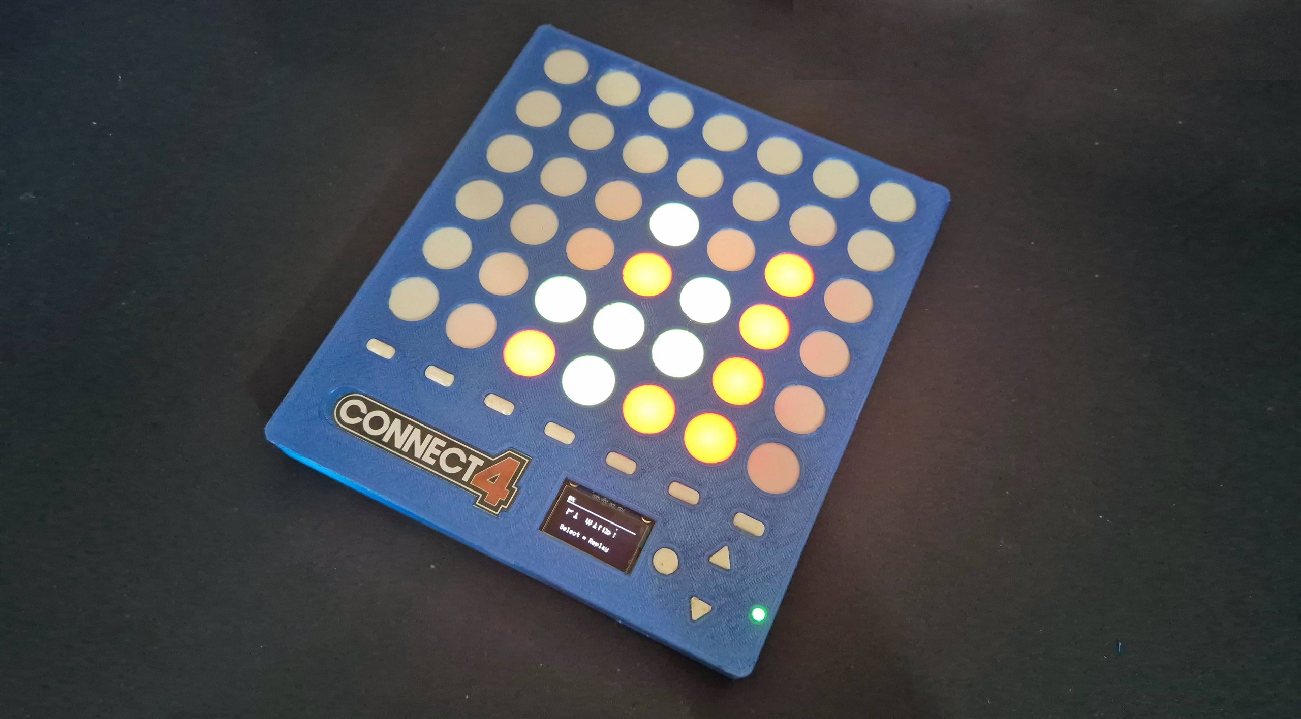

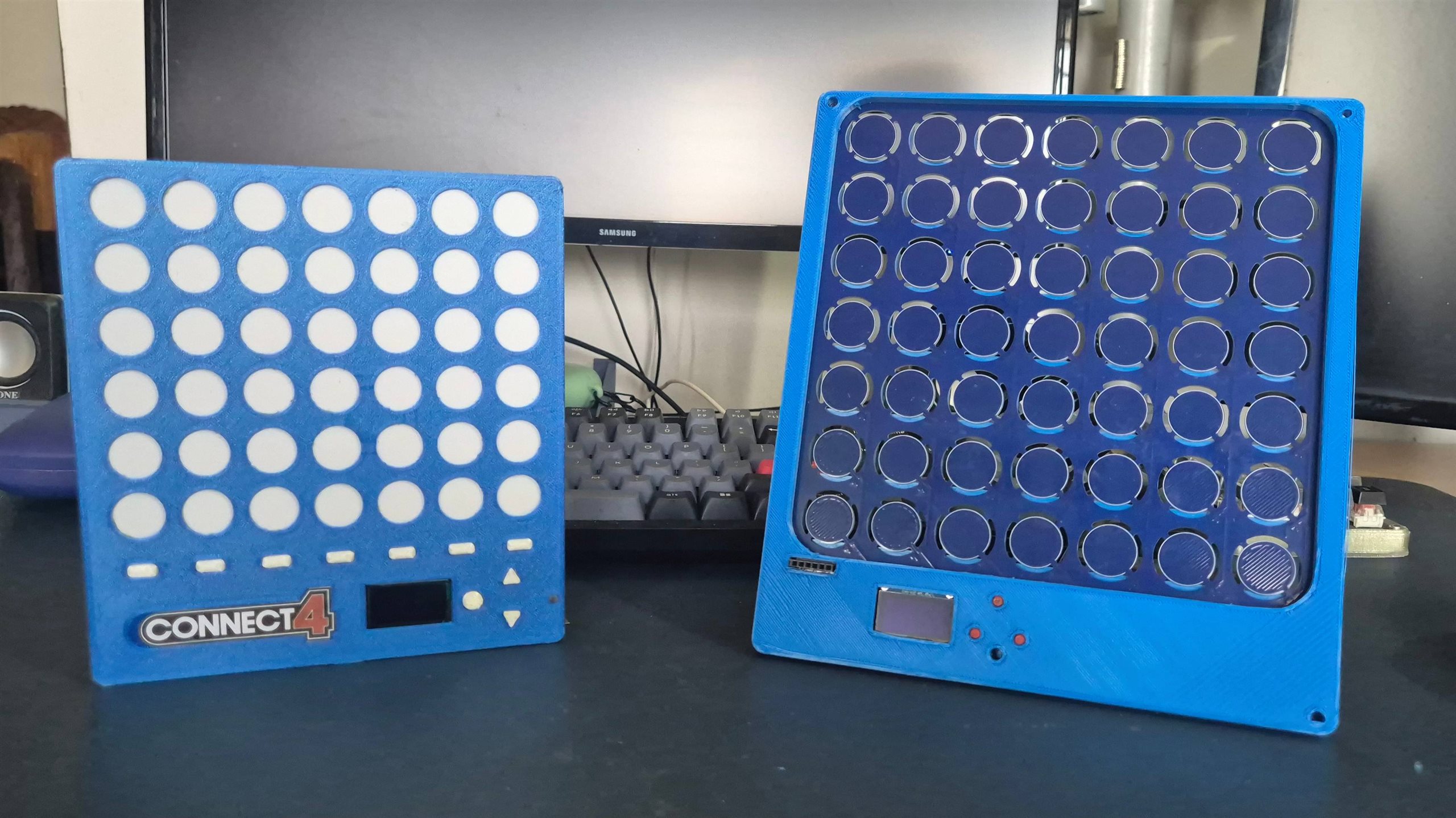

The Final Demo
In the first part of the video, I demo the Hot Seat mode. This is an entirely offline mode of the game, where two players will be using the same device. The device is simply passed from the first player to the second player for the second player’s turn, as the first player makes the first move.
In the second part of the video, I demo online gameplay capability. I Couldnt  3D print the second complete device, so I decided to simulate the second device by using an additional Control PCB,I will be assembling the second complete device shortly, but the current setup already validates the internet-based communication and  game synchronization.
Here is a comparison between V1 and the current version
