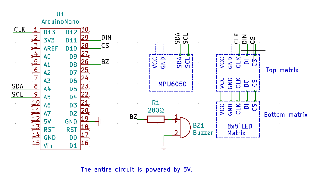

The generic circuit is as follows:
Excuse the unusual appearance, but since we are talking about electronic modules, I think even if they are represented this way it is still understandable.
As a microcontroller, you can use almost anything that is compatible with the Arduino IDE, I have an ATMega328p at hand.
The 2 8x8 LED matrices with MAX7219 driver are connected in cascade.
The module containing the MPU6050 IC is connected to the microcontroller via the I2C interface.
And the passive buzzer has a 280Ω resistor connected to reduce its sound a little (it would actually be very loud without it).

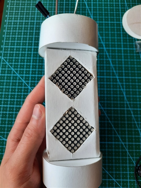

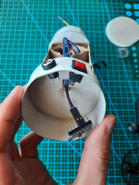

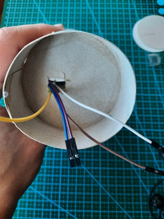

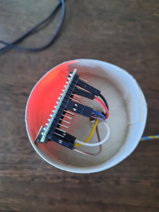

The slightly harder part at the moment is building an enclosure. In the near future I may end up buying a 3D printer which helps a hobbyist a lot, the projects can come out much more attractivOk womanSo until then I'm turning again to the most handy material, low cost and unaesthetic, cardboard. [[emoticon:fc35ca29c39f452eb143b6f3a2b4c859]Sweat smile] . Even as unattractive as this looks, I spent a some hours working with scissors and glue to build a body in which to assemble the modules.
