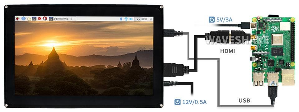

  1. Raspberry pi 5 with Debian Bookworm OS installed
  2. 10" Waveshare Touch Display/Monitor for Pi

(Connection image was taken as a reference from Waveshare website no copyright infringement was intended)

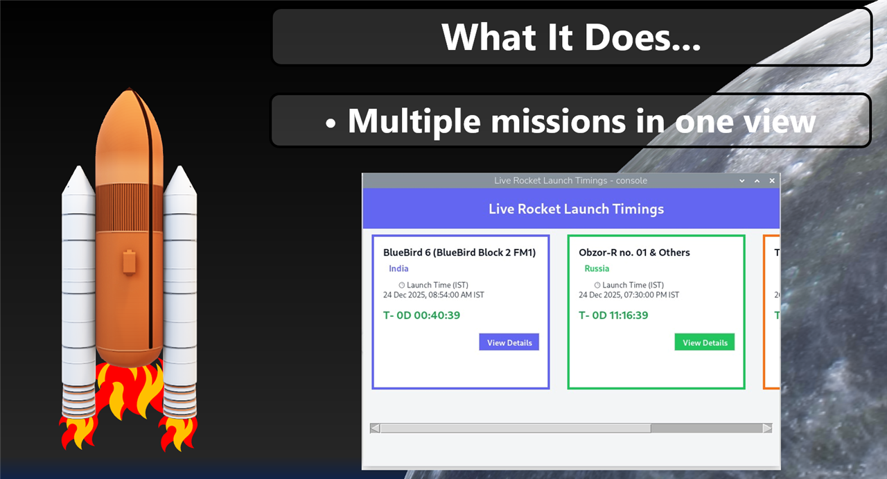

The goal was to create a "Command Center" feel. I wanted three main layers of visualization:
  1. The Overview: A scrolling view of all upcoming global missions.
  2. The Details: Deep-dive specs (Provider, Vehicle, Launch Pad).

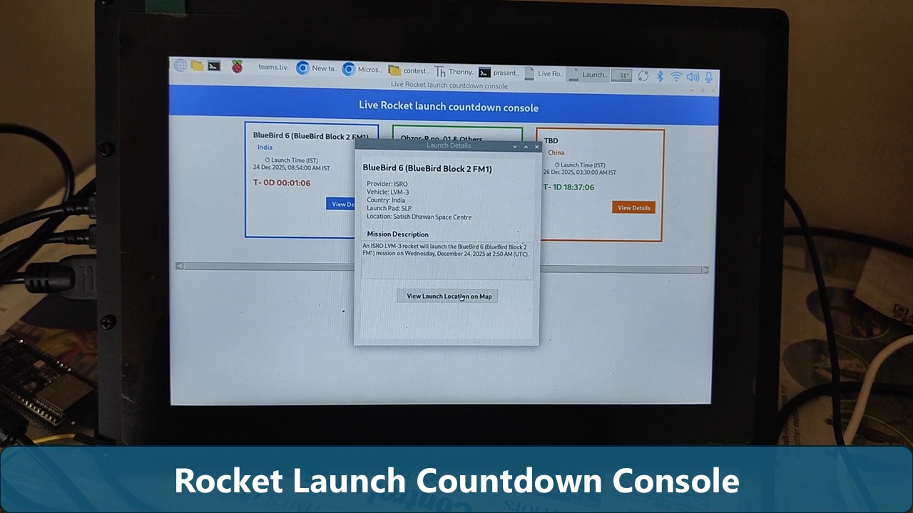

Step 3: Building the GUI (Visualizing the Console)
I used Tkinter to build the interface. Each launch is housed in its own "card." I used color coding to separate different missions—for example, the BlueBird 6 mission from India and the Obzor-R mission from Russia. This makes the data much easier to process visually than a standard text list.
Step 4: Map Integration & Mission Details
Visualization shouldn't just be numbers; it should be spatial. By clicking "View Details," a secondary window opens.
The coolest feature (in my opinion) is the "View Launch Location on Map" button. This uses the web browser module to take the location from the API and open them directly in a browser.
