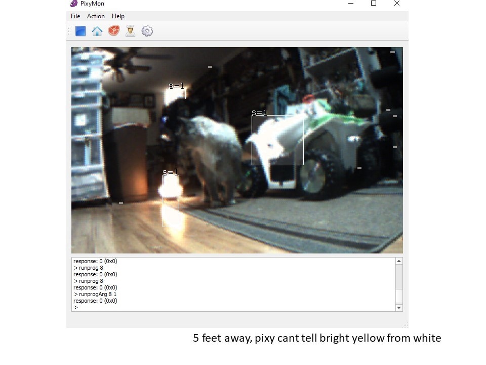

I failed the PixyCam during troubleshooting and testing. Rather than replace the PixyCam, I want to make a generational platform change and upgrade to OpenCV for real object detection for the Chase Tank steering. That tho will be another project later.

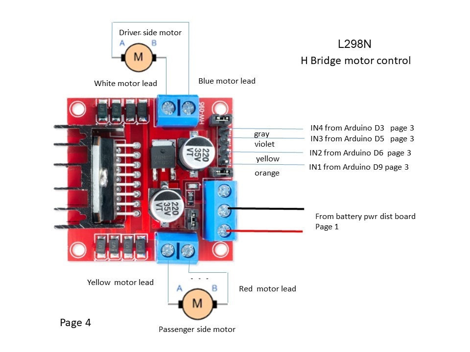

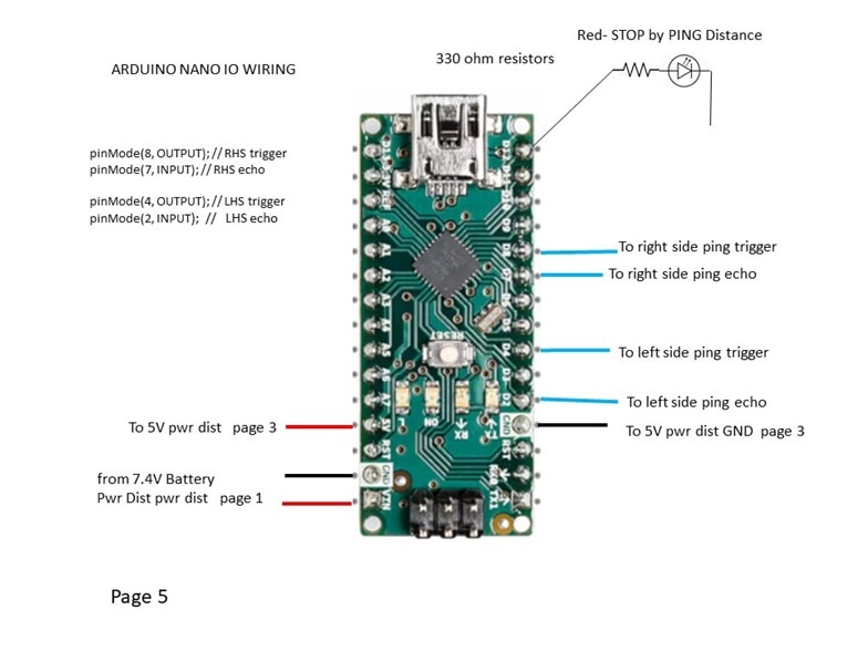

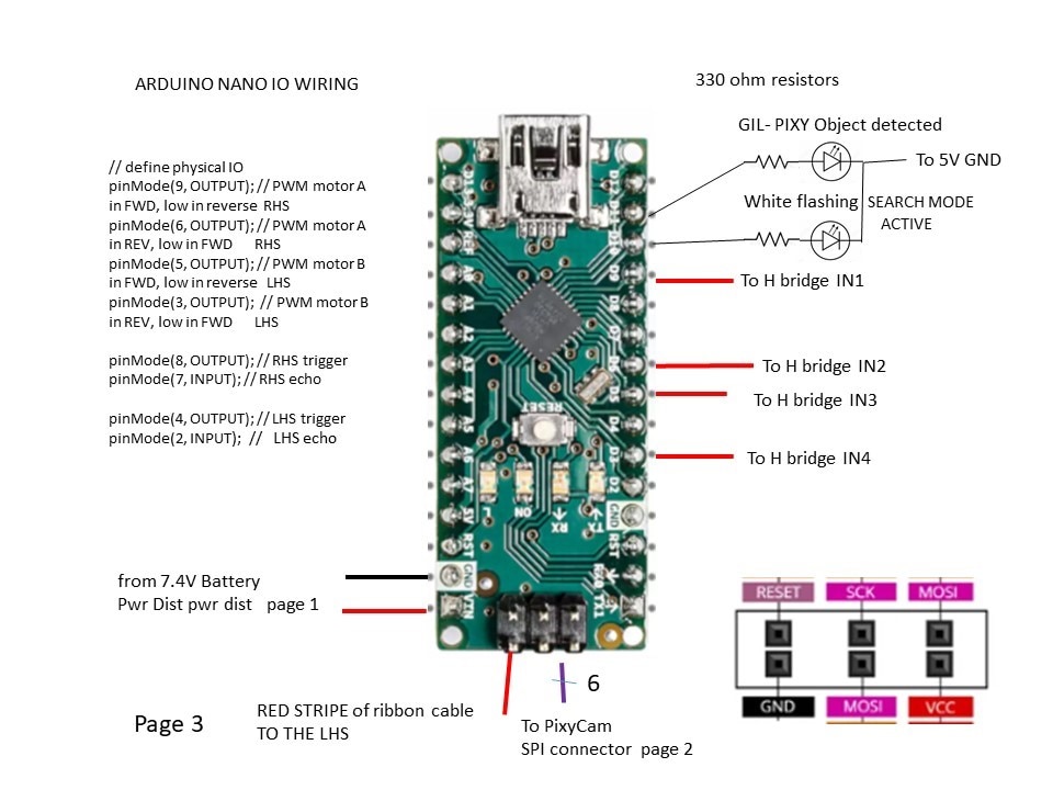

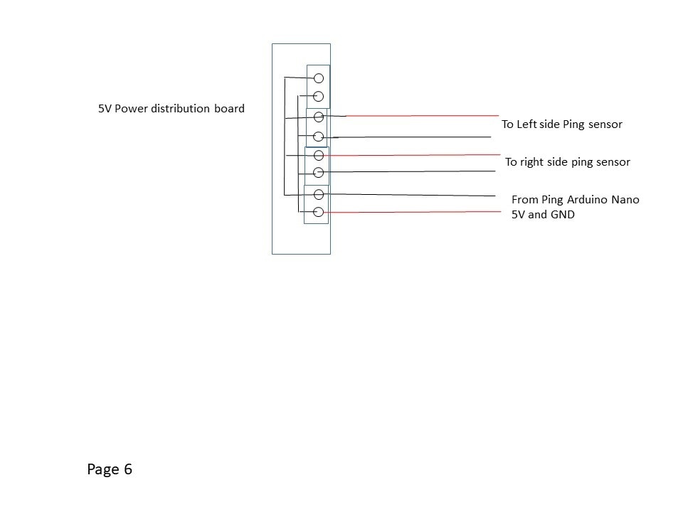

The Chase Tank uses a model tank chassis, each tread has an independant DC motor. Ping Sensors and a PixyCam are used for object detection. PixyCam is using its tilt and pan accessory to do quick area searchs.  There is an onboard DVM to keep an eye on the battery volts.
Introducing Sharky the Chase Tank operating modes:
  1. object detected 6 inches in front of either treads by ping sensor - lite the red LED & disable tank tread motion until the object

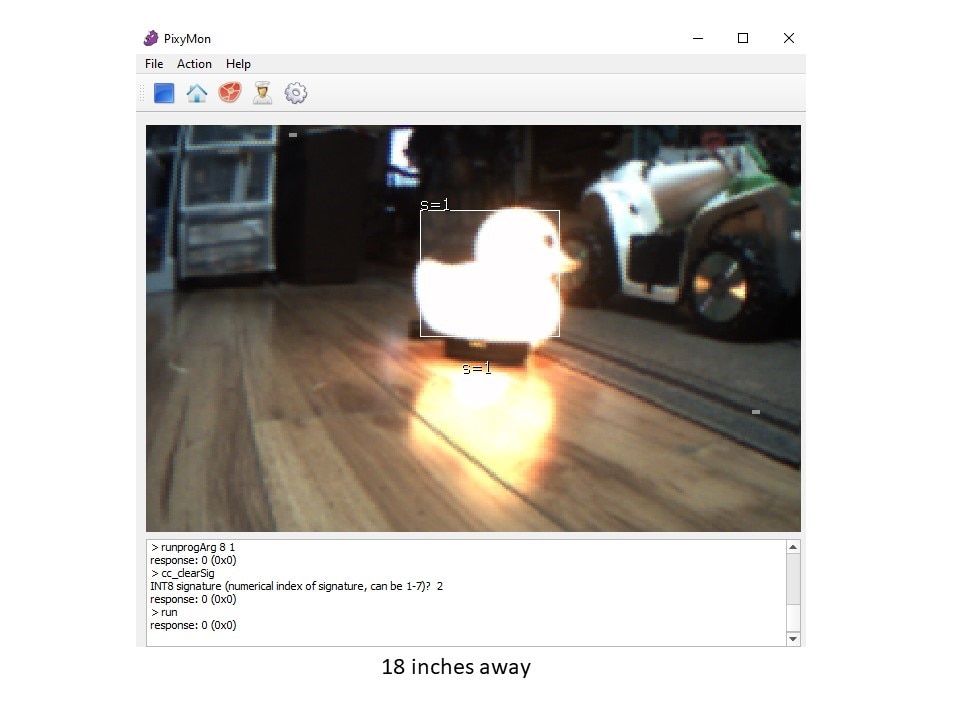

  1. Search mode - search for the rubber duck by panning the camera. If no Duck is seen, rotate the tank and try panning the camera again.  White LED lit while searching
  1. Duck is seen by pixycam (SIGNATURE=1 Block 0 Pixels>20 ). Move towards target Duck, gating PWM H bridge for both left and right side threads at 80% duty FWD. Using the delta position on either side of center as seen by the camera to steer the tank's  right hand side tread , in graduated speed increments plus or minus from the 80% PWM duty. --- the green LED is lit when operating in this mode.   This mode is mutually exclusive with Search Mode.

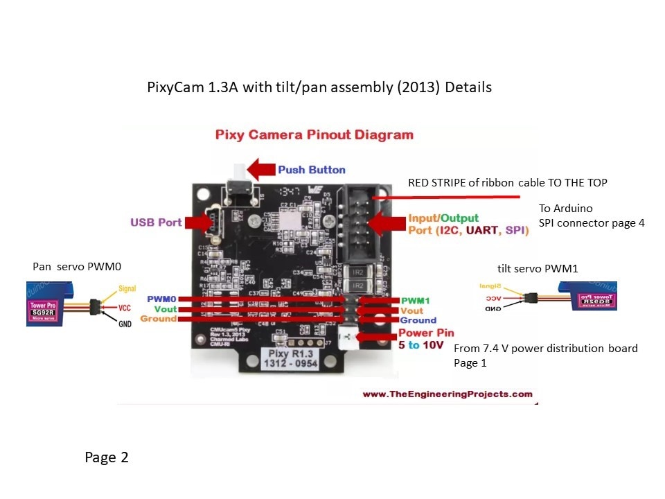

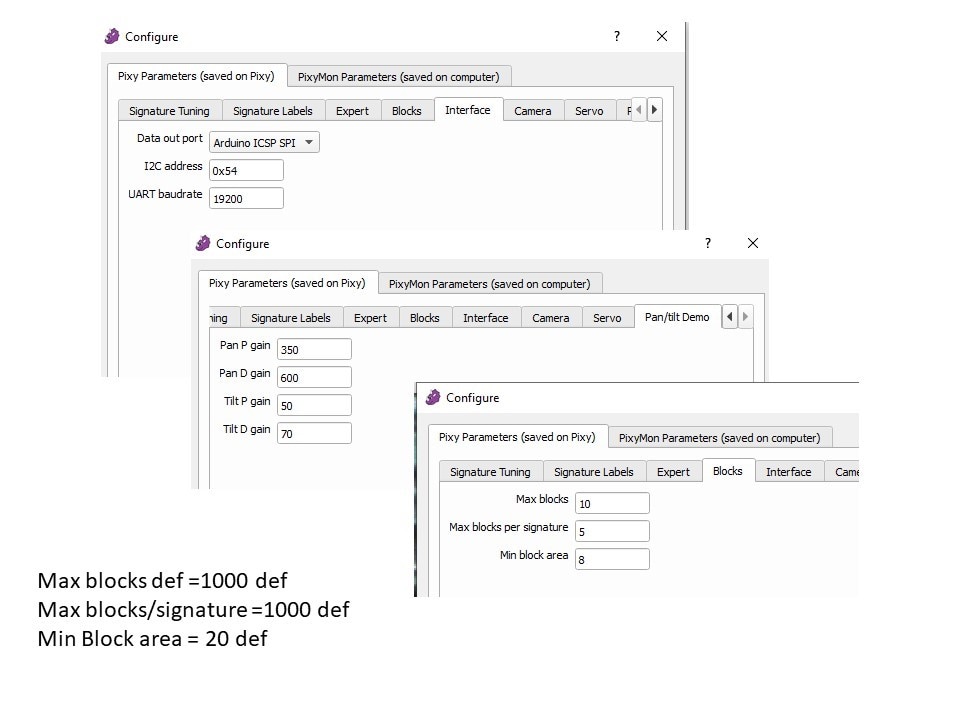

  • PixyCam gets very hot in a couple spots. The PixyCam pan/tilt failed tilt servo seems to mechanically failed causing a locked armature condition. PixyCam let out smoke, but seems to continue to function with the tilt servo disconnected. I disabled code that use the tilt motion.

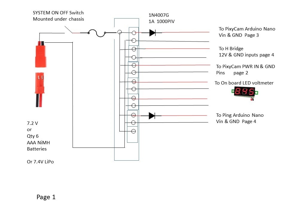

  • The 7.4 V Lipo was puffy, so grabbed another Lipo battery to use. Opps, grabbed a 11.1V Lipo and plugged it in. The PixyCam upper Volt limit is 10V. Another big oooopps. Im thinking that 11.1 V Lipo was also bad, so did no real damage.
  • I wanted to use an Arduino UNO R4 as the main controller. The Arduino PixyCam library is incompatible with UNO R4, decided to use an Arduino Nano R3.

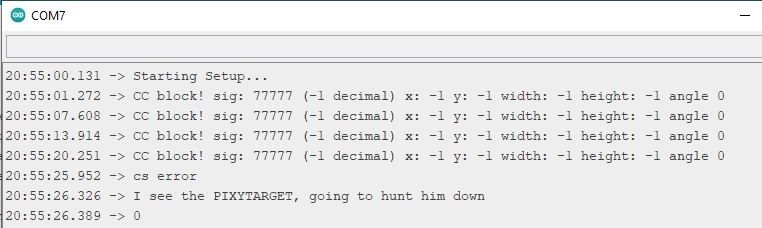

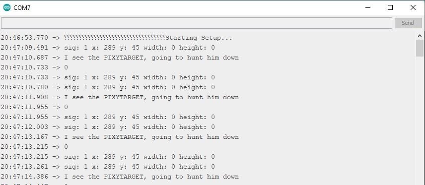

Sharky the Tank was working with PixyCam, but wasnt working correctly. I added diagnostic LEDs for the operating modes to help troubleshoot.  The PING sensor code was interfereing with the SPI library so I added a second Arduino Nano dedicated for the ping sensors.
  •  The Arduino Nano SPI connector is backwards from the Arduino Uno. Opps , In spite of checking, I plugged it in wrong, and his is likely when PixyCam got damaged.
Operational videos
https://youtu.be/iIGEVzC9s5w
photos:
 bad PixyCam data with 5V from Arduino SPI connector and the 7.4V power feed after failure
 bad PixyCam data with 5V from Arduino SPI connector only after failure
wiring schematics

//Max blocks: This parameter sets maximum total number of blocks (objects) Pixy will report per frame.
//For example, if you set this parameter to 2, Pixy will report a maximum of 2 objects (the 2 largest objects) regardless of which signature the blocks belong to,
//and all other detected objects will not be reported.
//Max blocks per signature: This parameter sets the maximum number of blocks (objects) Pixy will report per signature, per frame.
//For example, if you set this parameter to 2, Pixy will report a maximum of 2 objects for each signature,
//and all other detected objects with that signature will not be reported.
//Min block area: sets the minimum area of reported blocks.
//If a detected block has a smaller area, it will not be reported. For this purpose, area of a block is calculated as width * height.
// We only want to look at blocks with signature 1
// setting PixyMon MAX blocks = 10
// setting PixyMon MAX Blocks per signature =5
// setting PixyMon MIN block area =8

      Serial.println ("I see the PIXYTARGET, going to hunt him down");
      Serial.println (blocks);
      pixy.blocks[0].print();
      blob_x = pixy.blocks[0].x ; // The x location of the center of the detected object (0 to 319)
  //    blob_y = pixy.blocks[0].y ; // The height of the detected object (1 to 200)
      blob_width = pixy.blocks[0].width ;  // new in this rev, The width of the detected object (1 to 320)
  ////// *** turn speed by blob width ****
      if (blob_width < 20 )   // 20 X 20 about 4.5 feet from camera,  at 7 feet: width is 10 pixels height = 20
      TurnSpdByDist = 10;
      else if (blob_width < 40) // 30 X 30
        TurnSpdByDist = 20;
      else if (blob_width < 60 ) // 60 X 60
      TurnSpdByDist = 30;
      else if (blob_area < 80) // 80 X 80
      { TurnSpdByDist = 60; }
      else
      { TurnSpdByDist = 110; } // close
