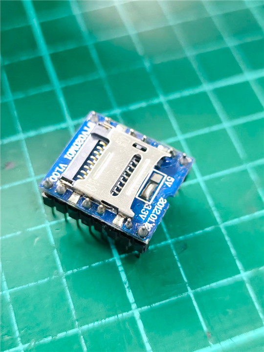

3. Arcade Push Button

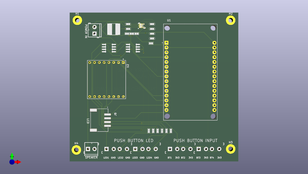

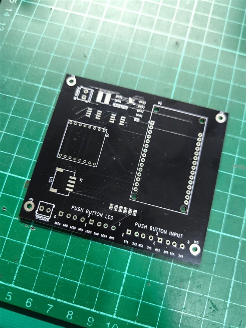

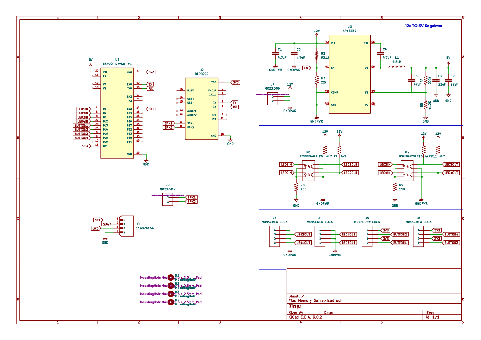

To interface all this circuit i have decided to design PCB board. For designing this, i have used KiCad. Below is the schematic

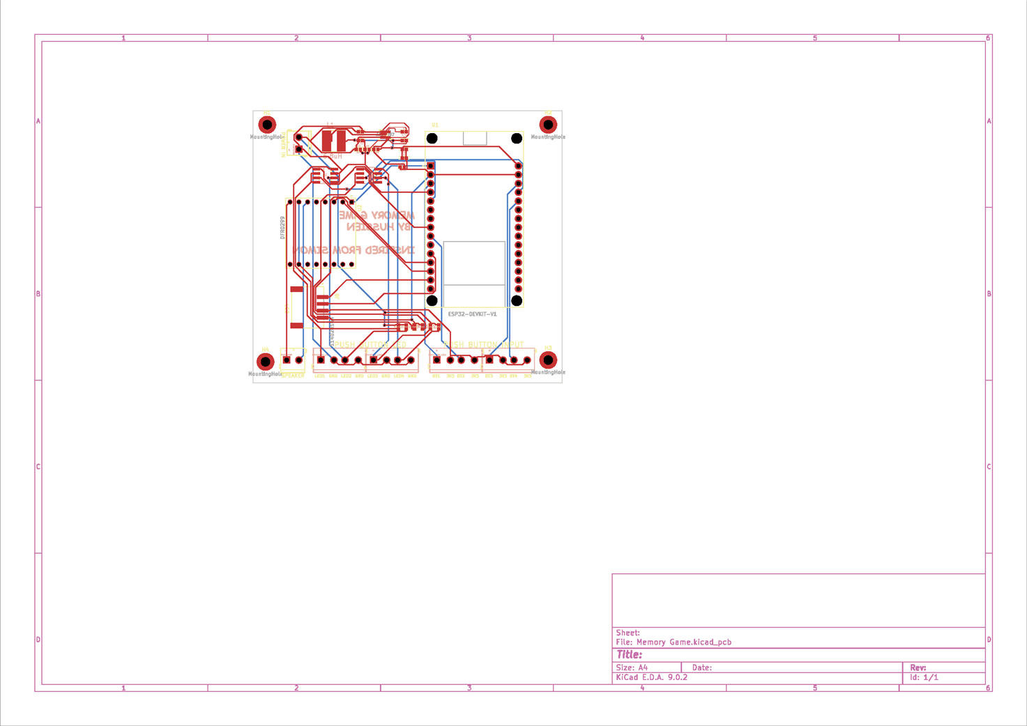

And below is the PCB layout
  The 3D Layout of the board
The actual PCB
Assembling The PCB

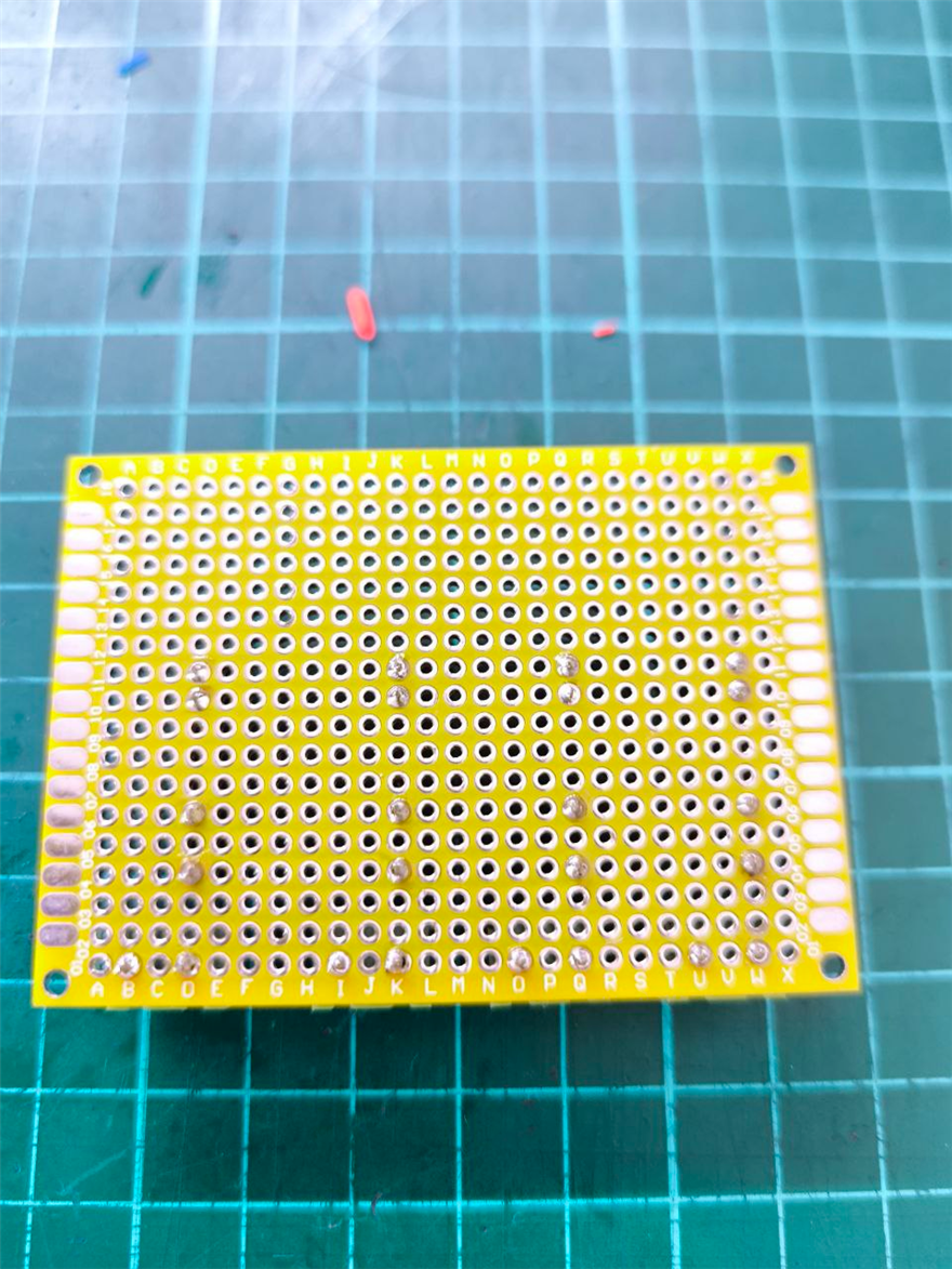

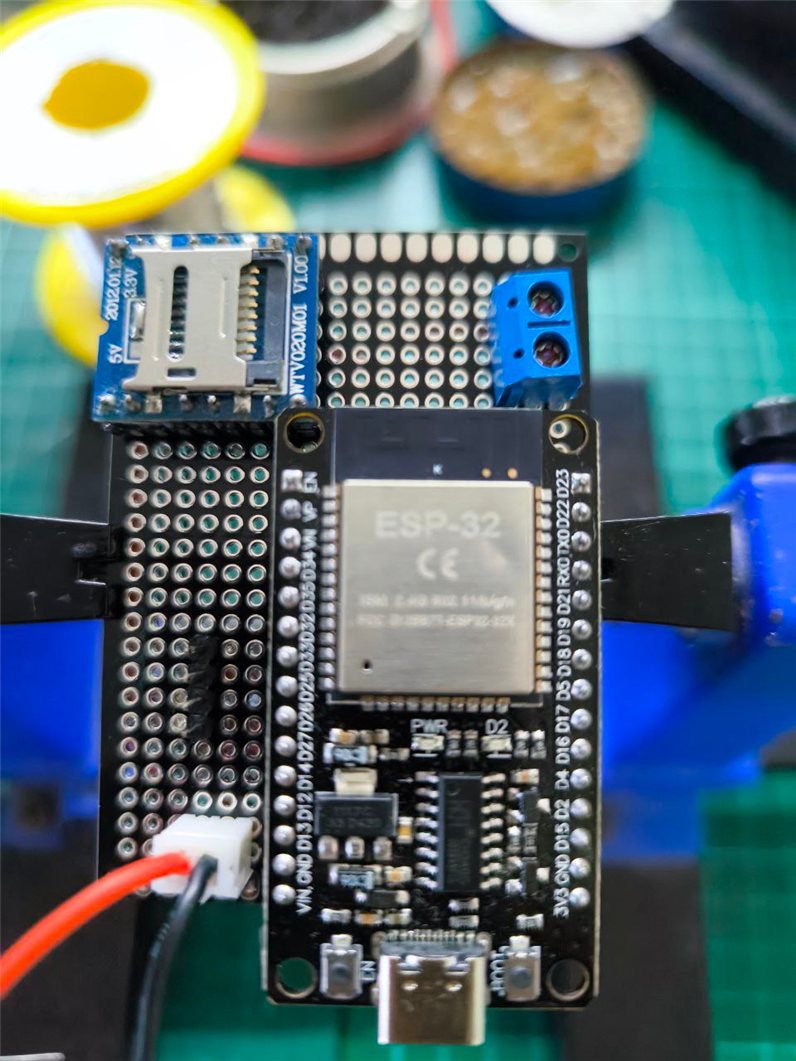

While i try to assemble to board i just realized the size of the component i used in my design is smaller than the one i have in hand. Hence i decided to use the donut board to to reconstruct the circuit.

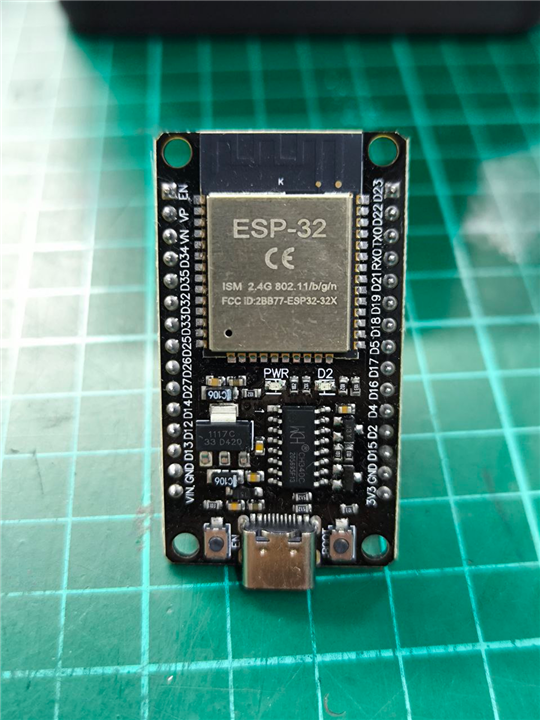

The placement of the ESP32
The placement of the MP3 module
The placement of the voltage regulator
The back view of the board

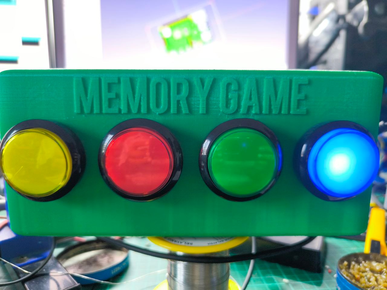

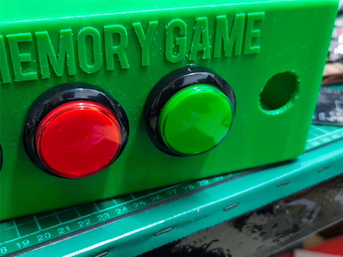

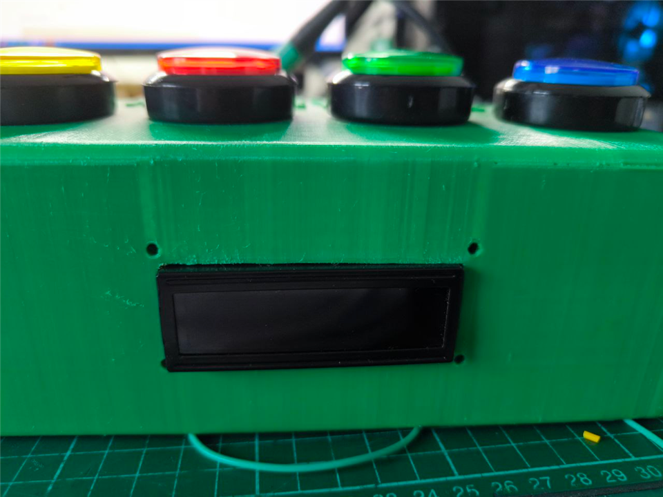

Enclosure Design
For this project i think of making an enclosure that will be robust for the kids to play with. Hence i don't want to make  a small enclosure, i decided to build one that the kids can hit the button rapidly.
For designing this, i have used TinkerCad.
This is the view in Cura
And below is the printing video
Interfacing

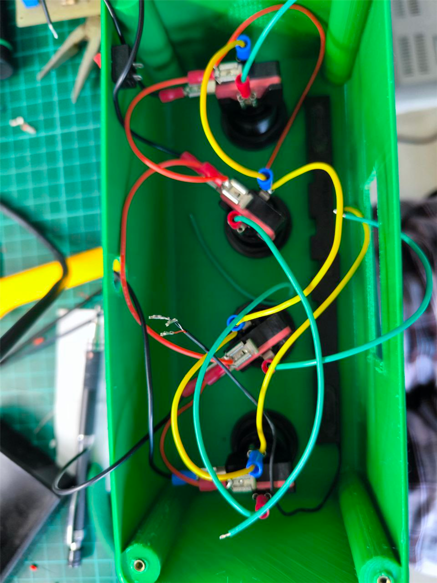

Once the board is done, next is the assembling the board to the enclosure.

Due to the PCB board issue, could not finish the project in time. Will keep posted once i have completed this project.
  • meera_hussien
    meera_hussien 7 months ago in reply to arvindsa
    I agree. I should have confirmed the component sizes earlier. Anyway, it was a lesson learned.
