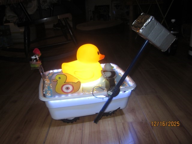

PREAMBLE:  For STEM events in the community and schools, I build novel electronic projects, often robotic vehicles of some sort, to engage kids first to have fun playing with them, and along the way inspire their imagination for being creative, start building gadgets and contraptions of their own (secretly awakening the subconscious KNACK & aiming folks down the path of engineering) .
This is one of those unusual projects, built for a robotics program at a for fun nerdy scifi/mystery convention. This convention focuses on fantasy discussion panels, fiction book authoring, film writing and production, and cosplay. The robotics program is a rich complement to the other convention programs as ours includes alot of hands on items.
Our theme this year was Ducks with Hammers, as 10 years ago, our robotics club did a presentation with alot of amazing autonomous robots. For fun, the club founder had thrown together an RC robot in about 10 minutes with spare parts. The robot was radio controlled using two continuous servos and a meat tenderizer mounted on another servo, with a rubber duck glued on top. That robot was by far the favorite of every youngster who attended our program that year. We celebrated that discovery this year by using it as our theme.
THE PROJECT:

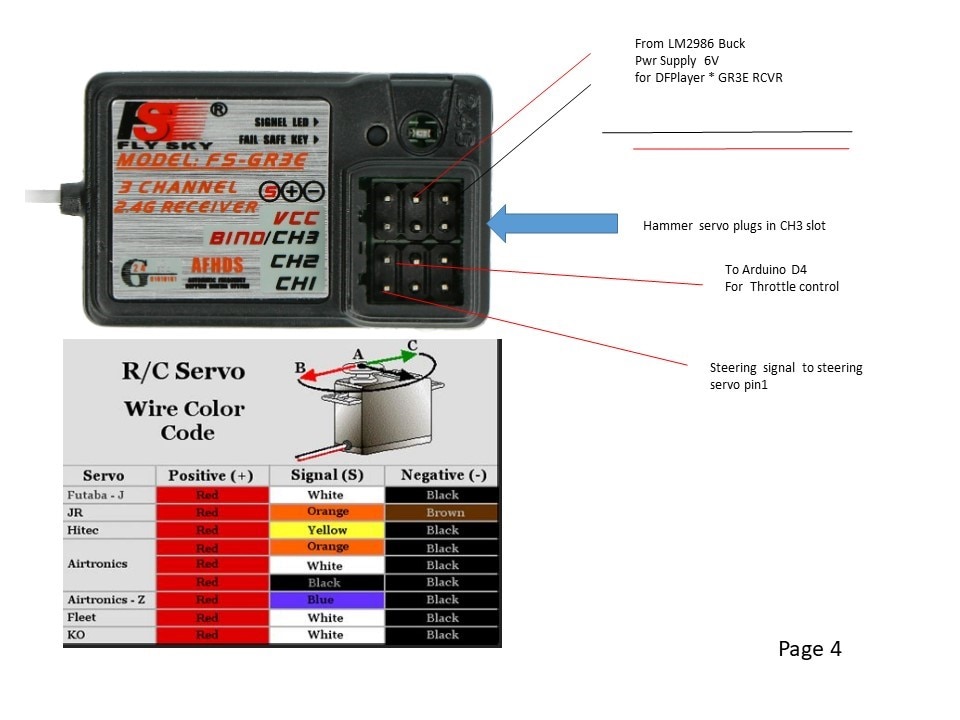

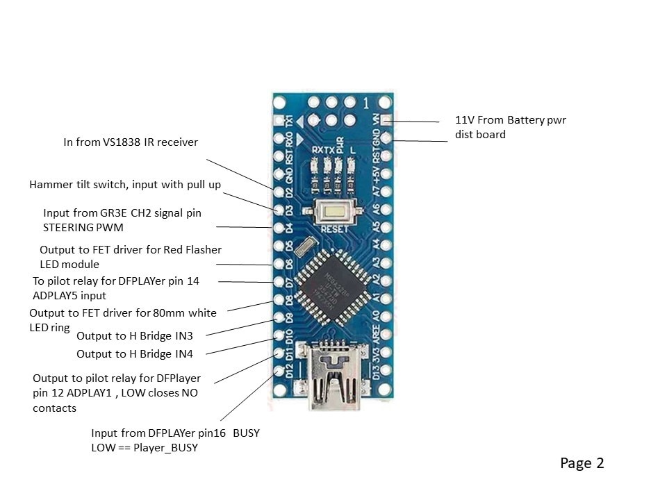

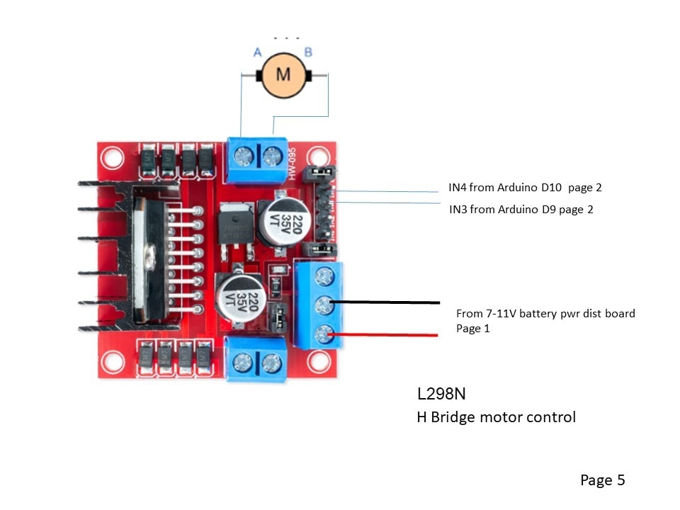

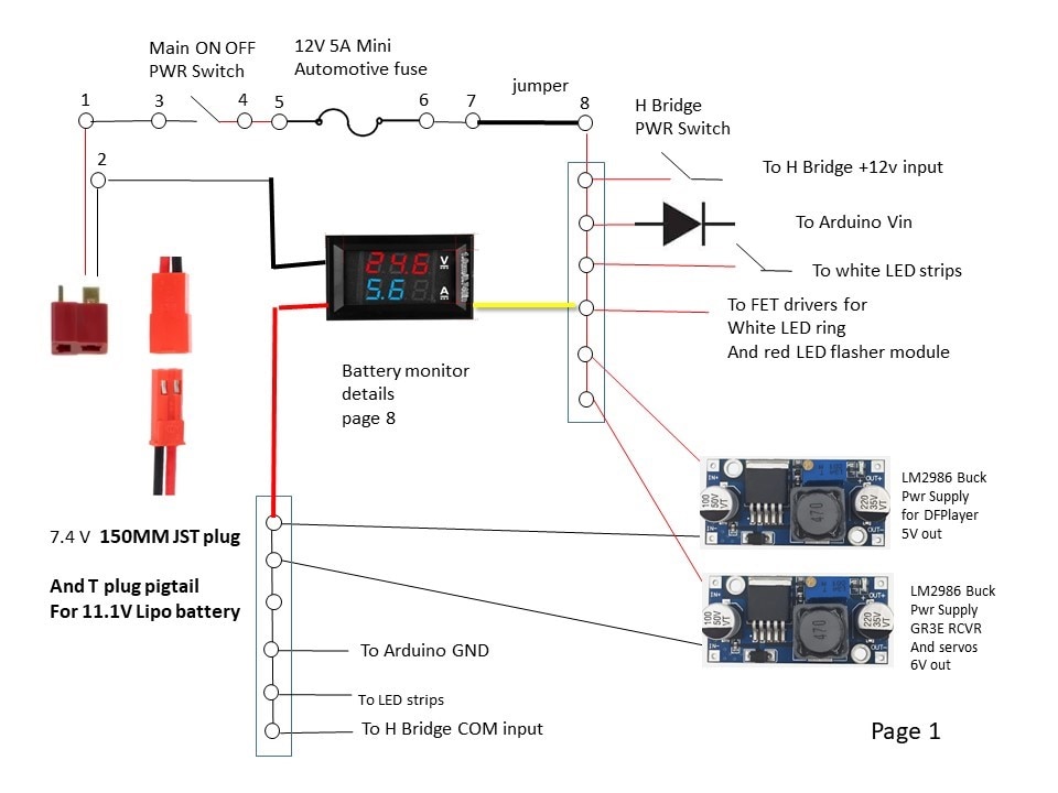

The RC Hammering Duck in the Tub is a radio controlled truck chassis using an Arduino Nano to translate the radio receiver's throttle PWM signal to a 100% duty PWM signal & direction bits to control the H bridge.

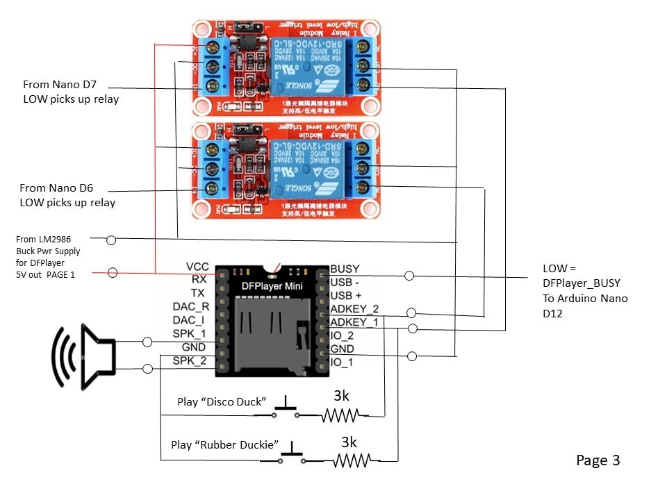

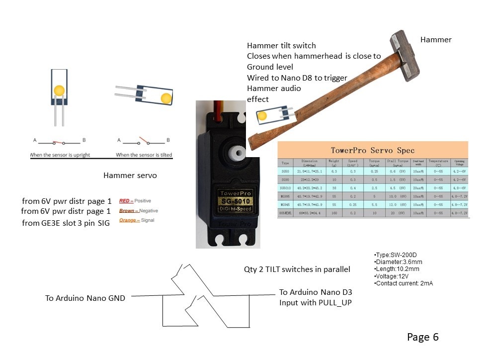

The Arduino Nano also controls a DFPlayer Mini for the sound effects. 2 hidden pushbuttons can play "Rubber Duckie" or "Disco Duck."
When the Duck throttle is engaged, the duck quacks by looping a DFPLayer audio track.
When the hammer swings, a tilt switch wired back to the Nano will fire the HAMMER IMPACT audio file on the DFPlayer.
The Hammer servo is controlled by a third channel on the RC transmitter/receiver.

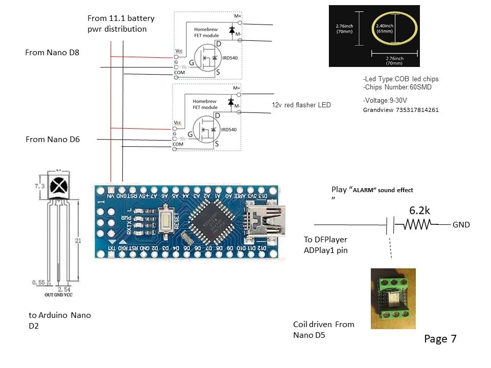

An IR receiver sits in the bullseye of a duck target. If an IR 38kHz burst is detected, the white LED ring under the duck shuts off, and a flashing red LED turns on. The DFplayer audio sounds an alarm and the H bridge is locked out for 10 seconds.

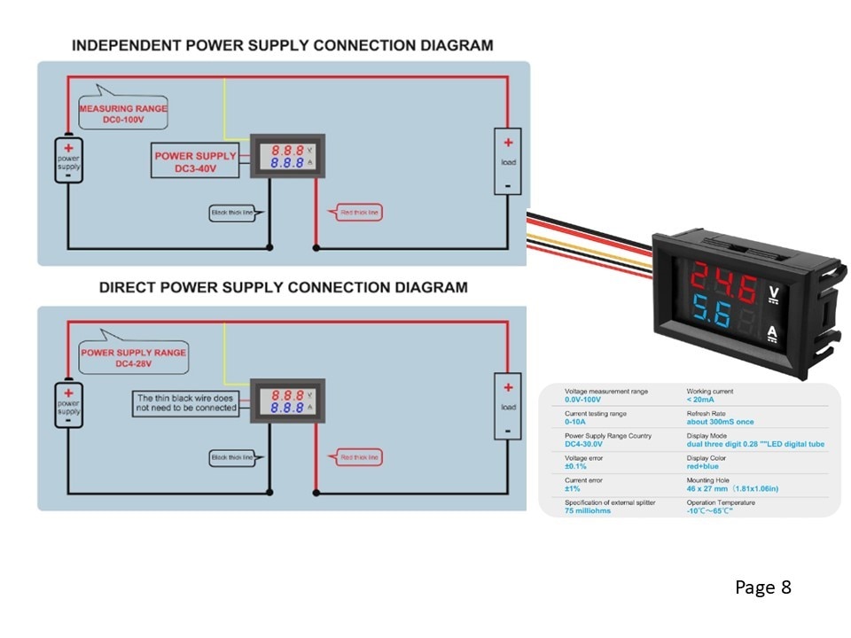

The design includes a main fuse, a main power switch, and a motor power switch so the Duck can be turned on without any chance of the wheels turning. There will be several buck P.S. for 11V to 6V for servos and 11V to 5V for DFplayer.
The  OPERATIONAL PROJECT VIDEOS:
https://youtube.com/shorts/bxuNUurVbYg    this video was taken at the scifi convention with a youngster playing/controlling the the Duck with Hammer while Im explaining some features.  I didnt get a ton of video as we got busy with the crowds in attendance. This video is totally unedited as I have Codec issues between different video platforms.
https://youtu.be/wvT1RfBScMA      this short video was taken at the homeschoolers robotics class where I was the special guest speaker demonstrating and explaining the RC Duck with a Hammer as one type of robot project.
RC Rubber Duck with a Hammer photos:
The Rubber Duck With Hammer wiring schematics:

The Challenges and improvements:
Scope creep and spec changes haunted the RC Hammering Duck.
• Murphy's Law - plenty of spare IOs to start out => digital IO is used up.
• No matter how many power distribution points are provided for power supplies and grounds to eliminate daisy chains, there arent enough. Add more, not enough again. Put some daisy chains in the wire harnesses, still run out. arrgghh
• In spite of strategically placed blocking diodes, when I downloaded new code with main battery power on, opps, the electrons found a sneak path thru the IO and buck power supplies and the Arduino Nano let out a nice cloud of smoke. Luckily only the Arduino suffered as a sacrifice to the project gods.
The Rubber Duck is too heavy. The poor little 7V motor is running at 3A to rotate at 11.3V.  The 11.1V Lipo battery full charge volts are about 12.4 , and quickly drops to the nominal 11.1V where the battery delivers the majority of its power.
The batteries have alot of their power left when the voltage drops enough for the motor to stall.
  There are about 400mA being drawn by lighting LEDs. The LEDs were added to help the Shark Chase Tank's PixyCam. These LEDs are no longer needed once the PixyCam object detection is upgraded to YOLO.
The driver/operators tend to immediately hit the full throttle when driving the RC Duck with Hammer. There is a slight exponential ramp built into the controller throttle, only active around zero. Adding a rate limit to the throttle PWM Duty cycle will help prevent full voltage slamming the DC motor.
An accel/decel ramp should be even more effective to subdue the motor volts slam, however there is no room on the RC Duck to add a wheel encoder to calculate speed feedback. I'm thinking to also add a current feedback sensor to the Arduino to build a CEMF regulator ( cheap and dirty speed regulator) for the motor. A linear ramp would be applied to the throttle signal as a speed reference, the PID derivative component could be tuned to provide acceleration current.
The RC Rubber Duck with Hammer had a shark chase vehicle. I'll publish that as a second project in this competition.
