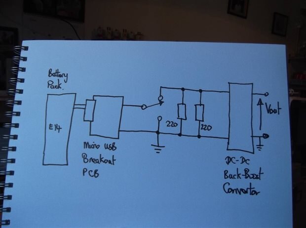

Having completed and glued together the battery holder to the prototyping board I have now created a functional working prototype. The cable from the E14 battery pack has been plugged into a micro USB breakout PCB to gain access to the power connections. I have not cut the micro USB plug off the battery pack so that I can still use it as a mobile phone charger should I want to at some time in the future. In order to make the battery pack work continuously a minimum current of approximately 50 mA must be taken and as the battery output is about 5 V this means a resistive load of 100 Ohms. As I do not have any 100 Ohm resistors I have used two 220 Ohm resistors in parallel which gives me the 100-ish Ohm resistance, with the added benefit of twice the heat dissipation. As this load has to be taken when in use then an ON/OFF switch is also required otherwise the battery would not last very long. The two resistors and the slide switch have been soldered together on a piece of stripboard which isn't that pretty but it is functional. The switched battery connection is then made directly to the input of the DC-DC convertor with soldered connections - mainly because the micro USB connector fell off when I was playing around with it -  a drawback of surface mount micro USB connectors. The circuit diagram is shown below.

    Looks like a useful project. Your diagram makes it look like on of the switch positions shorts the battery output to ground. I'm hoping that's just a mistake in the diagram rather than your circuit.
    dubbie over 6 years ago in reply to Fred27
    Fred,
    Well spotted. Just a slip of the pen as I was drawing in the lines for the two resistors, the ground connection ot the switch isn't there. If it was I'd probably need a new battery!
