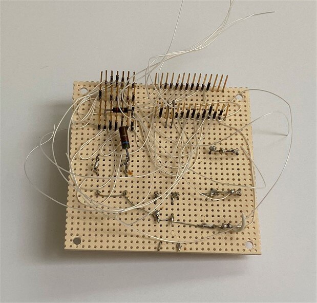

Since it came out of my junk box and seemed to be in poor condition I thought that I probably should have proof of life before I invested too much effort in restoring it.  I was somewhat surprised that the 30 AWG wirewrap wire that I had used had oxidized and become brittle.  Some of the wires were actually broken.  I still use 28 AWG wire of the same vintage and the unused wire seems like new.  I guess maybe the wire may have reacted with the metallization of the wirewrap pins.  Anyway, I decided I should rebuild the circuit from scratch - just reusing the ICs and the crystal.

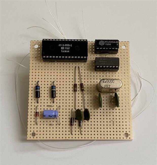

Top of the board:
  • Pong chip AY-3-8500-1 (-1 for NTSC)  Date code 7707
  • 4072 CMOS Dual 4 input NOR
  • 4001 CMOS Quad 2 input NOR (might be a 4011 Quad NAND - can't read the marking)
  • 2MHz crystal
  • 6.3V zener - I had used 9V batteries for power (I probably could have run the parts directly but the typical voltage for the Pong chip is +6V to +7V)
The bottom of the board:  You can see the blackened wire ends wrapped on the pins.

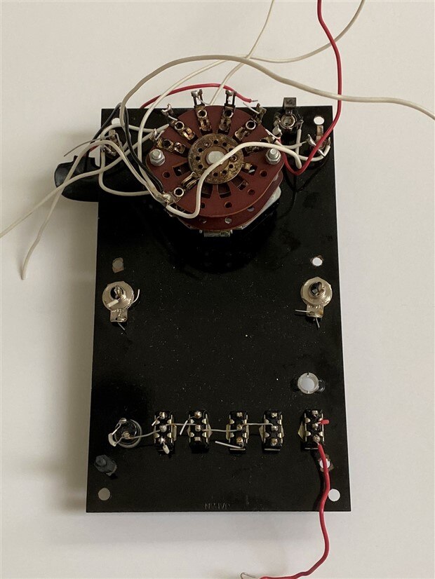

Switches and jacks viewed from inside the case:

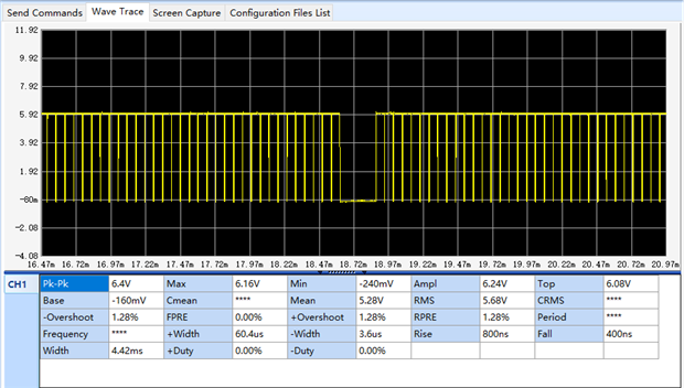

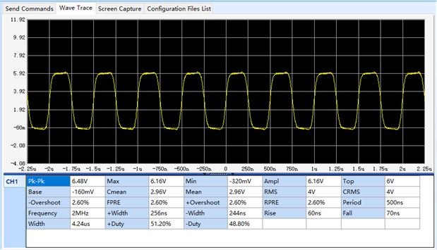

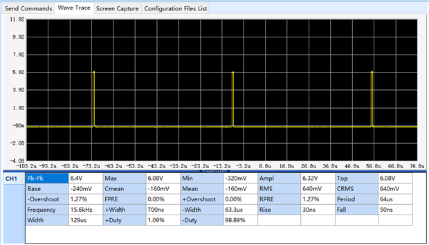

To verify life I thought that I'd just power it up and verify the clock circuit and that the video sync and composite outputs were working.
2 MHz oscillator waveform:
Video sync:
Composite video:
So looks good to proceed.  Hope to have a functioning game soon.  I just realized that I'll have to scare up a composite monitor......

    Hi Ralph, This looks like fun. Another cause of the blackening might have been storage. Some papers and other materials will have a small amount of sulfur compounds which can cause blackening. Even if…
