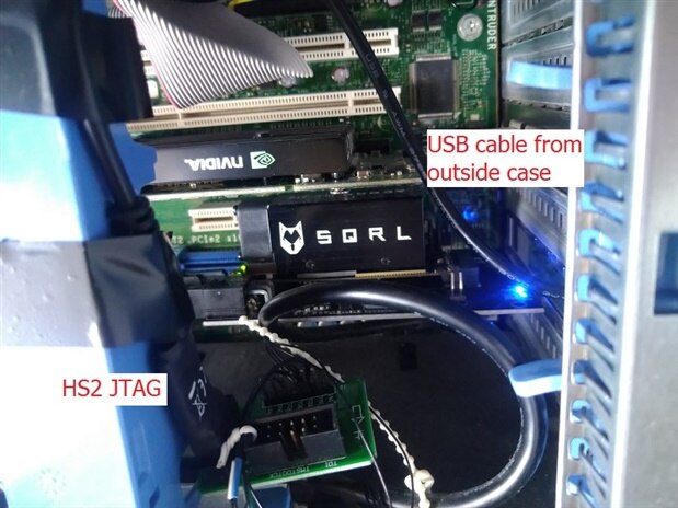

My main desktop is a small-ish form factor machine running Windows 10. Luckily I had a slightly older tower PC that had much more room for PCIe board. Whilst the SQRL board isn't tall, that large heatsink does make it awkwardly wide. Talking of which, how would it ever be possible to put this in the m.2 slot of a laptop? It might just about fit with the heatsink removed, but I suspect that taking any advantage of the power of the onboard Artix-7 would cause it to overheat very quickly.
So I installed the SQRL board and its PCIe carrier inside the desktop. This wasn't too difficult but I didn't want to give up JTAG, so I have the rather strange configuration of a USB cable connected to the PC and snaking back inside where it connects to a Digilent HS2 JTAG programming cable that's taped to a convenient rail. Obviously the primary use case for this device is where your bitstream is loaded in from flash and you interact with it over PCIe. That's all fine once you've finished developing the PL, but I still need JTAG for a little while longer.

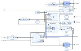

Luckily the documentation for the NiteFury board included a PCIe example block design and some basic instructions for getting Xilinx's XDMA driver installed on Linux. The block design synthesis and was transferred over to the device without a problem. The driver side however was a little more tricky. I thought that Vivado was a bit touchy about versions, but the XDMA drivers were even more so. There were so many gotcha that required quite a bit of searching, and you have to wonder why some of this wasn't included in the Xilinx-supplied instructions.

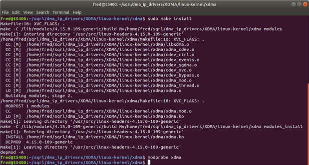

Firstly, a signing key was missing so the drivers couldn't be compiled. I found the solution here, but it really should have been included. Things then got even stranger.
cd /usr/src/linux-headers-$(uname -r)/certs
sudo openssl req -new -x509 -newkey rsa:2048 -keyout signing_key.pem -outform DER -out signing_key.x509 -nodes -subj "/CN=Owner/"
The build got further but then complained about a missing 'System.map' file. More googling and rabbit holes later, it seems that not only is the version of Linux important, later kernels cause problems. I ended up having to revert the kernel on my Ubuntu 18.04 from 5.3 to 4.15. Considering I'm probably an 80% Windows / 20% Linux guy, altering the active kernel seems a bit out there. However, I managed it with the following:
sudo apt remove linux-image-5.3.0-59-generic
sudo apt remove linux-image-5.3.0-53-generic
sudo apt remove linux-image-unsigned-5.3.0-53-generic
sudo apt remove linux-image-5.3.0-28-generic
sudo update-grub
sudo reboot now

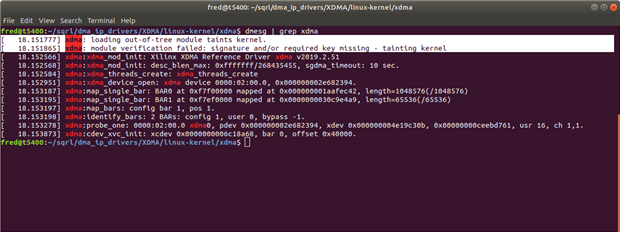

With the change in kernel (and hence the value returned by "uname -r") I had to redo the SSL cert above. I could now build the kernal module and install it!
Next is a quick test of communication between Linux and the FPGA. Unfortunately Linux is still not happy with the XDMA drivers. A lot of searching has yet to come up with a solution to this. There are other avenues I can explore, such as using Xilinx QDMA drivers under Windows btu considering that would need a whole OS reinstallation. Time constraints and other things I need to do (like a job) mean I will unfortunately have to leave it here for now.
