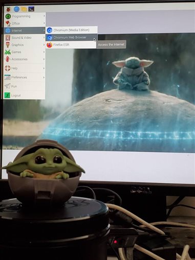

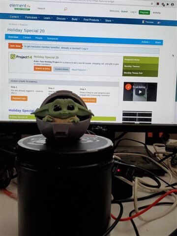

I took a smallish black cylinder/plastic canister with a twist off top and filled it's insides with the Raspberry Pi 4, connections for the USB Keyboard and mouse, power with a switch (you can see the red light next to the button), HDMI and an audio/speaker out cable.
I cut out a hole on the top to allow Baby Yoda a secure place to sit while using The Learning Stone as well as two access ports in the back for all of the cabling.
I purposely went with a minimal approach so as to encourage Makenna to make it her own.  I have provided various color led lights for her to drill into the canister and place and then be able to custom control them as part of the learning and programming of the RPi.  The canister itself is easy to cut into and we can add items such as a SenseHat or possibly a Google AIY Voice kit.  The driving force will be her desires and interest.
Here we can see The Learning Stone in front of a picture of The Seeing Stone and Grogu.

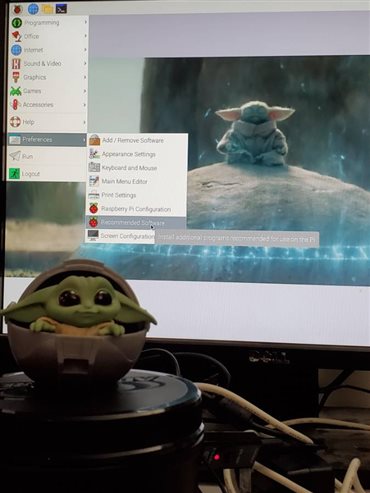

The old tiled Raspberry Pi logo was swapped out with a color background showing Grogu on The Seeing Stone.  Got to keep the motivation flowing!  This is The Way!

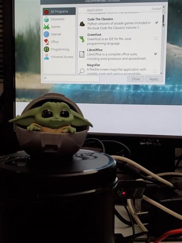

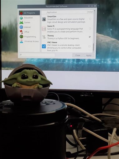

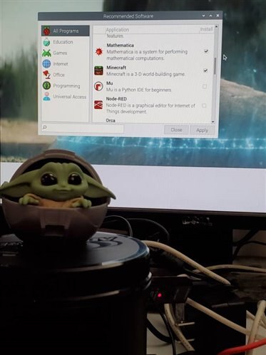

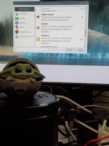

First we went into Preferences > Recommended Software to allow her to add some applications that she thought would be helpful.
Code The Classics, Python versions of arcade games included in the book Code The Classics Volume 1.  I have a feeling this book will soon be in her library.
LibreOffice, a complete office suite.
Mathematica, anything to possibly help with mathematical computations!
Minecraft, have to have this!
Python Games, more games written in Python to get her curiosity started and some code base to play with.
Scratch 3, we have played with this in the past and added it so she can go over any of our older Scratch books if she wants.
Thonny, a Python IDE for beginners.  We will research some more what might be best for her but added this to start.

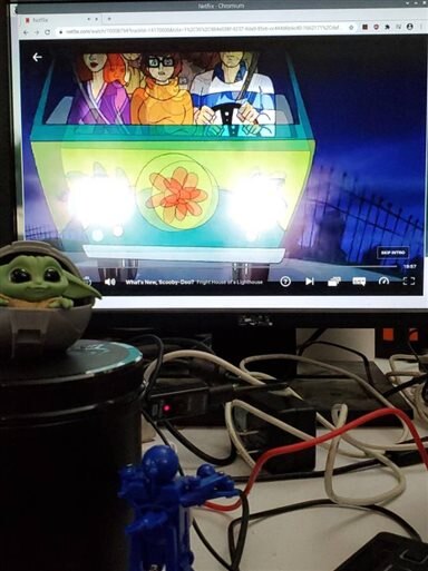

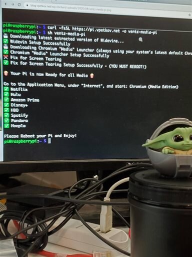

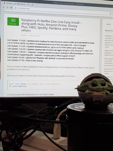

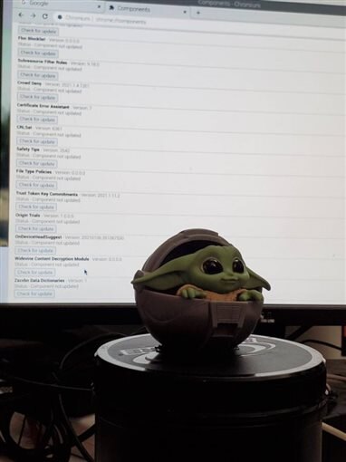

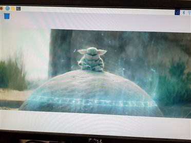

So one thing she wanted was the capability to be able to go to DisneyPlus or Netflix and similar streaming sites and actually stream videos.  By default the Chromium Web Browser will allow you to connect but will not allow the playing of videos due to DRM issues.
The issue seemed to point to the Widevine Component which ARM has problems with.  Reading that Firefox might have a work around I installed that and still no go since you have to install the Firefox ESR version for ARM.  So more research was called upon...
Enter Mr. Veselin Petkov and his blog at blog.vpetkov.net.  He has a Media version of Chromium that fixes the issues!
By entering curl -fsSl https://pi.vpetkov.net -o ventz-media-pi and then following up with sh ventz-media-pi you should get the following:
Following the Reboot command you should then see Chromium (Media Edition) under your Internet options!  This does work!
Here you can see Scooby Doo on Netflix being tested.

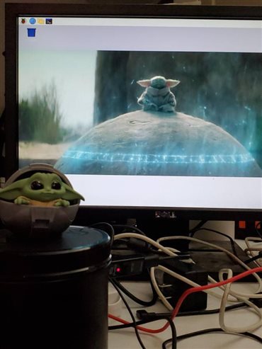

Be sure to view the video at the end of this project to see a bit of The Mandalorian Season 2 Trailer from DisneyPlus running with audio and no lag/glitching.

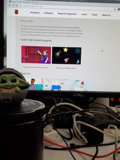

Here we have one of the first bookmarked sites in her Programming area:  raspberrypi.org/hour-of-code/
We will be expanding this as we find things that catch her eye and keep her interest.  Feel free to offer suggestions in the comments and we will check them out!

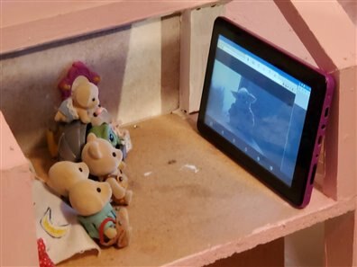

Remember I mentioned the OT2NPM project being implemented with her old tablet to bring technology into her dollhouse?
Here she is setting up the GIANT dollhouse wallscreen that is currently VNC'ed into The Learning Stone and showing part of the ever popular Mandalorian series.
Here we have "most' of her Calico Critters and Baby Yoda watching the show.  You can see the baby Calico Critter perched upon the top of the Pram for Grogu.

And finally I have included the video showing the successful streaming of part of The Mandalorian Season 2 Trailer from DisneyPlus.  This should include audio although you may have to turn yours up a bit since I was using a low power speaker during the video filming.
