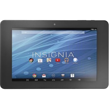

I have been collecting an assortment of old tablets from my kids and wife (as well as myself) as over the years we have upgraded.  The tablets of course still worked but the technology and android versions were outdated enough that they were not viable for up to date use.
For this E14 Project I will take an old Insignia 8" Flex tablet.  Back in the day it was quite the cool piece of hardware.  Model NS-15T8LTE.
With the following:
Android 4.4 KitKat:Offers on-the-go reliability.
8" IPS-LED capacitive touch screen:With WXGA (1280 x 800) resolution showcases your favorite movies, games, photos and other media in crisp, striking clarity and lets you accurately navigate features.
8GB eMMC memory:Delivers ample storage space for your media files, documents, apps and other data.
Quad-core processor:Rockchip RK3188 Cortex A9 processor with a 1.6GHz processor speed and 1GB DDR3 RAM ensures fast, reliable performance.
Wi-Fi (802.11a/b/g/n) + 4G LTE speed:Provides fast Web connection for downloading apps, streaming content and staying connected with social media.
Bluetooth 4.0 technology:Lets you easily pair with an enabled device.
5.0MP rear-facing camera:With autofocus, as well as a 2.0MP front-facing camera, allows you to capture images while you're out and about.
microSD slot:Allows storage expansion up to 32GB with a compatible card (not included).
Built-in GPS:Helps you locate desired locations.
Mali 400MP4 graphics:Support reproduction of dynamic, lifelike images.
G-sensor:For enhanced functionality.
Built-in stereo speakers:Provide lush, robust sound. The 3.5mm stereo headphone jack lets you privately listen to your music through a connected pair of headphones (not included).
But considering we are currently running at Android ver 10 you can imagine that this beast is less then a powerhouse anymore.  If I remember correctly this model came out back in 2014.

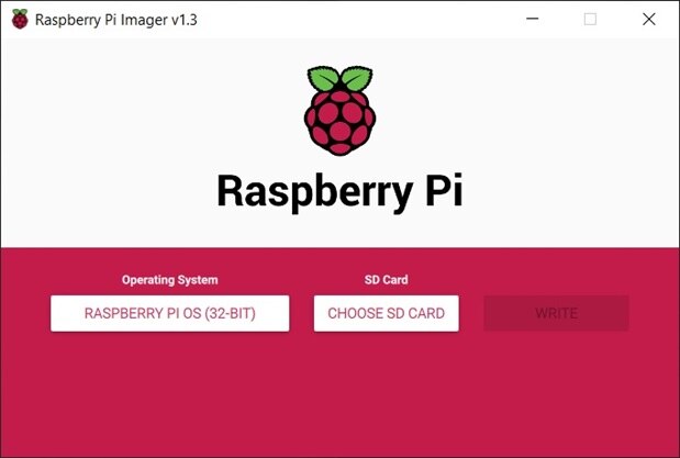

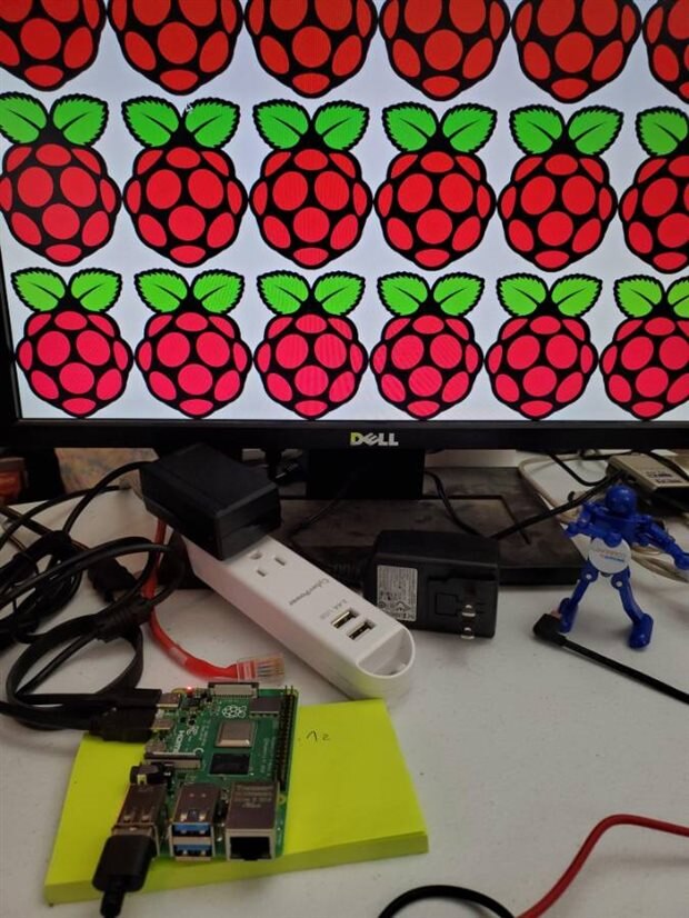

After running out and buying a new 32 gb Memory card I went with the Raspberry Pi Imager to load the card.
This was quite simple and provided a solid base to work with.

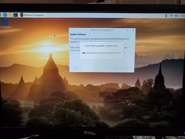

Now to set up everything in a controlled environment I used a monitor, keyboard and mouse.  I had access to wired as well as wireless internet but for simplicities sake decided that using WiFi would be the smoothest process to use.  Both the Tablet and RPi4 were on the same WiFi AP using DHCP addresses.
Bootup and setup was very smooth and it went right into Updating Software for me.

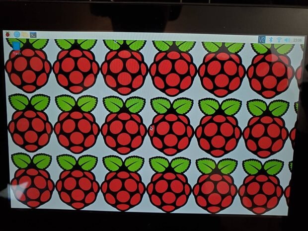

Here is the basic setup, as you can see I changed the high res pic to a more Pi type look.

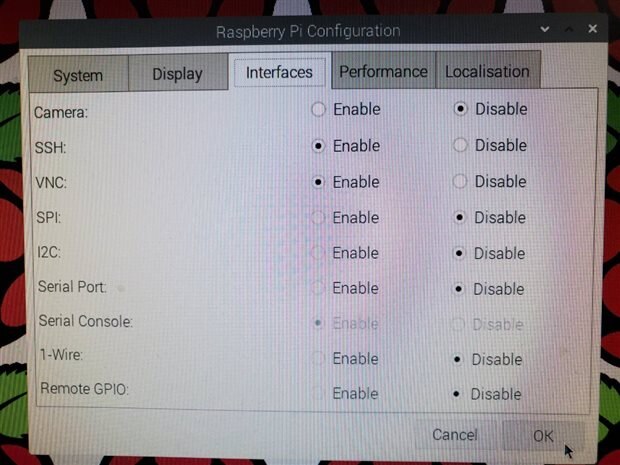

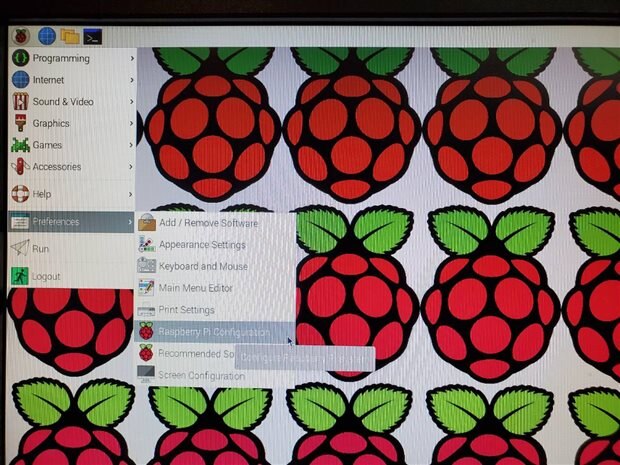

Since I wanted to run VNC as the connecting application I did go into Preferences > Raspberry Pi Configuration > Configure Raspberry Pi system.
From there I switched over to Interfaces and clicked on VNC and SSH (I didn't actually use SSH but I did enable it), then clicked OK to have it all ready for my tablet.

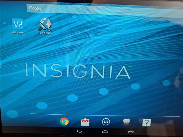

On the tablet I went to Google Playstore and downloaded the VNC Viewer and the Ping&DNS applications.  Both which can still be found and work with KitKat OS.
I should also state that prior to this I did a full factory reset to default for the Tablet to clear everything and start from a clean system.

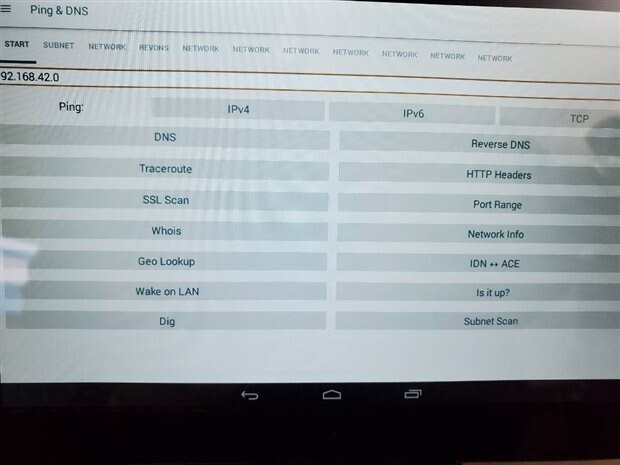

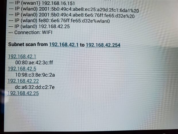

Why Ping&DNS app?  Since I am using DHCP for both systems and in the beginning I was trying to learn as much about the tablet as possible this application provided a good amount of various information.  This even will allow you to see all of the local network info if you are doing Bluetooth or tethering.
As you can see I entered the 192.168.42.0 address range since that was what my AP was working with.
I do apologize for the pictures/video quality of the tablet in use.  The tablet has a very high reflective/gloss screen and makes it troublesome to cleanly gather pictures/video.

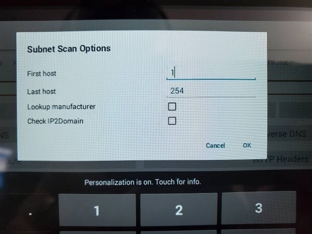

Choosing the subnet scan option and having the defaults pop up I clicked OK.
You can see my Tablet was running with the .25 address and I can see the RPi is currently running on .22 address since I noted the dc:a6:32 Mac notation.  This could be a problem if I had multiple RPis on the network but this is my only one.

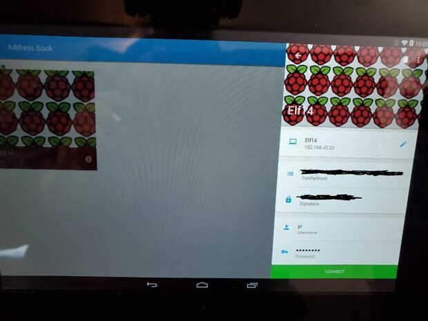

So now we have a target IP address for VNC to connect to:  192.168.42.22.  We could set the RPi4 to a static IP but I was once again going for simplest route with maximum flexibility if I were to move the system to another AP/area.
Here you can see I have already setup my connection, but you would add to the address book providing the target IP with a name, and username/pw information.
We then click Connect...

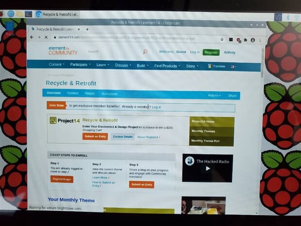

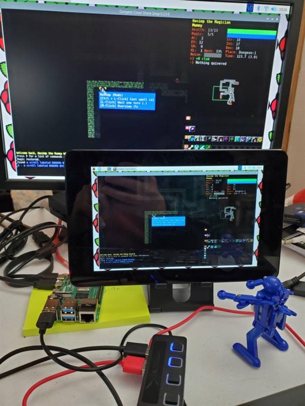

And quicker then I could snap a picture we connected over to the RPi4 via VNC and are mirroring the monitor!  Very fast.  I like it!
A quick navigation via browser and we can see our Friendly Neighborhood E14 website with the Recycle & Retrofit up to display!  All through the touchscreen tablet.
Here we can see both the Tablet and full monitor showing the game Dungeon Crawl Stone Soup.
