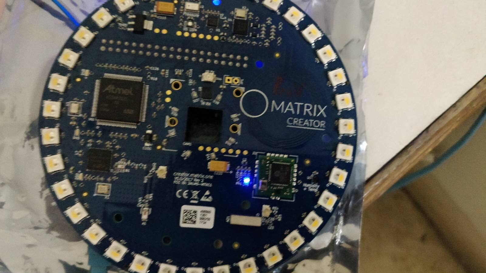

Hardware Required:
  • Matrix Creator // A wonderful board, with sensors and microphone array(x8) and FPGA  //Matrix Voice will also use the same code
  • Raspberry Pi 3A + //Any RPi >2B will work
  • A USB cable, Keyboard, Mouse, Computer, etc.

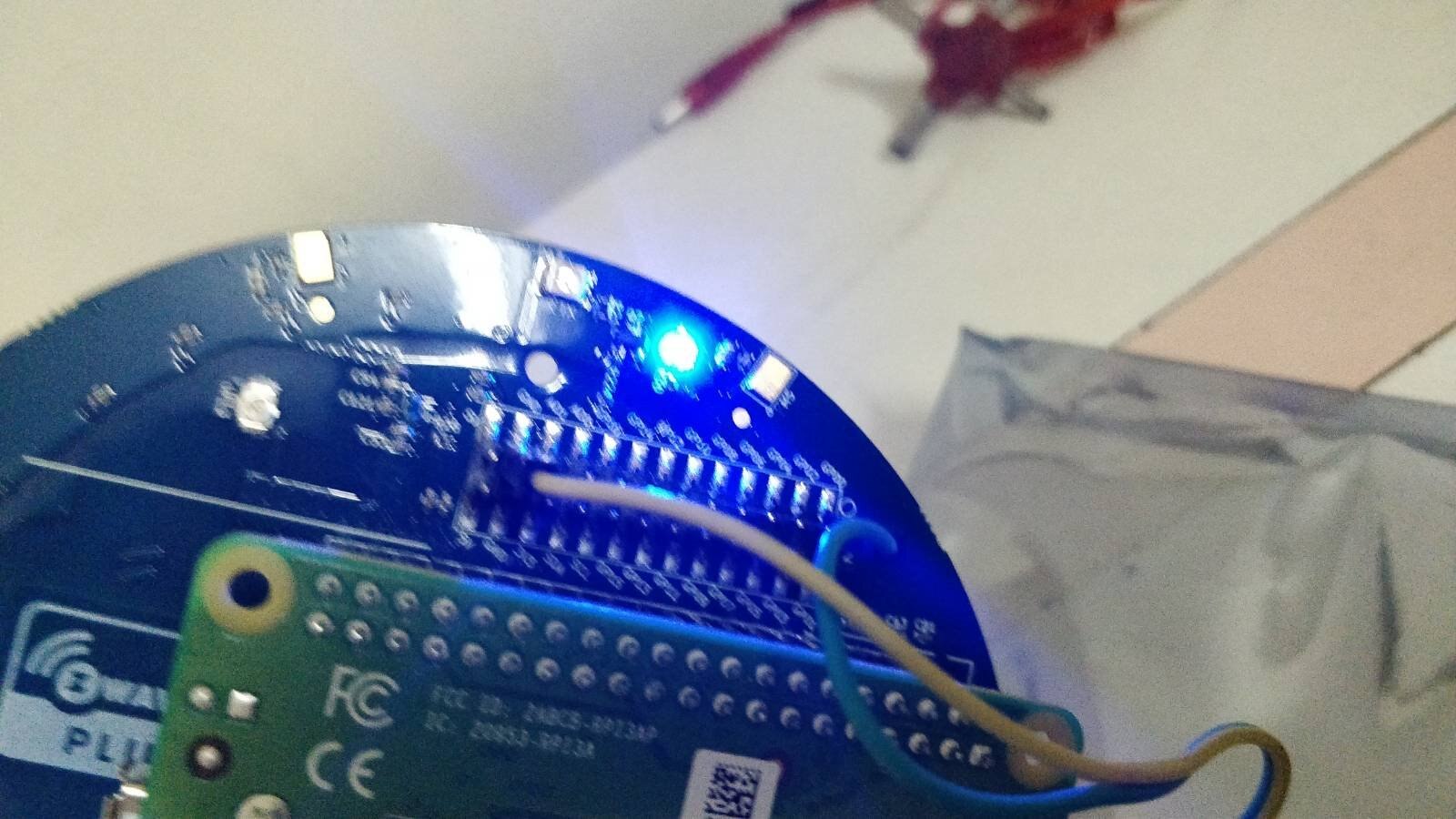

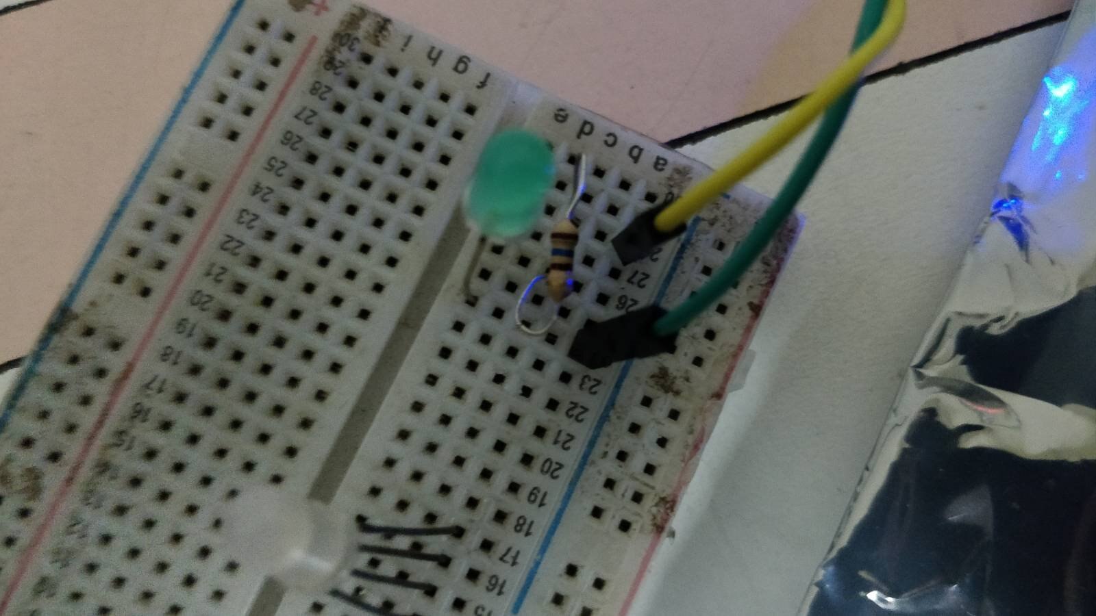

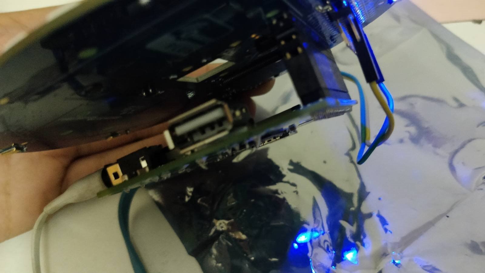

You just need to connect Matrix board to RPi, other connection of Relay and LED, etc. is pretty simple on a breadboard. And other co-controllers will be on a network.
All the different connections.

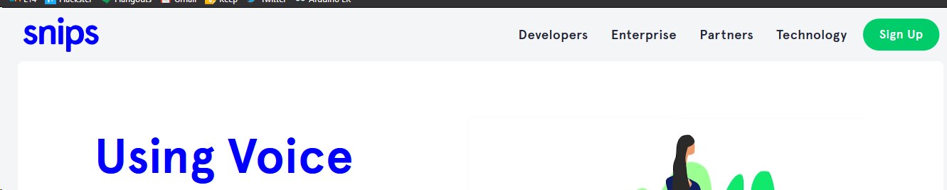

Snips.ai
Why?
Snips is an offline assistant that you can make and then use. Recently it is gaining popularity and there are a lot of sources of information using it in the community.
It is pretty simple to use and the Website is also very great!

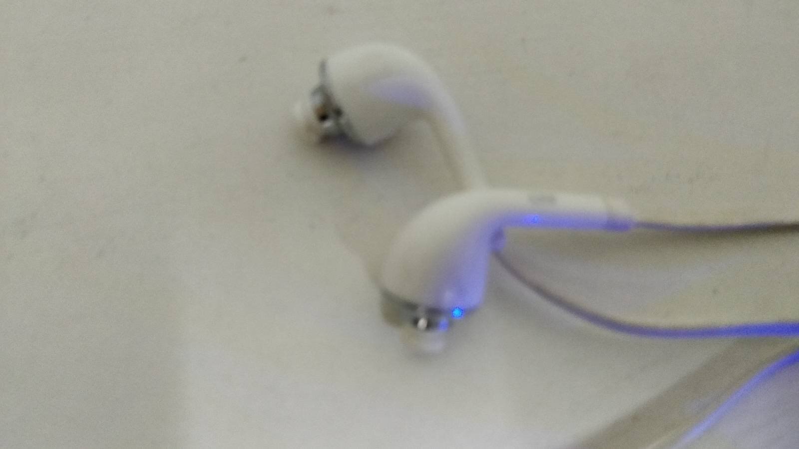

The headphone (connecting speaker is recommended) My speaker did not have an amplifier so RPi signal was not heard at all.

Go to https://snips.ai/  and click on sign up (if new).

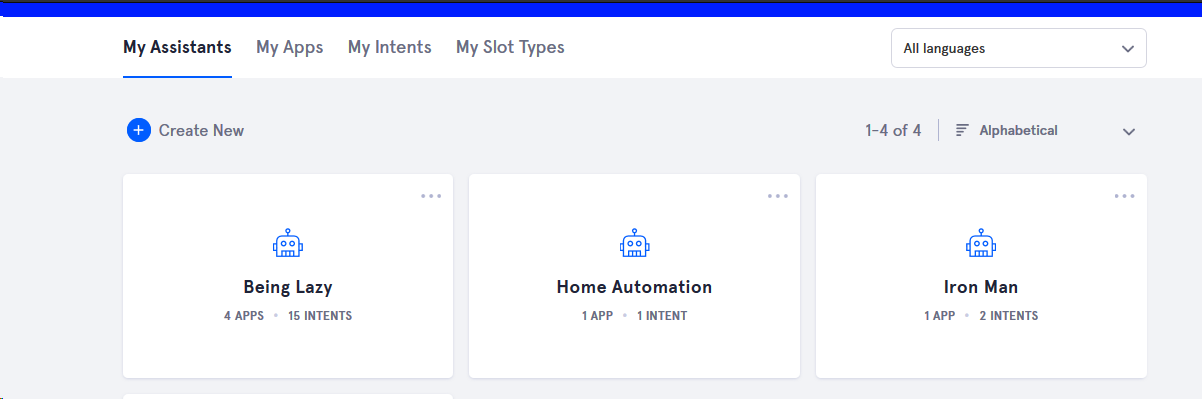

And log into the console. You will not see any assistants if new.

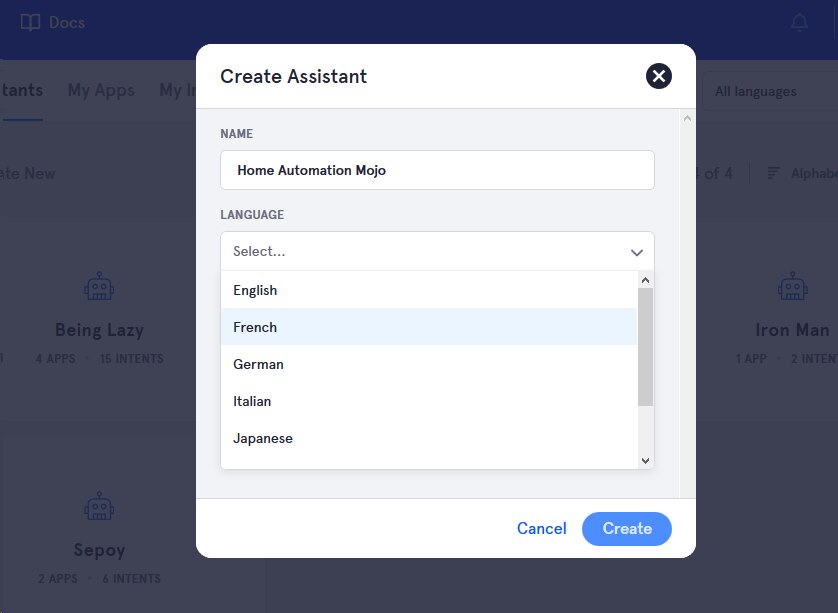

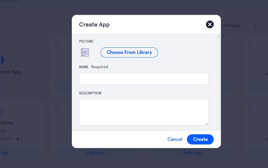

Select Create New and the fill the details and press Create
To fully configure the snips follow the images below.

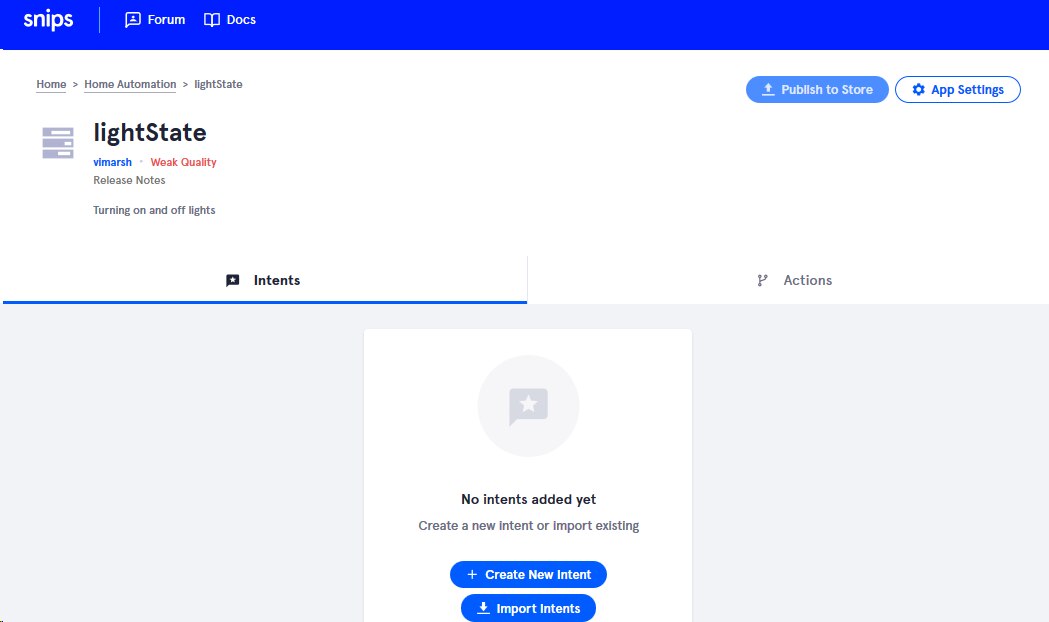

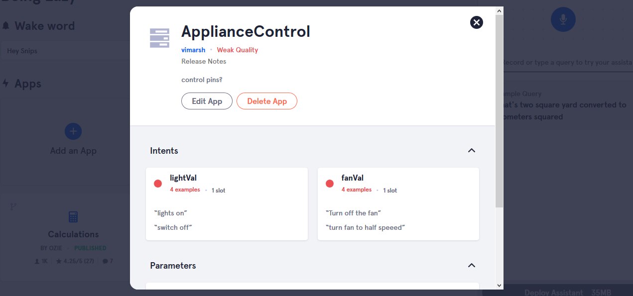

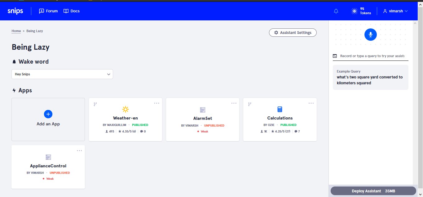

Add the Apps to the Assistant.

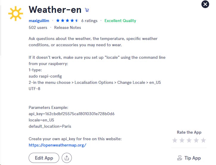

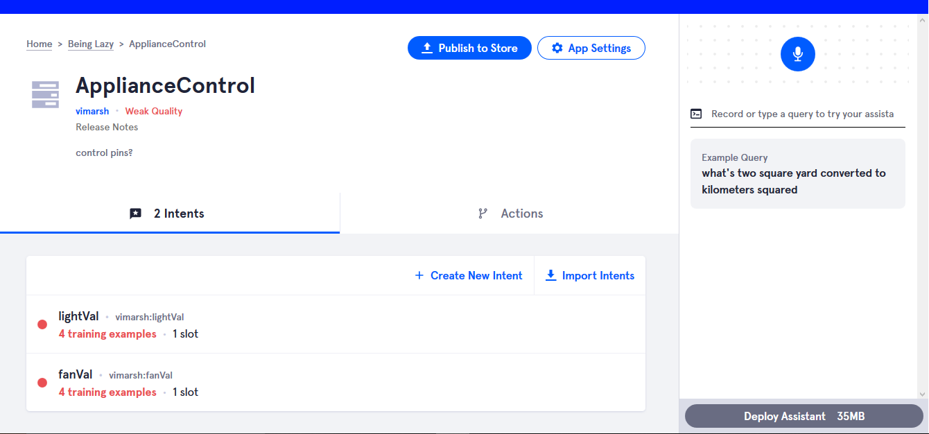

Click on add App and add apps Calculations and Weather_en. You will have to make a custom two Apps.
Select the new App and fill in details and click on create. Then select Edit App and you will see no intents added yet.

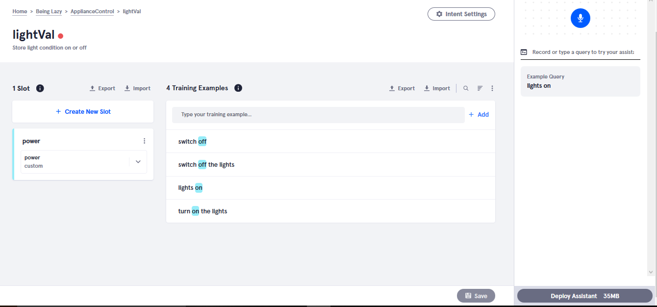

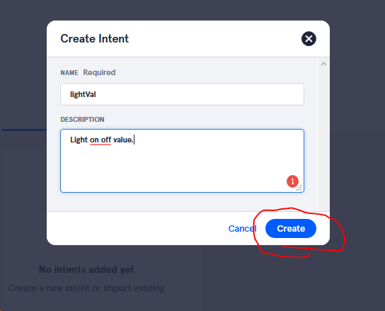

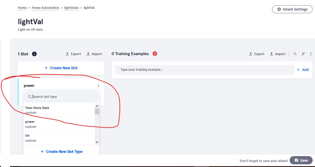

Create new intents lightVal and fanVal.

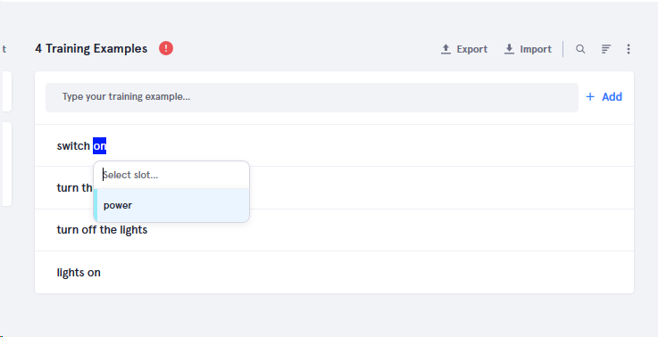

Create a new slot named power (you can make other but change it in the code) and add training examples.
Add a few training examples and then double click on the variable word and select the slot. Here on and off must be selected for power. Do this for fanVal also.
See the next images for configuration.
After doing all the app must have lightVal and fanVal.image
Info on than intents.
lightVal configuration.

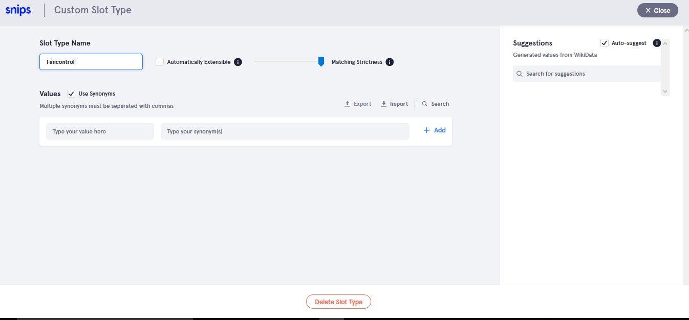

Making a custom slot type and slot.

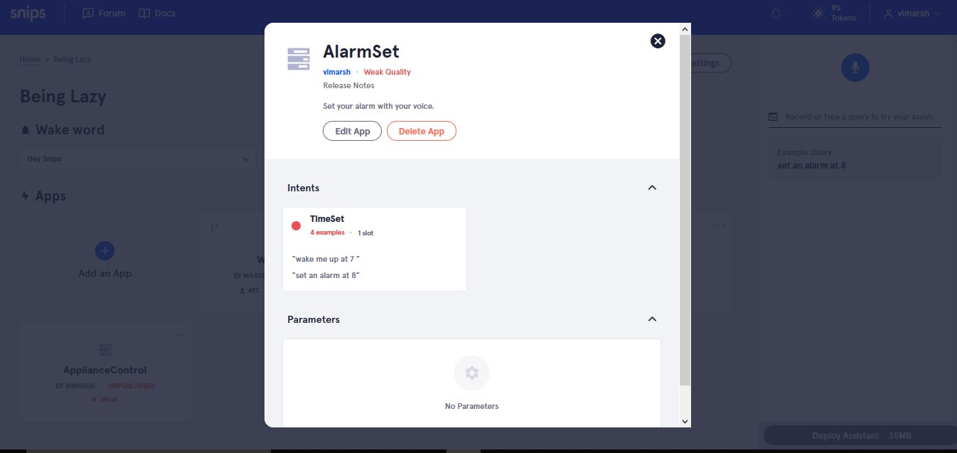

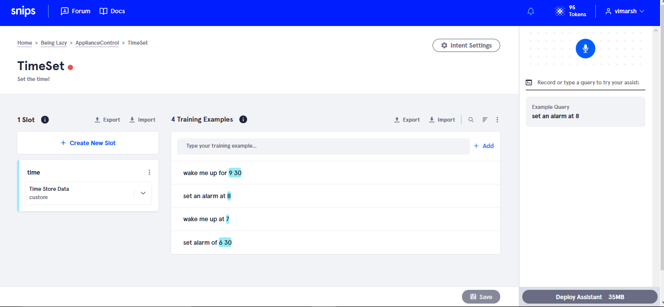

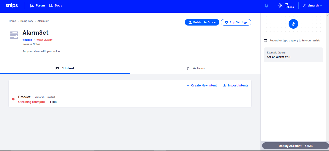

Alarm Set application for setting the alarms.image
Details of AlarmSetimage
Time Set intent in AlarmSet App.image

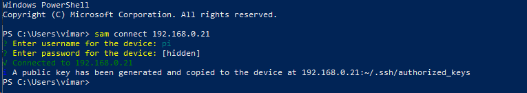

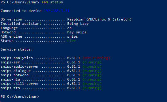

Connect to the RPi on SAM CLI on a terminal of your computer with
sam connect <RPi IP>
You will need to enter your credentials.
Then check if all services are working with
sam status
You should see that all services are working. The "snips-analytics" may not work but that is fine as it just handles some errors. If not refer to https://docs.snips.ai/additional-resources/troubleshooting

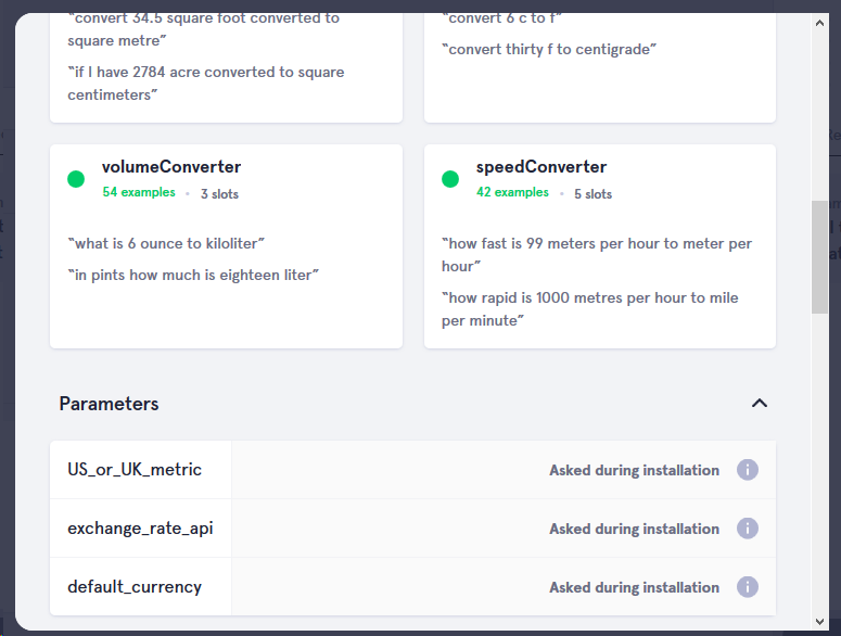

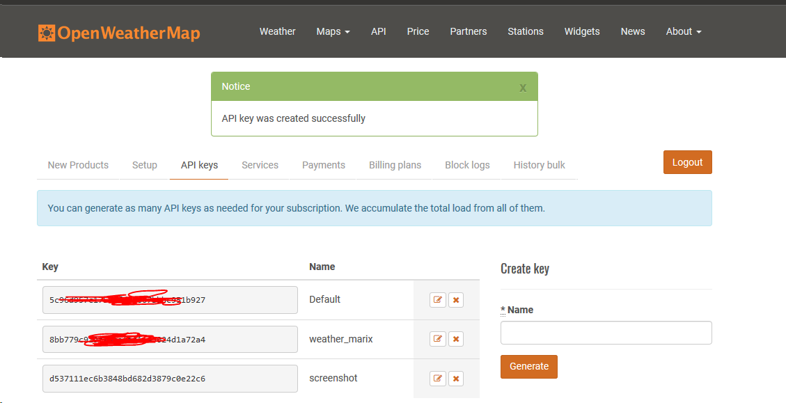

It will take some time to configure and then ask for credentials i.e., API Key and local region etc for the Calculations and Weather_en app.
Go to https://openweathermap.org/  Click on sign up and then login. Go to API Keys and "Generate" a new one and take note of that or put it in SAM CTL when asked.

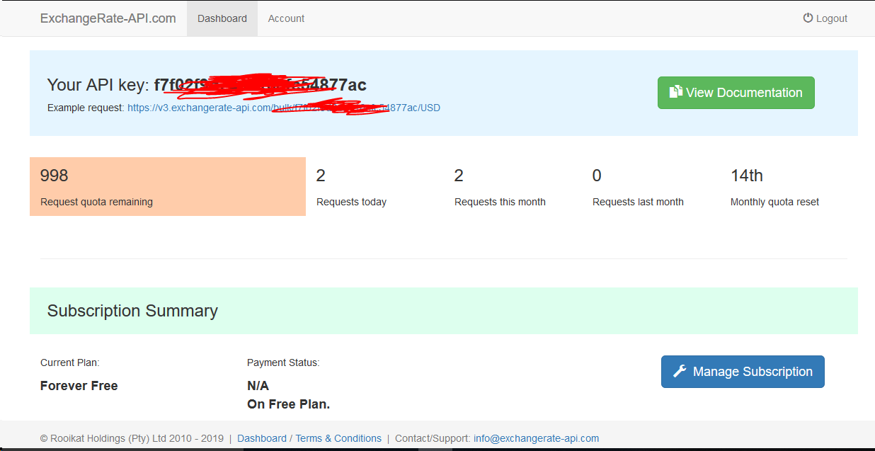

Credintials of Calculatations (Currency Conversion)
Go to https://www.exchangerate-api.com/  Select start now after putting your details and you will get the API Key
Take a note of that and enter into SAM CTL when asked.

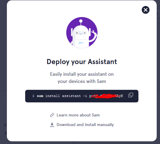

Then you need to deploy your assistant.
Go to snips console and select your assistant on bottom right click on "Deploy Assistant"
You will get a cmmand like this, copy and paste in your terminal os SAM CLI
Now enter all the API keys and other information and your assistant is good to go.

Satisfactory Slow Motion Footage of that everloop leds:
