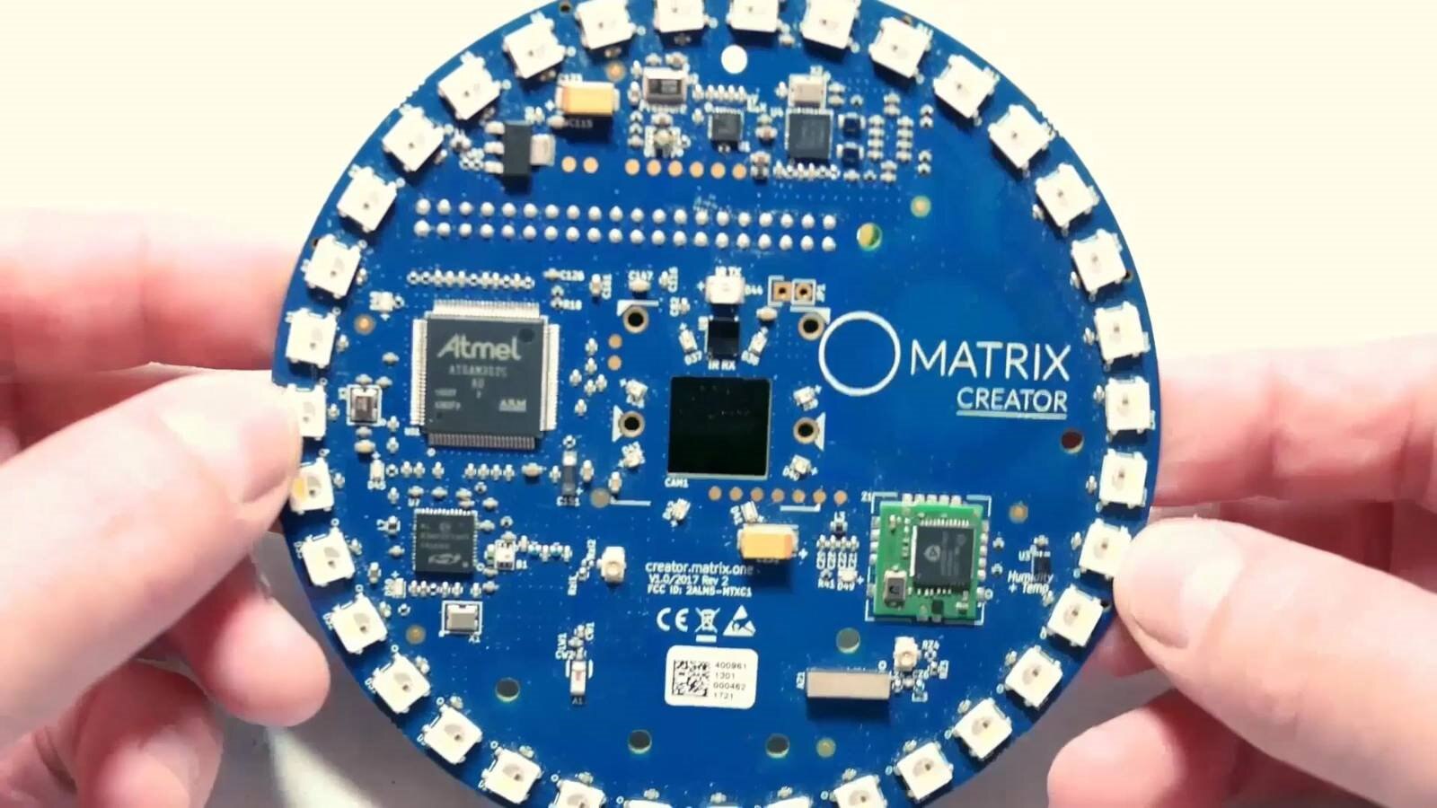

PART 5 - THE HOUSE HUB:
From blog posts 1 through 4, we provided our fundamentals to home automation.  To bring it all together, we'll now deep dive into the House Hub.  For our main control hub, we are using a Raspberry Pi 3 A+ with a Matrix Creator Board.  This gives us a full blown Linux computer, essential sensors, a security camera, and Voice Control through a small, wall mountable package (with a little 3D printing).
Raspberry Pi 3 A+https://www.element14.com/community/view-product.jspa?fsku=2946269&nsku=80AC9303&COM=noscriptProduct Link
Matrix Creator https://www.element14.com/community/view-product.jspa?fsku=2675819&nsku=05AC8548&COM=noscriptProduct Link
To have all of our home automation devices talk, we need to execute a C++ compiled program at startup on the Raspberry Pi.  Within this program, it must be able to be a client for web sockets for standard and SSL connections.  Also, it must be a server for web socket connections.  This will allow for full communication to the devices within the house, including commercial devices such as the Nest Thermostat.  In this blog, I'll first offer the code as standalone examples to serve future projects.  I'll then combine the code to make our House Hub.
To get your Pi and Matrix ready, do the following:
      • Install the Matrix Creator HAL package and Alexa App:  https://www.hackster.io/matrix-labs/matrix-voice-and-matrix-creator-running-alexa-c-version-9b9d8d
      • To ensure Alexa doesn't lock up when you are "headless", you need to modify the Alexa Sample App code.  That tutorial is coming soon.
