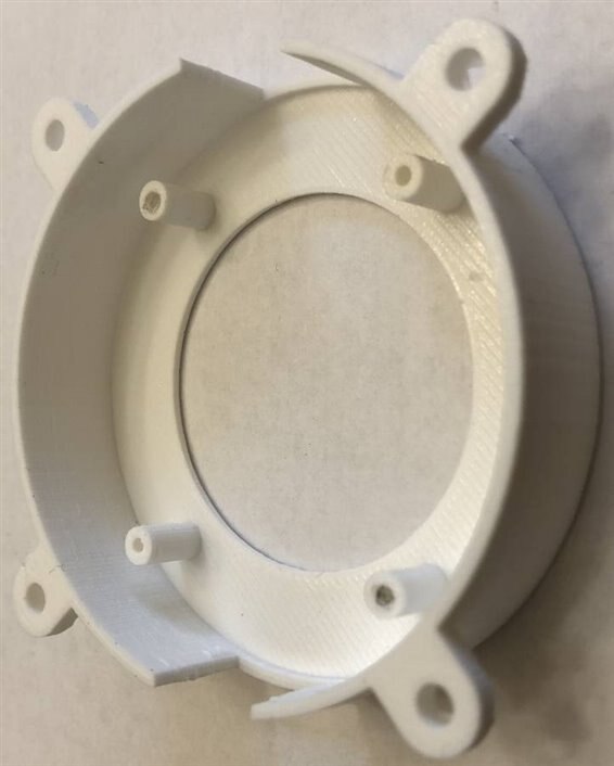

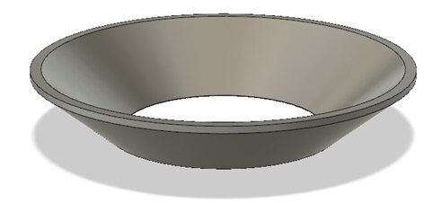

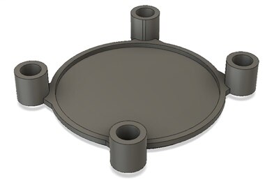

One of my goals for this project was to increase the light output of the LED pucks. Here is the latest generation of the light puck.  As is getting to be more and more the case, I spend a lot of time designing and print pieces for my projects.  Here is some of the Fusion360 views of my new parts:
The main parts are the outer case (printed in white), the light lens and light reflector (snap together pieces, printed in clear) and a template for cutting out the reflector foil.  The three light puck pieces represent over 8 hours of printing and I am now looking at building a total of nine lights, or an additional 64 hours+ of printing.  I guess I will just need to multitask my time around these prints as I design another set of enclosures for the 'Master' modules and maybe a EnOcean based light sensor module.  Oh and I do still have some PCBs to design and some code to write.

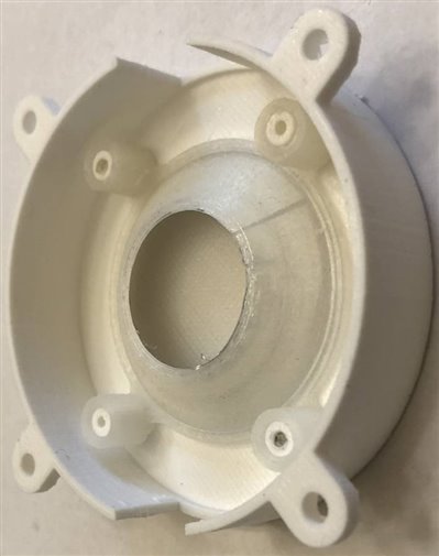

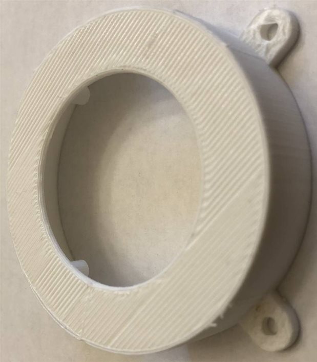

With the designs done, and a lot of printing done also, here are the raw parts, starting with the case:

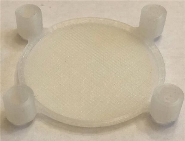

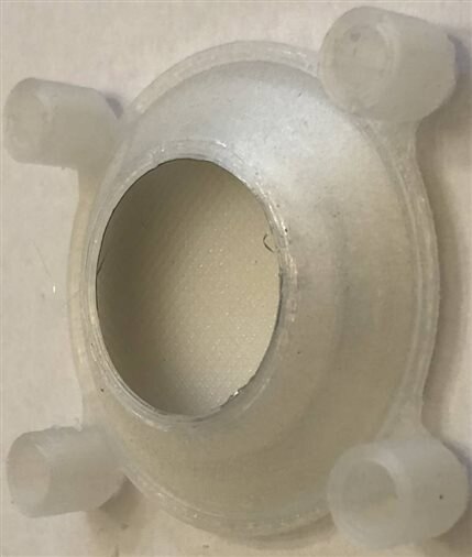

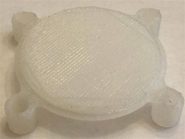

Here are the are lens shots:

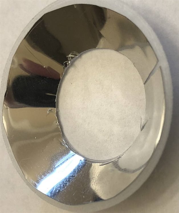

Here are the reflector shots (with the foil installed and sloppily trimmed):

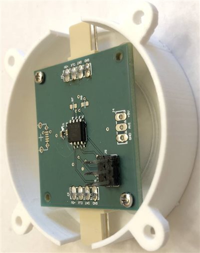

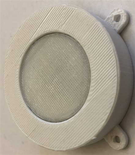

Now, time to put all of the pieces together and see how they fit:
The reflector cone snaps into place on the backside of the lens and the lens mounts on the case mounted stand off/screw holders, which helps keep all of the pieces aligned during assembly. I was very impressed with how well all of the pieces fit.

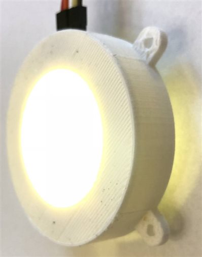

With the light puck fully assembled, it is time to try it out:
The new light puck measured a Lux output at 10" of 1168.  This compares to the light output of the original light pucks (exact same electronics and LEDs) of 637 Lux.  This represents a >83% increase in light output.  I still have a bit of work to go before I can take updated light readings with a full compliment of revised light pucks.
There is visibly far less side emitted light from the new lights, but still a small amount.

    Thanks!  I am not sure if it can properly be called a lens.  It mostly functions as a light weight diffuser and a cover.   The light pattern is not really formed and only slightly diffused (there is evidence of multiple shadowing from the three LEDs).  I will have to install these to see how usable the lighting will be.
    There does seem to be some articles that say it should be possible to print real lenses, but the PLA that I am using is not that transparent (there are some interesting 3D printer settings that I might have to try, that might increase the transparency of this PLA). I do think that it would be interesting to try and add a prismatic surface to the diffuser/cover to see if I can add a little more diffusion without decreasing the measurable light output.
    Thanks for keeping me honest here, as I really should not have referred to the part as a lens. image
