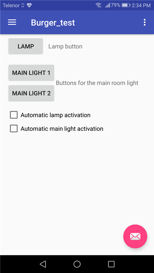

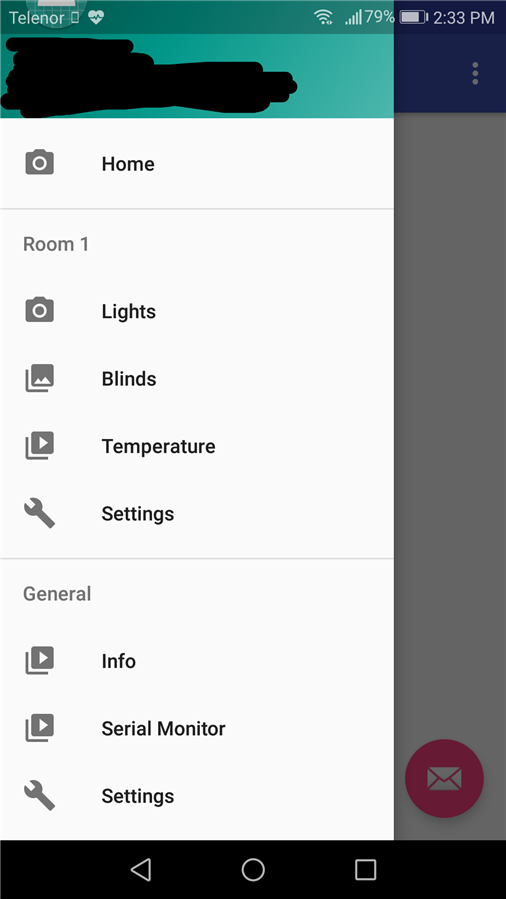

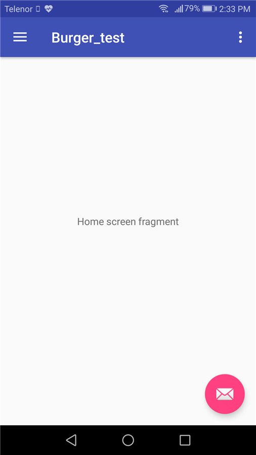

    • Android

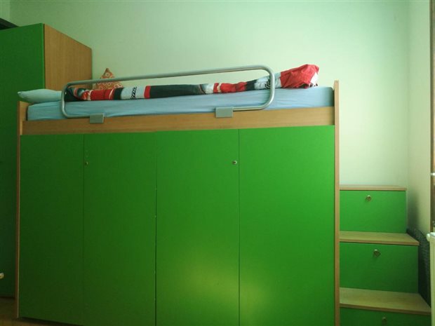

     The main inspiration for me to get into this project was my bed and here is why. I got a bed that's on the "second story" with storage space underneath it.
      There is no power near it and the light switch is beyond the reach of me of whatever I did (At one point I would keep a skiing pole near my bed so I can turn off the light). This all causes a problem because if I wanted to read something before the sleep I had a few options, use my phone/flashlight as a source of light, somehow mount a lamp with a long cable on top of my cupboard, get up after I'm finished with reading go down turn off the light and climb back up or of course make it so I can control the lights remotely. The obvious winner was the last option.
     With an idea in mind it was time to plan out the basics I wanted to do and just go at it. My main goal was to be able to remotely control the blinds and lights while leaving room for upgrading everything further down the line when I have free time. For remote controlling everything I went with 2 approaches, an IR Remote and I also made an Android app from scratch, one thing that turned out also was that I can also use my PC to control the lights, but I'll get into that later on. Since I wanted to use my phone as well I had 2 options, either WiFi or Bluetooth. I went WiFi since I've never worked with it and my phone is always connected to it anyway while it's in the house. As the brain that controls everything I went with the Arduino MKR1000 because I already had one and it has integrated WiFi on it with loads of pins for further upgradeability so It was a perfect candidate for this. I'll go now into the hardware I've used.

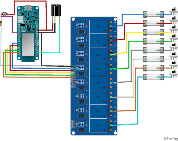

     There are a few things to cover here, I'll begin with the main unit that controls everything, and continue down the line with switches for blinds/lights, how I modified a lamp to work with the system as well as an universal box with a plug that I made which can control anything that can be plugged into it.
Main Box

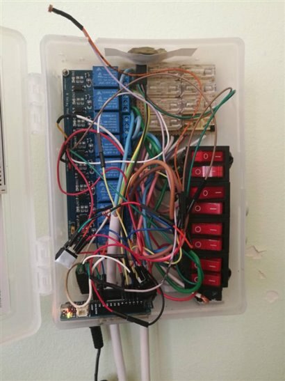

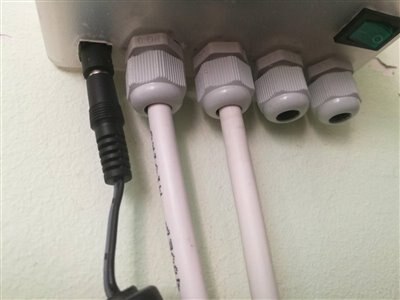

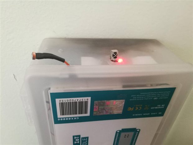

     As I've already said the main part is the Arduino MKR1000, while the main module is an 8 channel relay board that I got for around 10$ as well as an IR Remote set for around 4$. Besides that I used a lot of cable around the room, some switches as well as fuses and a small photoresistor for automatic lights. Here is the schematic of the main unit for the room:
All of the appliances now get connected by connecting one of the wires to a relay and the other to the end of the switch. I'll say it one more time, if you plan on attempting anything of this nature be aware of things you are working with because they can cause serious injury/death, I'm not recommending anyone to try out their own and you would be doing this on your own risk. I put in series with all of the relays a fuse and a switch, the reason for this is safety and experimenting the idea being having the switches which would turn off that channel if I want to change something fast without turning off the breaker. Both the switches and fuses turned out to be a really smart edition since in one of my first tests I connected something wrong and well:
That black color on the top is from one of the fuses doing its job and exploding pretty much, but because of it nothing else got damaged and because I used good insulated switches I wasn't exposed to any harm while flipping the breaker. I disconnected everything then and reconnected everything, and when trying out again, everything looked great (nothing exploded this time). So again, be careful and take your time if you're doing this, I got lucky for the most part with this. The picture above shows the box which holds all of the electronics, I used what I had on hand, and well this is something I plan on changing for sure, since it's an incredible mess inside.
While it looks like a mess (because it is for the most part), all of the wires that are connected to absolutely anything are very well attached to where they need to be or insulated so they don't cause any damage, there are a few free wires from unused fuses that are pretty hard to get out now. Besides the things I've said until now, I've added 2 more things and those are a power switch for the Arduino itself as well as a jack for powering the Arduino, to power it, I used some old 5V charger I had laying around and it worked without any problems. One thing I made sure was that all of the cables with 220V were firmly secured so they couldn't be pulled out on accident causing problems, to solve this I used these cable holders (I don't know the term for them in English sorry).
I found them to work extremely well for me, when tightened there is no way for cable to go loose, the whole box will fall off the wall before one of the cables is pulled out on it's own. That would round up everything there is about the main box, and the thing that took the longest amount of time to do. I'll go now into the switches that I've modified to work with this.

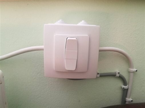

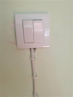

Switches and lamp
     For now I've modified 2 switches to work with my system, but have currently only integrated one of them. The thing I do to integrate a switch is, take it apart, and attach a cable in parallel to the switch. This way any of the 2 ways can be used to turn on the lights for example, but both need to be off for something to be off. There is a thing to look out for here though, that is with 3 state switches like I am using for the blinds, we can connect it in such a way that the blinds both want to go up and down in the same time (by leaving and forgetting the blinds physical switch on up and trying to bring them down by relay for example). This can cause serious problems and fry things so be careful if and how you want to integrate this, the blinds on my window have some kind of a protection against this but again be careful with that if you attempt anything similar yourself.
This is the blinds switch itself that I wired up, on the left is the 4 wire cable going to the blinds, the dark gray cable on the right is the power cord, and the white cable on the right is the cable which goes into the main box and then to the relays. The light switch is mounted in the wall but the principle is exactly the same as this, a 3 wire cable one "live" wire and two wires from the 2 bulbs from my light.
This light switch is the thing that is not yet integrated, for the wireless light I currently use a big lamp I have in the room (I usually use it for light, since I like how it light up the room better rather than the overhead lights). To use the lamp with the system what I did is cut one of the 2 wires that it uses for power and connected that split wire to the relay in the main box and that would be it. This means if the system is down for some reason I can't use the lamp but I always have the overhead lights. Next to cover is the universal box.

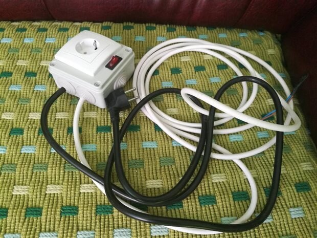

Universal Box
     I made this with an intention for using it for a small room heater that I have. I didn't want to cut the cable as I did with the lamp so I made this box with it's own switch and fuse inside that can be controlled by connecting to the relay. One thing to point out since I designed this with an intention to use for a heater rather than the 5A fuses I uses in the main box I put a stronger 10A fuse in here since the heater is around 1800W.
On the front of the box is a standard socket and a switch for controlling this channel, the black cable is the power cable, while the white cable is the cable that goes the main box and is controlled by the relay. This is something I would like to do to all of the sockets in my room, but keeping it all small in wall would require a lot of work and time. With that, that would be all of the hardware covered that I've used for now, later on I'll show what I plan on adding in the feature, now it's time to go to software.

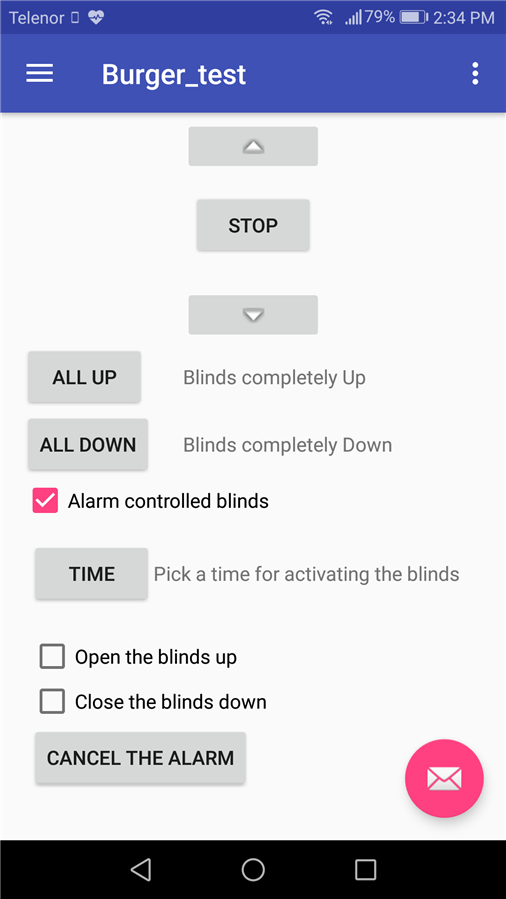

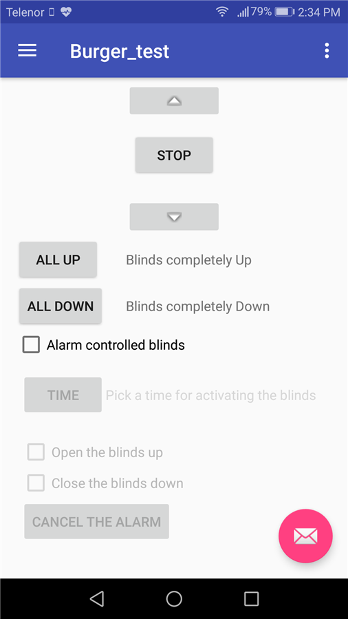

     I'll split the software into 2 different parts, in the first part I'll cover programming the Arduino with which this whole system becomes usable using a computer or the IR Remote and in the second part I'll cover the Android app I made and am still expanding and learning Android programming on as I go on. Let's begin.

  3. Interpreting the IR Remote
  4. Measuring light levels with the photoresistor
  5. Controlling all of the relays
The biggest problem by far was the IR remote, the code itself is very simple, but there was a problem with using the standard IR Remote library with the MKR1000 so I had to look around online until I found a library that works with my board. My whole code is built on of the MKR1000 example codes for WiFi. Here is the whole code, after which I'll go and explain some of the parts.

const int lumination_threshold = 600; // the lumination level at which the light sensor is triggered
This is the line with which I set the threshold value for the photoresistor, when the reading drops below that value, if the automatic lights are turned on, the light will turn on automatically, the automatic light option as it will be seen in the next part is a small checkbox in the app, I made it so it unchecks itself whenever you turn on the light manually

Android
     To test out if everything functioned properly instead of trying to go with Android Studio right off I tested everything with MIT App Inventor 2. Added a few buttons and a webviewer and it turned out it worked great. So great in fact that I kept using that app for a long time, until I wanted to get into Android a bit more so then I went and started from scratch. The app is still not finished but for what it is, it function flawlessly for controlling everything. I don't want to continue work on it until I figure out the best way to use 2 way communication between it and the Arduino and until I see what other things I want to add to the system. But I will be keeping this kind of layout for sure, here are some of the pictures of the app itself.
{gallery} Android App
Home Screen: Plan for this screen is having it customizable so you can put the things you use most often on here
Burger Menu: As you will notice in some of the images, it's named Burger Test, the reason behind it is was testing the Burger Menu and that's how the side swipe menu is sometimes called, so that name stuck with this version of the app
Lights Section: Most used screen for me by far, this is the screen that controls all of the light functionalities, everything works on it, but the main light relays aren't yet connected to anything so this is primarily for controlling the lamp atm
Blinds Section: This screen is used for controlling the blinds, there are the up down and stop buttons, while I plan on using the all up and all down buttons when I figure out some sensor for the blinds, will probably go with hall effect sensors for it
Blinds Section Alarm: When the checkbox is checked it unlock the other part of the screen which enables us to set up an alarm for the blinds, this is also a work in progress, currently deciding if I want to use the phone to send a signal at the chosen time, or use a RTC module for the Arduino and just send it a time for when to use the blinds
The code for the app itself can be found here https://github.com/MilosRasic98/Burger_Menu_Test , it's under the MIT license which means anyone is free to do whatever they want with the code, so hopefully it will be helpful to someone! I will be updating the app as I continue forward with it and probably upload it to Google Play once I feel I am finished with it! I am currently at the point with the app where I am working with the alarm but again, still haven't decided on the approach for this part. I am really happy with the layout and the design as it is now, there will be changes of course like a dark theme for the app and generally finishing the rest of the screens that can be seen in the pictures above. That would round up the software for this project as well so it's time to show everything working through some tests!

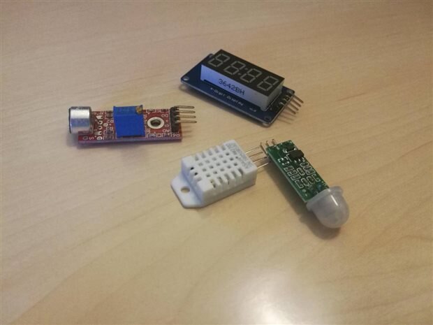

I got a DHT22 temperature and humidity sensor, PIR sensor, Microphone with an amplifier and both digital and analog outputs, as well as a small 7 segment display. The goal of course is showing the current temperature on the phone as well as on the small display, as for the other 2, the PIR sensor would work as an automatic light switch when someone walks in and it's dark in the room, and the idea behind the microphone module is to activate the lights by clapping. Some other things that need to be added as well are stop switches for the blinds, I will probably solve this by attaching a small magnet to the blinds and a couple of hall effect sensors on the side of the window and track the position of the blinds in that way. Some other ideas would maybe be a rain sensor which would close the blinds if it detects rain and open up as soon as it dies down a bit to let the fresh air in as well as an air quality module. But all of these things are a plan in progress for now.

    Oh so the name is cable glands, thanks so much, I was still wondering what the correct term is!
