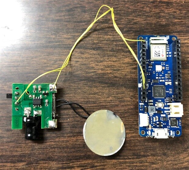

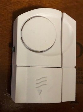

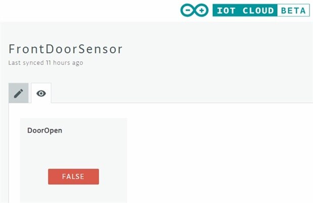

I've installed a few of those inexpensive magnetic door and window alarms around the house, but they only make noise, they are not connected.
For this project, I tap into one of the door alarms and send the door status to the cloud.
We start with this:

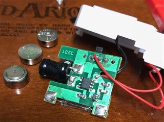

Take it apart:
Solder to the V+, Gnd, and trigger input from the reed switch.

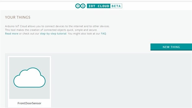

Then set up the Cloud service.

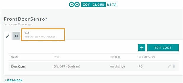

I set up a Thing called "FrontDoorSensor" on the Arduino IoT Cloud Service.

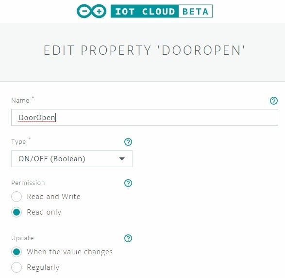

Then I set up a parameter called "DoorOpen"
Code for the Thing:

  DoorOpen = digitalRead(inPin);   // read the input pin
  ArduinoCloud.update();
Next I will add a motion sensor, and have the program email me a message on triggered event.
