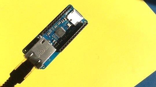

We'll connect an Arduino MKR to AWS IoT with an Ethernet cable and the MKR ETH shield.
I've done this before on a MKR1010 with WiFi. This post uses the same example, with a wired Ethernet solution.
With this example, you can safely connect to AWS and interact with their MQTT service.
What do you need?
  • An Arduino MKR Arduino MKR. Any will do, MKR1000, 1010, .....
  • An Arduino MKR ETH shieldArduino MKR ETH shield mounted on it
  • An internet connected Ethernet cable plugged into the shield.

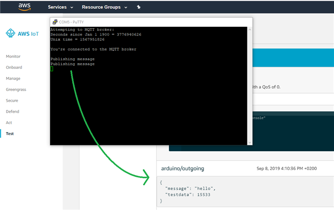

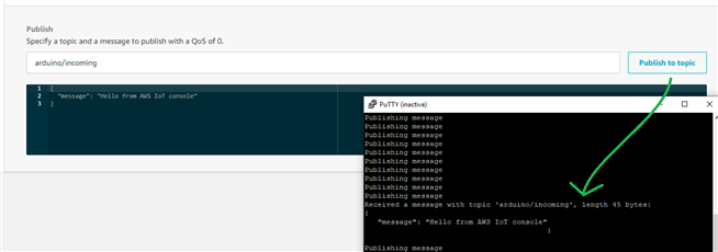

In the code below, you can see the full sketch, with connection to Amazon Web Services and the time server.
The example posts an MQTT message every 5 seconds (to arduino/outgoing) and also subscribes to a topic (arduino/incoming).

Watch your AWS budget. The example sends a message every 5 seconds. It's advised to not leave it running for long time, or to lower the frequency of messages to AWS significantly.
