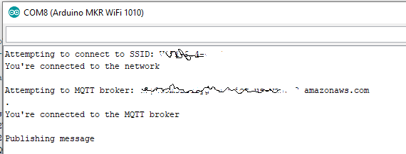

The sketch first logs on to your WiFi router. It will then make an SSL connection to AWS.
WiFiClient    wifiClient;            // Used for the TCP socket connection
BearSSLClient sslClient(wifiClient); // Used for SSL/TLS connection, integrates with ECC508
MqttClient    mqttClient(sslClient);
It uses certificates for authentication.
Once that's successful, it'll send messages to the topic arduino/outgoing and subscribe to messages posted on arduino/incoming.

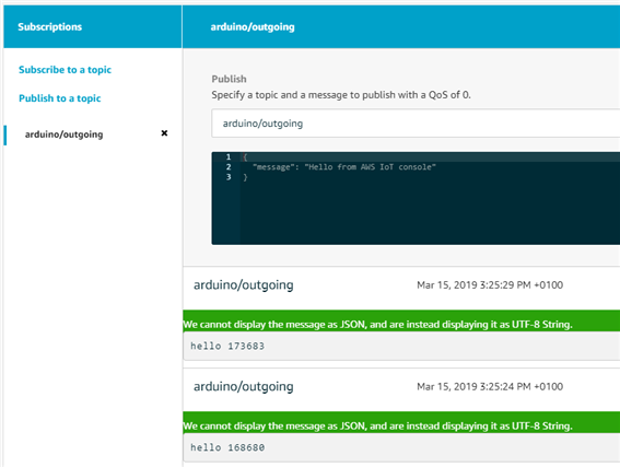

Here you see messages from the MKR1010 arriving in AWS:

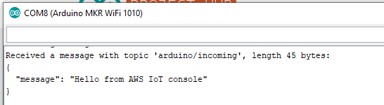

And this is a message from AWS retrieved by the MKR1010.
