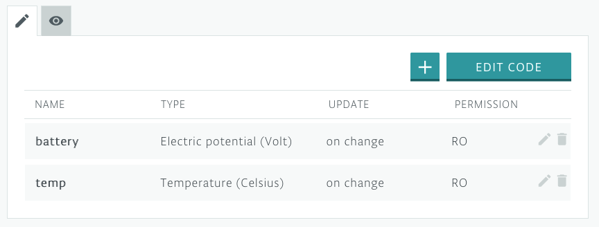

At the start of the loop function the WiFi module has to be enable again with the command digitalWrite(NINA_RESETN, LOW); After this command you have to wait a least 2.6 seconds until the WiFi module has fully booted. At the end of the loop function you have to wait 10 to 15 seconds and call ArduinoCloud.update(); several times to allow the transmission of the data to the cloud before you disable the WiFi module again. If you change the variables in the Arduino IoT cloud to update on change it seems like they are transmitted faster.

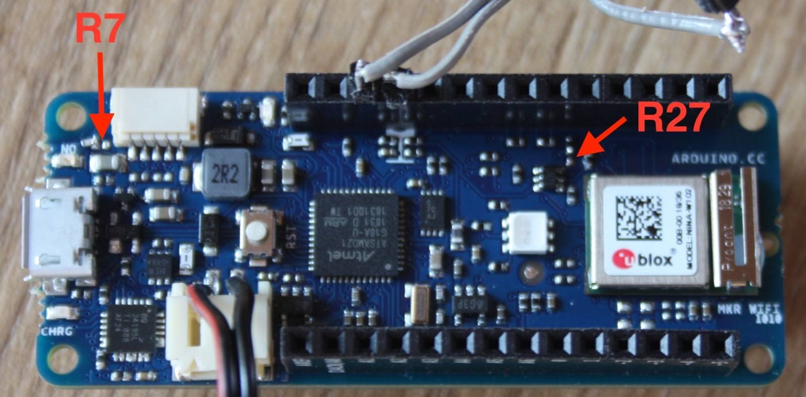

The next improvement is to use the ArduinoLowPower library and a timed wakeup as described here: https://www.arduino.cc/en/Tutorial/LowPowerTimedWakeup This reduces the sleep current to 5.5 mA.
Now it gets tricky. The next energy waster is the green ON led (DL3) which is directly connected to the battery and burns all the time. When you disable the LED by desoldering the LED or R27 the current is further reduced to 1.7 mA
The next step is to remove R7 which is a pull up to the reset of the WiFi module. This resistor is unnecessary as the WiFi module has an internal pull up. This reduces the current to 1.4 mA.
My final step is to send the ECC508 to sleep mode. The Arduino IoT library enables this IC but it is never disabled. To send this part to sleep made one has to first connect to it and the end the connection with the following commands:

    Thanks for this. By the way, your labels for R7 and R27 are swapped according to the board layout here -> https://store.arduino.cc/usa/mkr-wifi-1010
