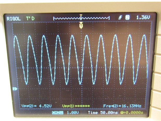

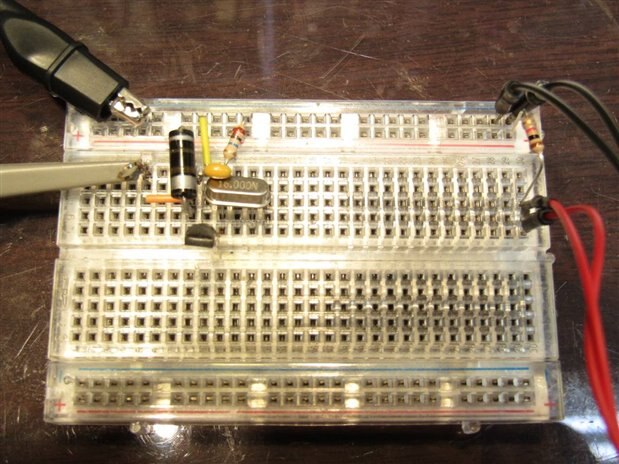

    I checked my inventory and I had a 2N5459 which is an N Channel JFET so I was able to build the original circuit. It is amazing what a nice simple circuit it is. Here is my bread board with a 16 MHz crystal
    and here is the Oscilloscope reading of the output:
    I will now try a few different crystals and do a little more study on the circuit. Thanks for the posting and the project tonight.
