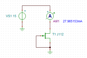

    The datasheet is vague about the Idss value, it just gives a minimum of 5mA.
    The model in Tina-TI has a much higher figure [28mA], though it's still less than the 41mA you seem to be seeing.

    It will happily drain 5 or 28 mA straight to ground. But it doesn't oscillate below +- 41 mA.
    I'll try to correlate the drain current vs gate voltage this weekend.

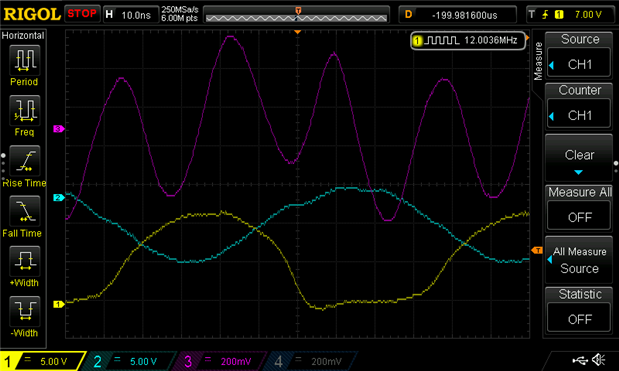

    Here's  capture. Without analysing.
    Yellow: the output voltage at the drain
    Blue: gate voltage
    Violet: drain current. 1 V = 1 A.
    one cycle:
    • Vote Up +5 Vote Down

    jc2048 over 4 years ago in reply to Jan Cumps
    Without analysing.
    Nope. Me neither. I don't understand why the current is three times the frequency.
    I think you need to draw us a picture of how you're doing the current measurement.

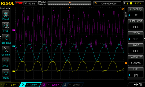

    Jan Cumps over 4 years ago in reply to jc2048
    A better probe attempt of the gate and drain voltage only.
    Powered from a 9 V cell with short leads. Both oscilloscope probes with pigtail ground leads.
    I removed the current shunt. Wiring it up between source and ground is a bit tricky with my current design.
    I have to clip the source mead of the FET for that and bodge the shunt in between that and ground.
    Because that's a cement 5 W power resistor, it's a bit involved. I prefer to do that with daylight available.
