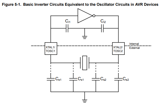

If it is so common in microcontroller circuits, why don't I ever see the inverter or JFET on modern designs, or on LaunchPads, Arduinos, MBED boards?
That's because most microcontrollers have the inverter part of the circuit implemented internally already. You just need to provide the crystal and 2 capacitors.
Here's a Hercules ARM microcontroller datasheet's schematic of the internal parts (abstracted). In essence it's the same Pierce circuit.
Why do I say it's an analogue circuit, when it is often implemented with a NOT gate?
Well, you'll see that when a NOT gate is used, the designers put a resistor in parallel between the output and input of the gate.
source: the article William bases his design on.
That resistor, together with the gate's input impedance and the capacitor at the input, turn this gate into an analog amplifier. We're perverting its digital behaviour and turn it into a high gain transistor (like, say, a JFET image ). That's why it only works with a subset of logic NOT gates. It wouldn't work if you'd simulate one in an FPGA.

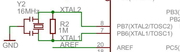

    I'll also try to capture some signals of development boards that use the concept...
    Arduino UNO:
    source schematic
    source ATmega328P datasheet
    source: AN2519 AVR microcontroller hardware design considerations
    note: captured with a differential probe. Not referenced to ground but signal over pin 7 and 8.

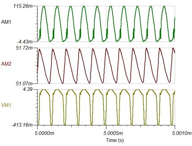

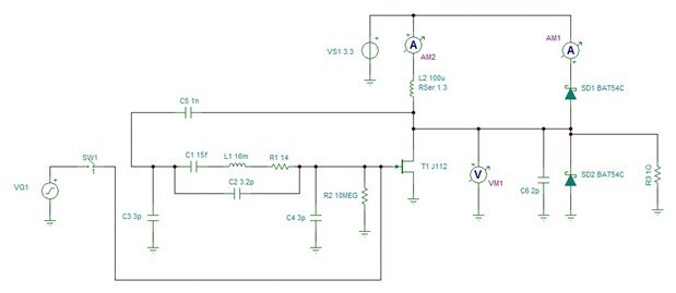

    Have a look at this.
    This is my simulation circuit, with a mock-up of the input of a logic gate added on the righthand side. There is probably a lot wrong with it, but it's a starting point for understanding what's going on.
    C1, L1, R1, and C2 is the electrical model of the crystal. Obviously it's a simplified model. It models the series and parallel fundamental mode resonances, but nothing else [you won't get this 'crystal' to work in an overtone mode!].
    For the logic gate input I've got a small amount of C for the input [probably should be a bit more than I've got there, 5 or 6pF would be more reasonable], similarly the actual input impedance of the input transistors is a bit notional as well at 1G. The two Schottky diodes are the anti-static diodes. Whether real ones are anything like a BAT54C I've got no idea, but it will do for illustration [sounds like an interesting, off-beat topic for an 'Experimenting with ...' blog].
    Here are the waveforms once the oscillator has settled. You can see from the currents the way that what is effectively a boost circuit runs current down through the upper diode to the rail. That would be very uncomfortable for a protection diode and you really shouldn't be treating it like that.
    There are some lots of qualifications here, obviously. Although diodes arranged like that have been a popular way to give anti-static protection in the past, there are other ways to protect inputs. My simulation is somewhat approximate. Also, the parameters of FETs are very variable. But it does show up a potential problem.
