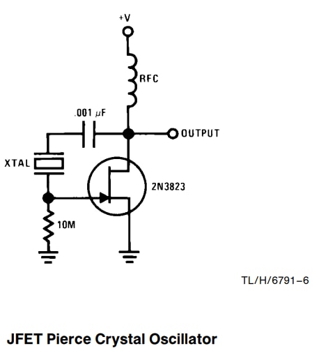

With the 5 components we'll make a Pierce crystal oscillator. One of the most commonly used oscillators in microcontroller circuits.
The circuit is often used in digital designs, because that's where we need clocks. But in essence it's an analogue circuit.
Like every oscillation circuit, we have to have a gain > 1 at the requested frequency, when the phase is 0 or 360°. So that the circuit keeps energising itself.
This is the extremely simple schematic that does that :
source: National Semiconductor application note 32.
I'm going to take a lot of jumps here over the difficult stuff:
  • the JFET is an inverter, and gives us 180° of phase shift.
  • the rest has to be approximated by the rest of the circuit.
You can take this for granted, or read the document from Ramon Cerda that I provided in the sources below.
The better you approximate the 0° /  360° goal, the efficienter your oscillator.
But it's very forgiving:
  • we are already over 180° image. Before 180°, gain works against us. Once this cliff is taken, gain supports the oscillation.
  • the JFET has plenty of gain
  • the crystal is a narrow band device
So even when things are terribly off, the circuit will still want to oscillate at the crystal's frequency.
I had guaranteed success with crystals between 12 and 19 MHz. Even if the power supply ramped up slowly and there was no hard trigger event to kick off the play.
With a 4 and 4.4 MHz crystal, I had to disturb the circuit (introduce some bounce by wiggling the crystal in the socket) to get the circuit oscillating.

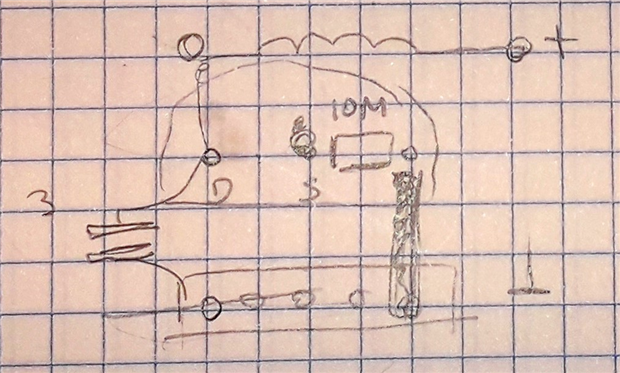

  • leftover perfboard. I built it on an 8 * 6 matrix.
    Don't breadboard this circuit. It's over 10 MHz. Use perfboard or a plain copper clad PCB. Or point-to-point.
    That said, you can see in the comments that jw0752 successfully built one on a breadoard.
  • a DC supply between 3 V and 18 V. A single CR 2032 coin cell will do. Or a pair of  AA(A)s, a 9 V battery, etc. or your bench supply.

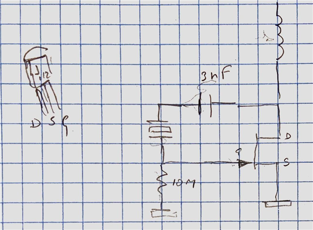

Here's the schematic I used. The same as the application note image. Just couldn't locate a 1 nF capacitor.

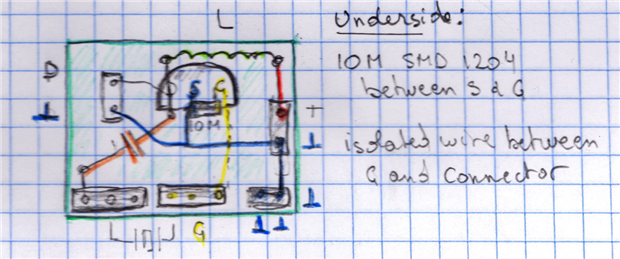

I then made a rough drawing of the perfboard layout
... and built it like that:
Here is that same layout, but redrawn after all was finished.
This can help to replicate the project on some perfboard:

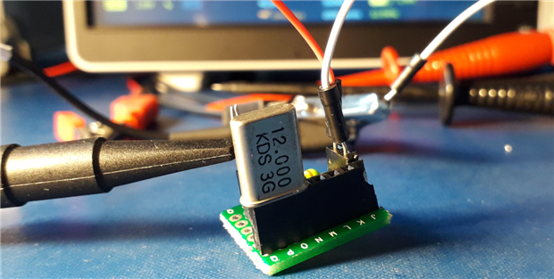

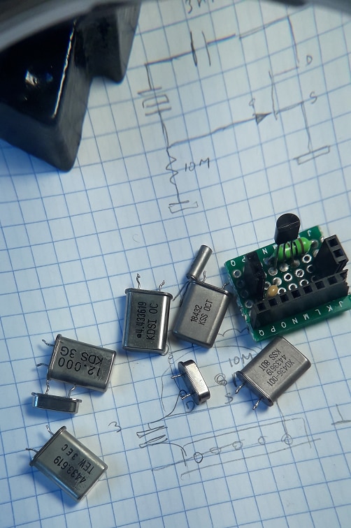

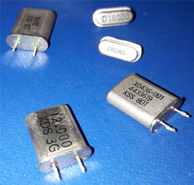

I gathered some crystals from my throwaway pile:
... and tested them.

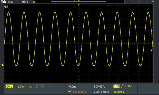

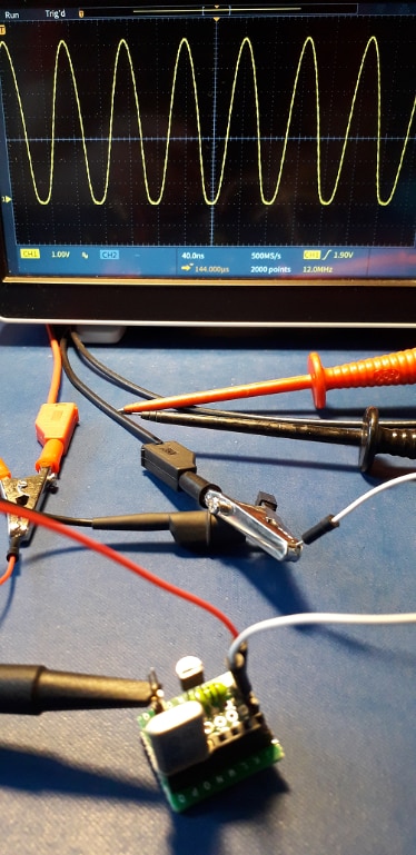

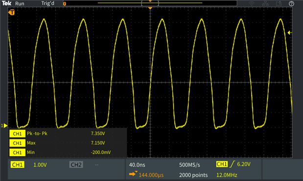

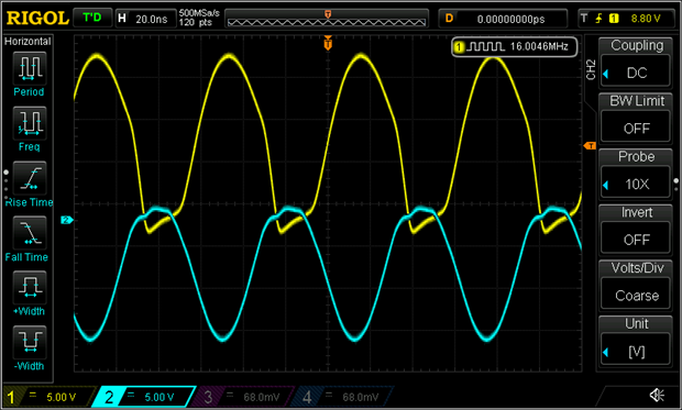

Above with a 12 MHz crystal. Below is a scope capture with a 16 MHz crystal. Circuit powered by a 3.3 V supply:
Here's the Pierce crystal oscillator in action:

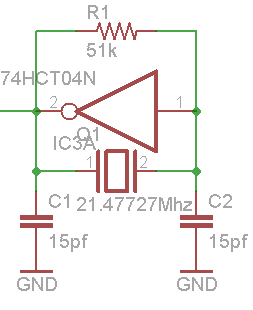

Why do I say it's an analogue circuit, when it is often implemented with a NOT gate?
Well, you'll see that when a NOT gate is used, the designers put a resistor in parallel between the output and input of the gate.
source: the article William bases his design on.
That resistor, together with the gate's input impedance and the capacitor at the input, turn this gate into an analog amplifier. We're perverting its digital behaviour and turn it into a high gain transistor (like, say, a JFET image ). That's why it only works with a subset of logic NOT gates. It wouldn't work if you'd simulate one in an FPGA.

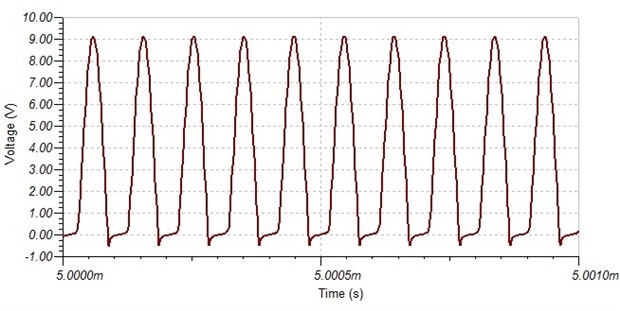

Looking at Gate vs Output
This is a common source n-channel JFET design, where the source is tied to the ground and is shared by input and output.
Here are the gate and drain captured, relative to that source (ground) shared point
The input source is a 9 V battery.
Both signals use the same 0 position on the oscilloscope screen and the same scale.
: The ground level is where you see this in the image below.image
As you can see, there's a lot happening.
One of those things is, that the gate is being pushed down to 15 V negative.

    Jan Cumps over 5 years ago in reply to jc2048

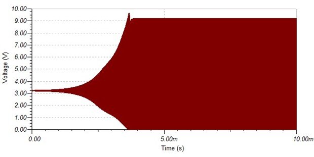

    I did part 1 of my homework - capture the circuit as is. 12 MHz crystal, 3.3 V supply with a relay controlled start. No bandwidth filter on a 100 MHz oscilloscope.
    The dynamic parts are at 1:1 speed - real time. I sped up the time between trials when the signal was stable, and while I was selecting the measurements.
    I captured the startup sequence with a soft start, 3 times.
    The snapshot below is a frozen period in time, but I saw -0.2 V to 7.2 V usually.
    Probed with a pigtail to please the probe purists.
    edit: resistance of my coil is 1.3 Ω (two-wire measurement)

    My prediction is that the development boards will be ok and stay between the rails.
    The reason for this behaviour, in this particular circuit, is the use of the RFC [radio-frequency choke]. It's a very simple way to get a good AC gain from the FET at the zero-gate-voltage drain current, but it leaves you with the DC bias point right up near the rail.
    jc2048  wrote:
    Here's a homework question for you: Are you comfortable putting a waveform that's swinging around the supply rail voltage like this into the clock input of an IC?
    The scope capture I posted is with a 3.3V supply. i watched its startup behaviour but didn't capture it to check peak voltage.
    I still have the setup, will check when time allows. I'll also try to capture some signals of development boards that use the concept...
