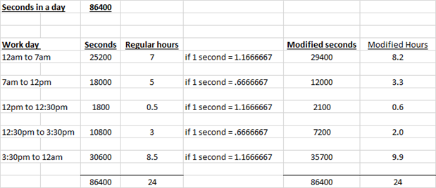

The (Modified) Work Time Clock
Here is how it works: (This is set for my work day)
00:00:00 - Midnight - Personal Time (1 second = 1.1666667 seconds)
to
06:59:59
07:00:00 - Work Time (1 second = .6666667 seconds)
to
11:59:59
12:00:00 - Lunch Break (1 second = 1.1666667 seconds)
to
12:29:59
12:30:00 - Work Time (1 second = .6666667 seconds)
to
15:29:59
15:30:00 - Personal Time (1 second = 1.1666667 seconds)
to
00:00:00
Work clock math:
So, with the Modified Work Clock you now work only 5.3 hours a day and have 18.7 hours of personal time. This clock still keeps your day at 24 hours but changes the actual time you worked and your personal time.

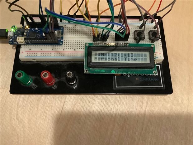

A video of the time changing from personal time to work time. (Notice the difference in the seconds):

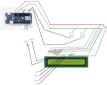

Rough sketch of the setup:
