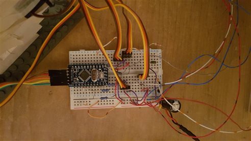

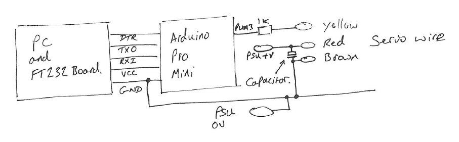

A couple of days after Christmas the servos arrived. As soon as I could I connected them to the Arduino using a breadboard.  A quick search of the internet got me a schematic that I could quickly implement.
The 1K resistor is there to protect the Arduino I/O if there are voltage mis-matches as the servos will be powered from a separate supply.  The arduino will be powered from the laptop,  the servos will take large current spikes of over an amp when they move.  More than I can take out of the USB Port on my laptop can handle so an external supply is needed.  I'm using my bench supply that can output up to 2A, set it to 5V.  The ground rail of the Arduino and the PSU for the servos is linked so they all have the same 0V reference.  As a precaution I used my Laptop on battery just in case there were some weird ground loops going on.
Although the sketch shows one capacitor, I actually added two, a 1000uf and 100nF that I found in my parts box, in a bid to smooth out any spikes.  The reason for using the two is that when the servo starts to move it'll draw a lot of current, and the power supply is relatively slow to respond to the change in current consumption.  The smaller value will help supply a small amount of additional power for very fast or high frequency transients / noise.  With the slower / lower frequency noise being dealt with by the larger capacitor.  When I get the opportunity I'd like to investigate these signals on an oscilloscope to see whether the capacitors are having the desired effect.  They were an add in, just in case.
The finished breadboard looked a bit of a mess... Ok a lot of a mess!  Still it works.
I wrote the program so I only have to send one command to the Arduino and ring a bell so the Arduino does the timing of the servos.
This works well, but at the expense of having to program the arduino with the relevant servo positions rather than just being able to control everything from the laptop.

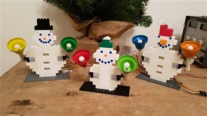

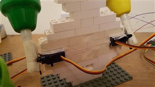

I've got so far but now I need something to ring the bells and what better than some snow people. Luckily I have a son who through the years has been crazy about Lego. So with his permission and assistance we built something to mount the servos to.  Quite how he has amassed so many white pieces I do not know.  However, there were enough to make these three characters.
I should add at this point that my son is now 16 and too cool for most things, but still got involved when he saw I was up to something interesting!
The servos aren't lego compatible, however I have found that engineers  I mean masking tape can be almost as useful as duct tape at times .

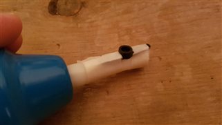

I found the bells worked best with the servo horn. (Black plastic bit) fitted toward the end of the bell handle to help the bell get a good swing.  Once again masking tape was used to hold it all together.  I chose to leave the screws off the horns so that I could easily re-position the bells on the Snowfolk.
Once it was all put together I had to tweak the timings and movement of the servo movements to get the bells to reliably ring.  This was trial and error until I hit on some values that worked.  I think it could still be perfected somewhat but it worked well enough for a family demonstration!

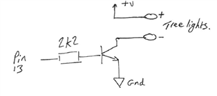

At the last minute I thought it needed brightening up! so I used the LED output (Pin 13) to drive a ZTX 653 NPN transistor Via a 2K resistor to limit current through the base of the transistor.  I used this high power output to switch the low side of a set of fairy lights on a small tree.  I hastily added it in using wires pushed into the contacts of the battery box for the Fairy Lights.  I set the lights to turn on or off each time a command is received.  I think next time I would opt to give the lights their own command to add more control.  Or perhaps get a bit adventurous with some neopixels.
