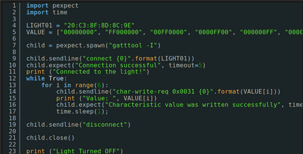

The Raspberry Pi 3 comes with BLE which can be used in a number of ways. The finished project at Holiday Lights and Music Festival With Love and Cheer uses BLE connected LED Lights and though a number of other things could be connected as well.
In this small post, I am going to add some details to the BLE python code for the project and allow the users to reuse the code as much as possible.
Starting off with BLE and Linux in Python
Notwithstanding the fact that there are libraries for both NodeJS as well as python for BLE, there are some other techniques that can be used to work with the interface. Take a look at the following script.
import pexpect
import time
LIGHT01 = "20:C3:8F:8D:8C:9E"
VALUE = ["00000000", "FF000000", "00FF0000", "0000FF00", "000000FF", "00000000"];
child = pexpect.spawn("gatttool -I")
child.sendline("connect {0}".format(LIGHT01))
child.expect("Connection successful", timeout=5)
print ("Connected to the light!")
while True:
    for i in range(6):
        child.sendline("char-write-req 0x0031 {0}".format(VALUE[i]))
        print ("Value: ", VALUE[i])
        child.expect("Characteristic value was written successfully", timeout=5)
        time.sleep(1);
child.sendline("disconnect")
child.close()
print ("Light Turned OFF")
It uses the gatttool in linux to control the same TI BLE Light and can be modified to talk to other peripherals such as the TI Sensor TAG. It is interesting to see how python can be used to wrap exiting utilities. I did a fairly detailed blog over at https://hackaday.com/2018/08/03/beginning-ble-experiments-and-making-everything-better/ but the idea is simple and can be used for other applications as well.
