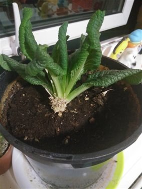

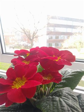

I have a plant in my room and sometimes I can't look after it because I am away. I don't want to implement automated watering system because I want to look after the plant that is the whole point. It is a hobby I enjoy and I want to have a bond with it. It is important to water it properly hence it can die without water and also with excess water. Therefore, I will build a watering system which will somehow show the plants status and water it when I am absent. If I have enough time, it can even send me photos or tweets image
These are her photo more than a month ago and now but unfortunately, she is not very healthy now image Flowers are dried before they blossom but leaves are still green. Therefore, there is a hope that it will blossom in the next season. Until that, I want to make sure it is watered properly.

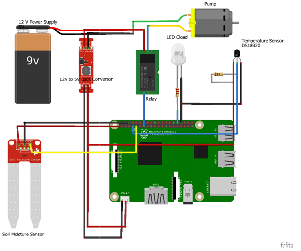

I have got the parts and implement the system. I still missing analog to digital converter but it is running and working. My main target is to aid to look plant. It is not an automated watering system. I planned two have two thresholds for moisture level. When it goes below the first threshold blink the led cloud and after the second threshold water the plant. Hence, I cannot get two threshold setting from the sensor, I implemented supervisorily watering. The plant blink led cloud and also send me an email in case I am not at home. If I cannot go I send an email to water the plant. The program logs watering warnings and successful watering. It also records temperature data every 10 minutes. Later, I can adjust the watering based on the temperature variations. It is easy to write the program but first I need to understand more about the plant.
I have 12V 2A adapter two supply system. It goes water pump via a relay and raspberry pi after step down to 5V via a regulator. You can see the inside of the box and completed setup in the following photos.

The watering system is working for the requirements I want but later I will implement some other functions like social media interactions. That is why I called it Social Plant Watering System.  You can get the schematic of the current system below. If you build the system for only watering Raspberry Pi 3 is waste of resource. Arduino will do the same job with less money and energy consumptionimage I had temperature and watering logs. Later, If I can find a correlation between the data and health of the plant, I can modify watering or system itself can adopt the best watering time and amount with some learning skills.

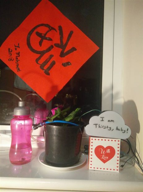

Here is the demonstration of how system work. I created a fake alarm and canceled the email part to shoot the video. It will first give a warning then water the plant and clear the warning.
System Features:
It measures the moisture level and warns user via led cloud and email when the water level is low.
It waters the plant when it gets an email from the user
It doesn't water more than once in a day to prevent over watering
It records temperature data every 10 minutes
It records when the watering warnings occurred and the system is watered
The parts used:
Raspberry Pi 3 - Arduino is the better use of resource if you don't do more actions. I will add a camera and use Twitter
12V Water pump
Relay
12V to 5V regulator
DS18B20 waterproof temperature sensor
Moisture sensor
LED Cloud
Jumpers

    she is not very healthy now Flowers are dried before they blossom but leaves are still green. I'm not a gardener, but the leaves appear to also be showing signs of dehydration despite the green colour…
    mcb1 over 8 years ago
    I'm not a gardener, but the leaves appear to also be showing signs of dehydration despite the green colour.
    You might also want to check if the plant is happy to live in direct sunlight, bearing in mind it's behind glass and it looks like it could get very warm.
    Thanks three-phase for adding me into this, and the reference to the four steps.
    msimon
    IMO your approach to the problem is on the right track. You've identified there is an issue and it needs to be rectified.
    You have also indicated one of your own goals " ... because I want to look after the plant ..."
    Many of the systems I've seen have some failure, which tends to cause bigger problems.
    The valve that controls it get stuck on, so it floods the plant and the surrounding area (and it's not just water at that point)
    Valves can fail but software can also fail either due to the program or a power glitch, so this needs to be considered.
    My approach would be to have a small container that provides water to the plant (enough that the plant/container could happily take in a single watering each day) and provide an overflow that can safely dump the water outside, or back to the start point.
    This small container has two level detectors which signal the software to start filling when the low level is triggered, and shuts off when it reaches the high level.
    Relays do get stuck especially when driving inductive loads like solenoids, so the fail safe system should interrupt power that these relays switch and could be a mechanical trip, or something not under software control.
    Fail to Safety
    The above might sound over complicated, but in each Engineering Solution you should be designing for "fail to safety" or in this case "Fail to Dry".
    This means control signals are held low and if the wire breaks it goes into the alarm state.
    Your level detectors should be wired so that if the wires are broken/disconnected nothing happens, while the Fail Safe should be connected that it will trip/operate if a wire breaks/disconnects.
    You might also want to consider what happens during the boot up.
    Is there a possibility it will start watering or filling up because the outputs aren't set by the OS, and your SD card somehow corrupted when the power dropped.
    Good luck

    I tested relay when powering up or the raspi is off and powered, it is not active. I will use 'normally open' terminal so it is fine. I didn't check the powering raspi without SD card, I will test it but I guess it will be the same after shut down and powered raspi. I should properly test the software before implementing it. The code I am writing is not a bare-metal and running on the top of an operating system so if the OS freeze, program can be stuck at an unknown point. The solution can be resetting raspi based on the sensor result without software like the third option in this link https://www.makeuseof.com/tag/add-reset-switch-raspberry-pi/  .
    I think the main problem here is the stuck relay because it doesn't matter sensor sense over watering and I shut down the raspi. It will still continue to watering. Having water for a day will be safe but sometimes I am away for a week. I want it to work also that times. I should think more about this problem. For a temporary solution, the pot has draining holes at the bottom if fit it top of a container, it will prevent the overwatering. The downside is there won't be a water in the irrigation tank for the next days. If we consider the possibility of a rarely used relay to get stuck, the risk can be taken for temporarily.
    The plant doesn't like the direct sunlight but my room doesn't get the direct sunlight and I live in the UK which makes it harder to have a direct sunlight. I used a diluted fertiliser which I think also cause a problem so I let the soil dried. I don't know much about gardening just learning it. Now, I am watering regularly and seeing tiny new leaves coming image
    Fail to Safety
