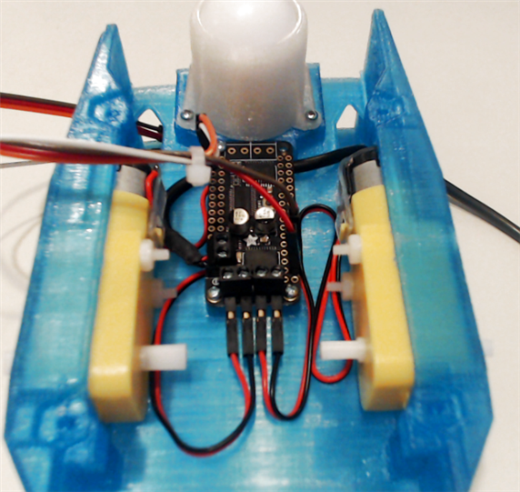

Motor Driver
The Motor Driver is shipped without the headers and screw terminals attached, so these need to be soldered by the individual.
The 3 pin header is for the 3.3v and Ground connection for controlling the Motor Driver, the Upper Screw Terminal is used for the Motors via the USB Power Bank.
The 2 pin header is for the SDA and SCL i2c signals and the 2 Screw terminals to the left are for the motor connections.  Note the orientation of the connections.
NOTE: The 2 Type A to Micro, right angle USB cables listed in the BOM are not identical.  The Micro USB Connections are mirror opposites so care must be taken to cut the correct one to attach to the Motor Board otherwise the Power connection to the Nano will interfere with the Ethernet port.
Here the Micro USB connection was removed and the Green and White wires were cut back as well as the shielding.  The Red and Black Wires were stripped back so they can be attached to the Motor Board.
Mount the Motor Board using 4 M2 self tapping screws and DC Motors to the 3D printed chassis with 4 M3 screws and nuts .   The modified USB cable is connected to the Screw terminal on the Motor Board and route the cable under the Moot Board and out the side of the chassis.  Attach the Motor wires to the Motor Board.
Connect the 4 Jumper wires to the Motor Board as such:

Final Assembly
Attached the NVIDIA Jetson Nano to the Chassis using 4 M2 screws.
Attache the Wheels and the Camera Mount on the chassis, and connect the Motor Driver wires to J41 of the Jetson Nano.image
