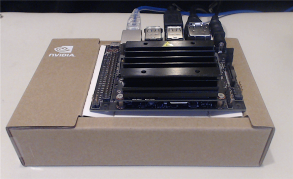

It took a bit, but I was able to finally gather the bits and pieces to get started on my version of the NVIDIA Jetson Nano JetBot.  The JetBot is an Mobile Robot Platform that uses the NVIDIA Jetson Nano for its compute power for AI-powered deep learning autonomous navigation.  The Jetson Nano is the latest Single Board computer, or rather System-on-Module in the Jetson line by NVIDIA.   The Nano is a more affordable System at $99 US where the Jetson TX2 runs $299 - $749 and the Jetson AGX Xavier at $1,099, although the Nano does have a scaled down set of features.

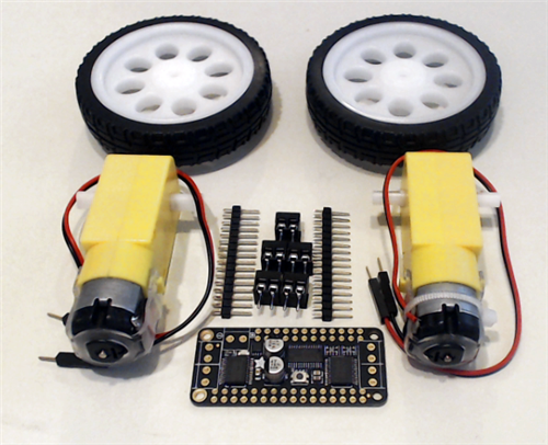

Motors2 X Adafruit DC Gearbox Motor -"TT Motor" - 200RPM - 3 to 6VDC (3777)
Motor DriverDC Motor + Stepper FeatherWing Add-on Motor Driver

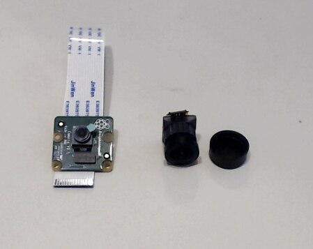

CameraRaspberry Pi Camera Module V2-8 Megapixel,1080p
Camera LensWaveshare IMX219 Camera Module for The Official Raspberry Pi Camera Board V2 8MP Sensor 160 Degree FoV

Wheels2 X Thin White Wheel for TT DC Gearbox Motors - 65mm Diameter

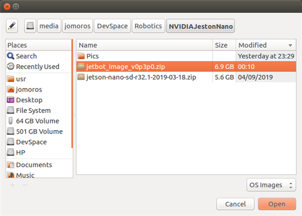

JetBot Software Image
https://github.com/NVIDIA-AI-IOT/jetbot/wiki/software-setup
  NOTE: Image is 64GB and may need a 128GB Micro SD card

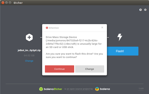

  1.  Download the JetBot SD Card image from the software-setup link posted previously.
       The image used in this example is:
       jetbot_image_v0p3p0.zip
  2.  Etcher was used to Load the Image on the SD card in this example.
       NOTE: For uSD cards 64GB or above, the card must be formatted for ExFAT
       a.  On Linux, use mkfs-exfat
       b. If not already installed, in the case of Ubuntu, use apt-get to install the required package
$sudo apt-get install exfat-fuse exfat-utils
      c. Format the SD card
$ sudo mkfs.exfat -n sdxc64 /dev/sdh
mkexfatfs 1.2.3
Creating... done.
Flushing... done.
File system created successfully.

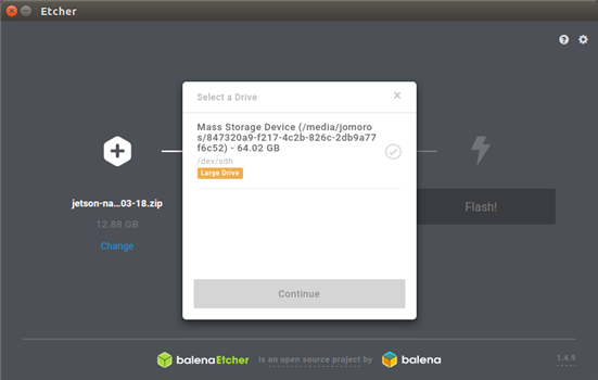

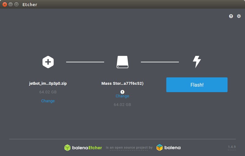

     d. Launch Etcher and select the image to install
     e. A SD card 64GB or greater will not show automatically in Etcher, so it is necessary to click on Select Drive to select the SD card
     f.  Once the card is selected, click Flash to copy the image to the SD card.
    NOTE: A Warning may appear regarding the size of the image.  Just click Continue
     g.  If performed on Ubuntu using Etcher, it is necessary to launch GParted to allocate the allocate space on the SD card.  Otherwise the Nano will not boot.
         Click Fix to complete the process.
     h.  Once the GParted process is complete. close the application and safely eject the SD card and insert it back into the Nano

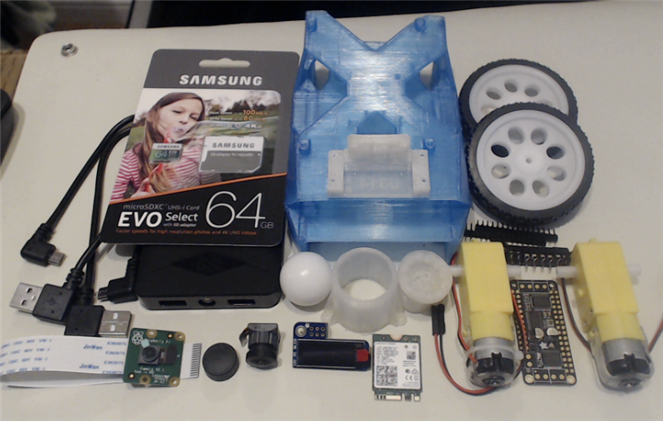

JetBot Hardware
   The JetBot Hardware listed in the Bill of Materials is sourced from multiple online sources, however some items may not be available. Considering the JetBot image is hardware specific, it is best to sick with what is listed in the BOM or a fair equivalent. In some cases, there are multiple options for a particular item, such as the wheels where the wider and white rimmed wheels were chosen in this instance rather than the skinnier black wheels.  The type of Micro SD card seems to be important to align with the JetBot image size.
NVIDIA Jetson Nano

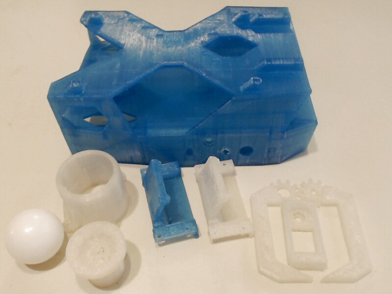

Chassis

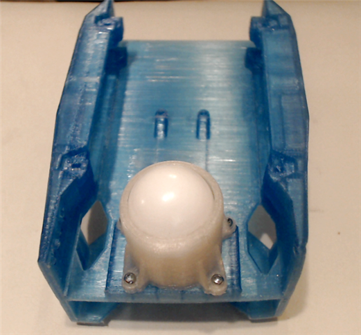

  The JetBot Chassis, Camera Mount, Caster Mount and Caster Shroud were printed on a XYZ da Vinci Mini 3d Printer.
   A 3D printed gripper was added for future use.
   Chassis with Caster attached
Wheels and Motor Driver
   The BOM calls out the Adafruit DC Motor + Stepper FeatherWing Add-on Motor Driver which has mounting holes that align with it on the 3D printed chassis.  The motors are standard Hobby Geared DC Motors from Adafruit rated at 200 rpm. The Wheels are Thin White Wheel for TT DC Gearbox Motors that attach to the DC Motors,
  OLED Display

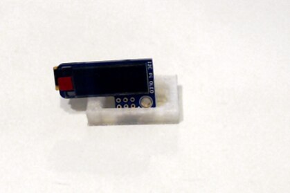

    The OLED Display is a tiny Adafruit PiOLED that is used to display the system IP Address and related data at boot and during operation.
Camera and Camera Lens
   The Camera is a Raspberry Pi Camera V2 that will have its camera module replaced with a Waveshare IMX219 Camera Module for 160 Degree Field of View

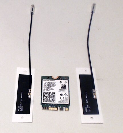

WiFi and Antenna
   The WiFi module is a M.2 Intel Dual Band Wireless-Ac 8265 W/Bt that attaches to the carrier board for both WiFi and Bluetooth 4.2 support. There will be 2 Molex Wi-Fi 3.3dBi Gain 2483.5MHz/5850MHz Film Antenna attached to extend the WiFi range.
With the hardware in hand and the 3D printer parts completed, its time to assemble the JetBot which will be covered in the next post.

    Yeah, the chassis ends up at about 135mm and the STL file has it printed standing on its end so it will be about 135mm tall.  The da Vinci Mini I have supports up to 150mm so I was right at the end of its capability.  However, somewhere in the print process, one side of the bottom warped out but stayed righted so one side is a bit shorter than the other.  It all fit together none the less.
