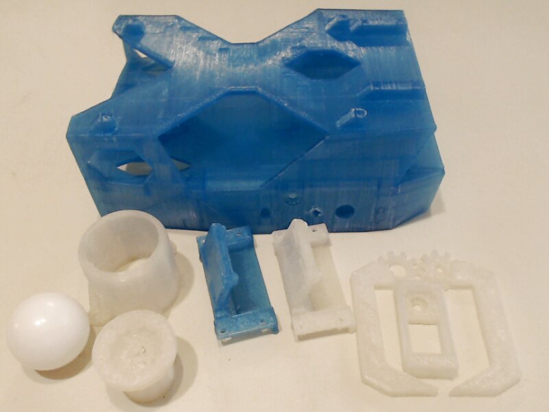

   The JetBot Hardware listed in the Bill of Materials is sourced from multiple online sources, however some items may not be available. Considering the JetBot image is hardware specific, it is best to sick with what is listed in the BOM or a fair equivalent. In some cases, there are multiple options for a particular item, such as the wheels where the wider and white rimmed wheels were chosen in this instance rather than the skinnier black wheels.  The type of Micro SD card seems to be important to align with the JetBot image size.
NVIDIA Jetson Nano
Chassis
  The JetBot Chassis, Camera Mount, Caster Mount and Caster Shroud were printed on a XYZ da Vinci Mini 3d Printer.
   A 3D printed gripper was added for future use.
   Chassis with Caster attached
