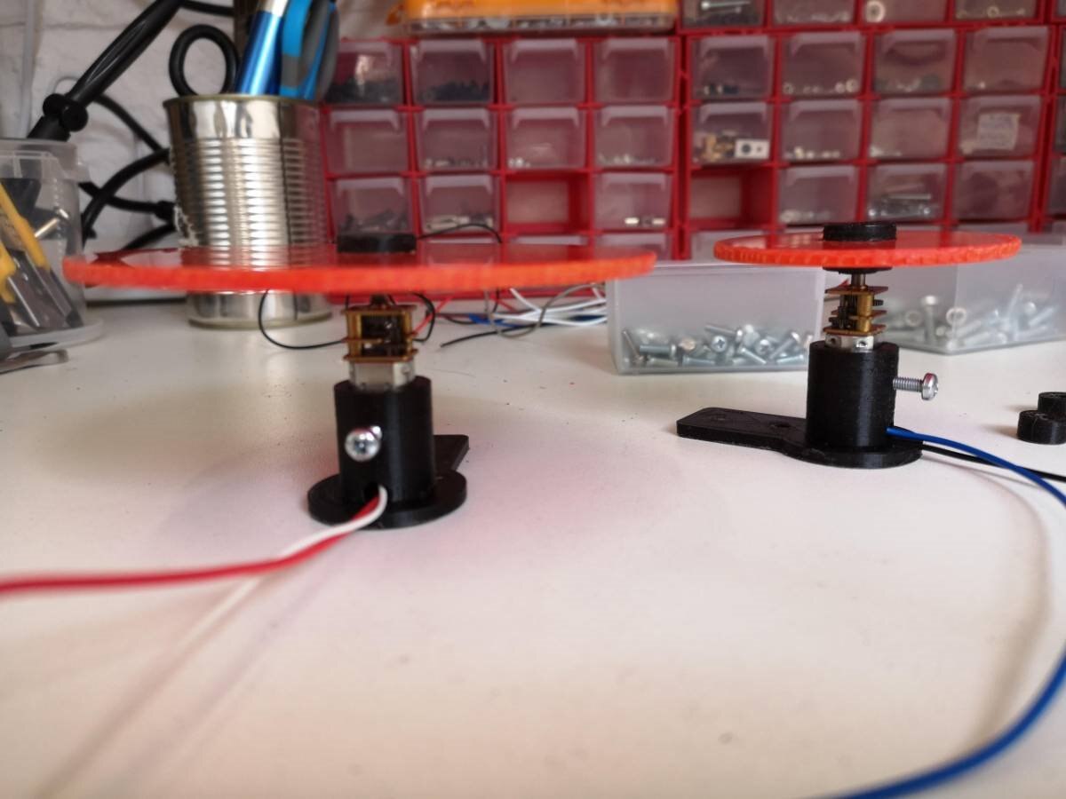

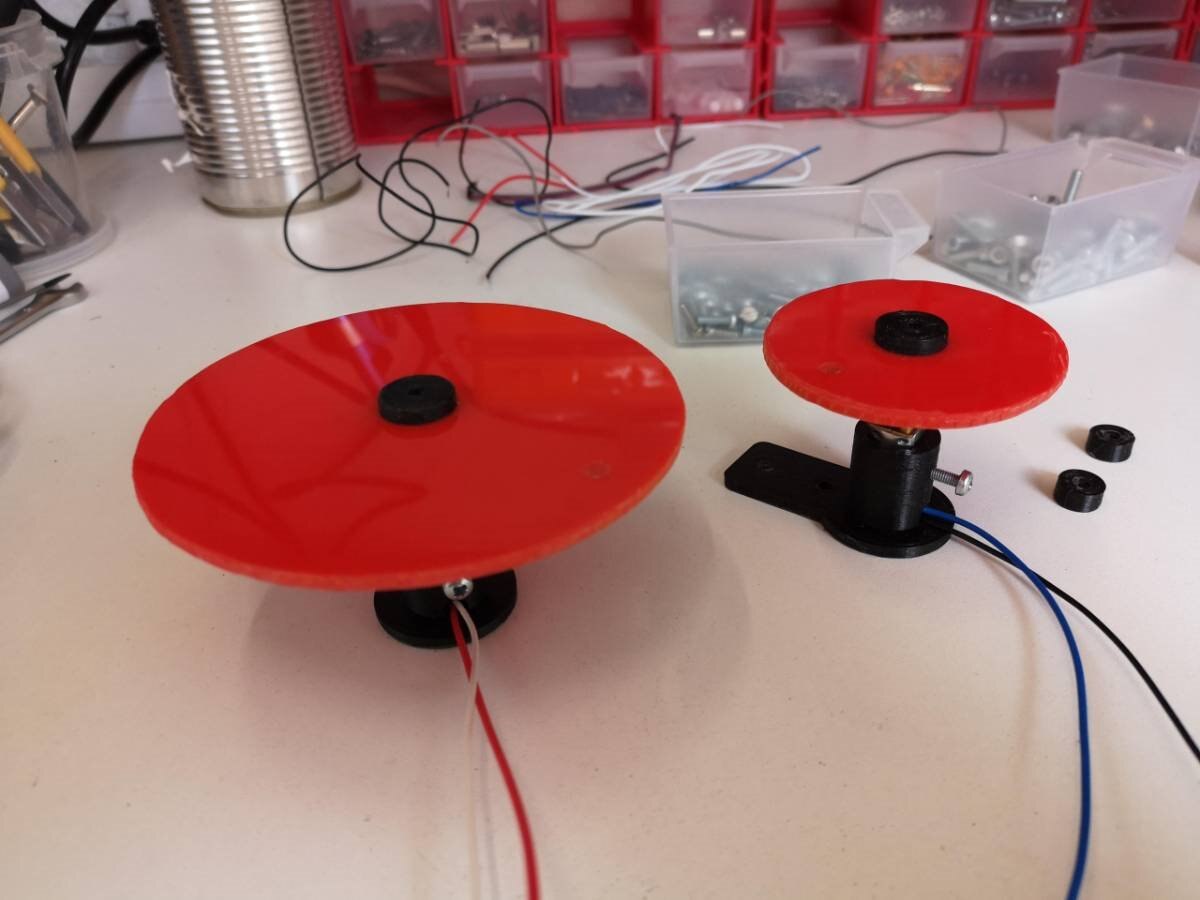

For the final version laser-cut, I have used red Perspex making two different diameters wheels and the motion transmission bars.
The next step was to set the motor shaft holders to the center of the wheels and the pen holder to the end of the bar with the wider ring on one side. Few drops of cyano-acrylate glue worked perfectly on 3D printed PLA and Perspex.
To complete the pen holder with the fixing screw I have forcedly inserted the nut and tested it. The weight of the metal parts helps to keep the drawing pen adherent to the surface while moving
Below: two phases while 3D printing the two motor holders with the Elegoo Neptune 3D printer. The device can reach higher precision, then the more common Prusa 3D printers, up to 0.05 layer thickness but to reduce the print time I have worked with a 0.2 mm layer thickness. This part is a mechanical part that does not need special care to the surface quality.
Setup the Motors
After heating a while the motors shaft and the PLA motor holder glued to the center of the wheels I have forced it inside. I have experienced that this technique can last a long time also with a considerable mechanical effort.
After cooling the shaft I have soldered the wires to the motors and put them under rotating test for a while. Thank the screwed connectors on the Kitronik All-in-one robotic board this project only needs the power wires soldered to the motors.
The last step has been assembling the motors in the 3D printeD motor holders.
Note that in the final design I have added a pressure screw to avoid the motors vibrating when drawing. In this case, where the force needed is not strong I have adopted the solution suggested by luislabmo in his blog post Hologram Pi-ramid - 3D printed parts and initial assembly: the screw hole has been threaded directly in the PLA 3D printed support with a 1.8 mm shell thickness.
