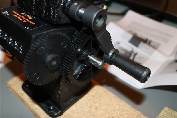

The next stage was to see if the arm could actually wind a coil, unfortunately the effort required to turn the weight of a drum of 1.0mm diameter wire attached to the former was too much for the robot arm and it stalled it.
The coil winding machine does have the option to wind on a 1 to 1 ratio instead of the 8 to 1 it is currently set up for. I started thinking that maybe changing the ratio would reduce the load on the arm and it may be able to wind the coil. Unfortunately, I then found out that the coil winder doesn't appear to be manufactured with enough clearance to allow the 1 to 1 ratio to be used.
To change to the 1 to 1 ratio, the handle is swapped with the location of the pulley, but then it catches on the shaft that the handle used to be on. I tried taking the handle right back, but this takes the securing screw off the locating flat on the shaft, and it still doesn't quite have enough room as can be seen below.
Even with the pulley removed, there is still not enough room for the handle to get passed the shaft.
With the handle located correctly, so the securing screw sits on the flat of the shaft, there is definitely no way to complete the turn.
Flat section on shaft, showing where the securing screw locates.
I can remove the large gear and shaft completely, but then the counter will not work. At the moment, I have ordered a collar and some slotted roll pins to see if I can extend the handle by 10mm to get the clearance I need.
