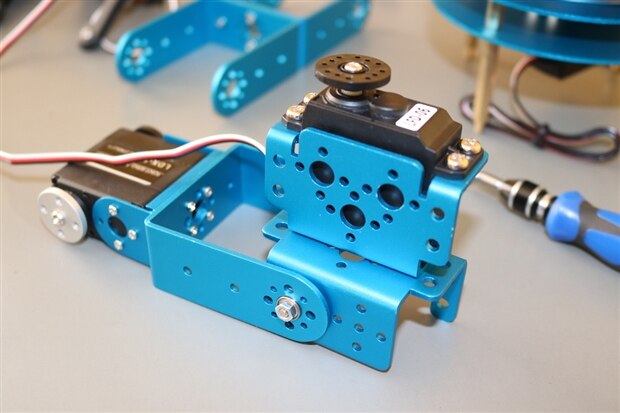

With that aspect sorted it was time to start the build - it was at this point that I realised there were no build instructions or software included in the box. Being ever the optimist I wondered how far I would get without the instructions and just rely upon the picture on the box and a leaflet included inside.
It is very easy to work out that the kit has to be assembled up in sections, before these sections can be assembled together to make the complete robot arm. Some elements were relatively straight forward and can go together without the instructions. I struggled with the more finer details around the bottom section mounting the servo drive and the upper arm, which is assembled in a slightly different manner to that in the picture on the box.
The fully assembly instructions and operating guides are contained in a set of videos on you tube, it was relatively easy to fast track through the videos to the sections that need more details and leave the screen frozen whilst the parts were assembled.

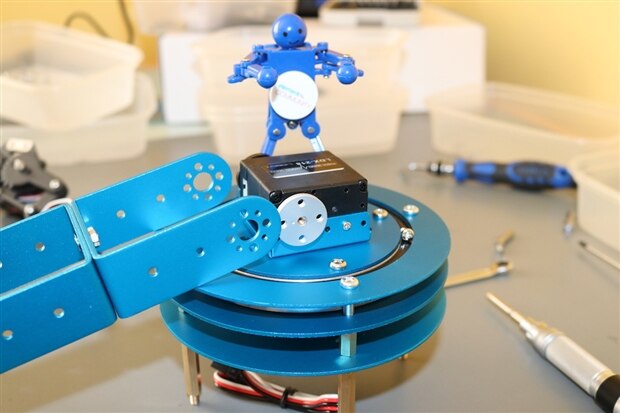

Once the first sections are bolted together, the assembly moves on to bolting these sections to one another
{gallery} Robot Arm Build 2
Bearing installed between bottom discs
Bottom disc assembly completed
Bottom arm servo mounted
Servos mounted in upper arm
Upper arm completed
Lower arm offered up to bottom servo
Grabber and bracket read for assembly
Grabber installed on top servo
Not too many issues arose drawing the mechanical build. I did note the following points during the assembly.
1) It was easier to remove the drive plate on some of the servos to allow the bracket screws to be installed
2) The machine screws and nuts that hold the upper arm brackets together are shown in the instructions with the bolts inserted up towards the top servo. This lifts the top servo off its mounting. I had to reverse these screws to allow the top servo to sit on its mount as seen on the right.
3) On a couple of the brackets, countersunk screws are provided to hold the plates together. A bit nit-picking of me, but I like to see countersunk screws in countersunk holes, otherwise pan / cheese head screws should be used.
4) The grabber is mounted to the plastic drive plate of the top servo with two 3mm self tapping screws - this seems a little weak and a potential break point.
