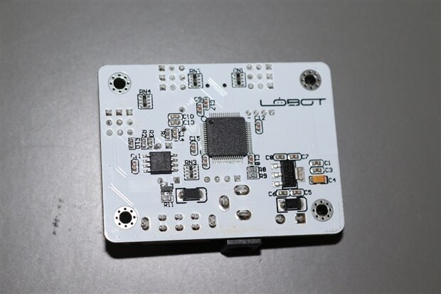

A close up of the control board supplied with the robotic arm. The board has a couple of different options for connecting power into it along with USB and wireless communications.
The main controller is on the bottom of the board, although it has not come out in the picture very well, it is an Arm STM32F103. It also contains a AMS1117 voltage regulator and a Winbond 25Q128FV serial flash memory.

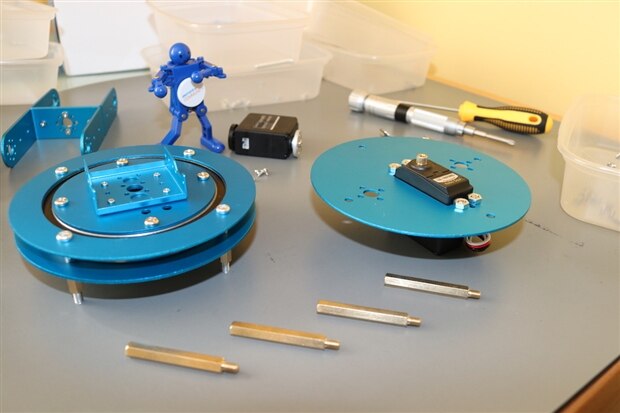

It is very easy to work out that the kit has to be assembled up in sections, before these sections can be assembled together to make the complete robot arm. Some elements were relatively straight forward and can go together without the instructions. I struggled with the more finer details around the bottom section mounting the servo drive and the upper arm, which is assembled in a slightly different manner to that in the picture on the box.

Bottom plates, servo and bearing built up
Bottom servo drive and plate screwed together

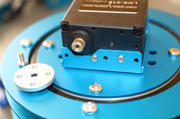

Bottom arm lower servo and bracket mounted on plate
Bottom arm brackets assembled

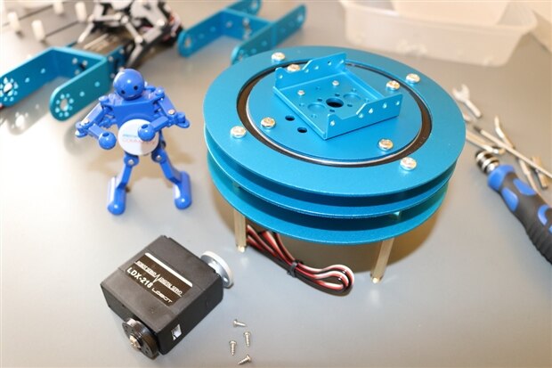

Bearing installed between bottom discs
Bottom disc assembly completed

Not too many issues arose drawing the mechanical build. I did note the following points during the assembly.
1) It was easier to remove the drive plate on some of the servos to allow the bracket screws to be installed
2) The machine screws and nuts that hold the upper arm brackets together are shown in the instructions with the bolts inserted up towards the top servo. This lifts the top servo off its mounting. I had to reverse these screws to allow the top servo to sit on its mount as seen on the right.

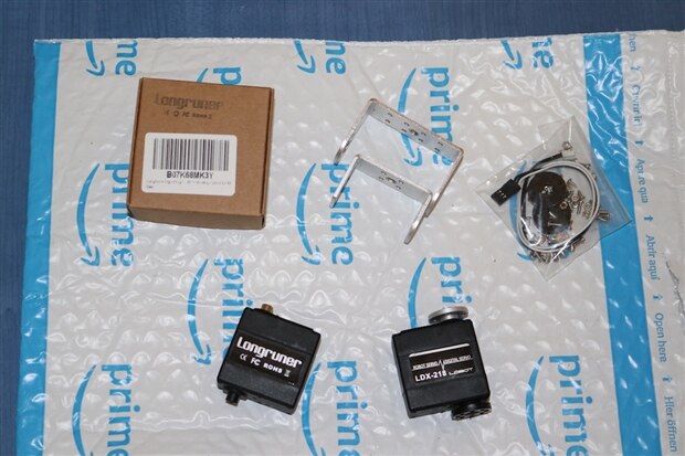

Then the biggest problem occurred, as I had not realised the stress I was putting the robot arm under whilst trying to turn the handle and one of the servo motors made out a loud graunching noise and became a bit too hot to touch. I switched off and let the servo cool down, but when I went to try the robot, although the servo would move, it seemed out of position and the control board would alarm. I dismantled the servo a couple of times and tried resetting the gearbox position, but could never seem to get it right.
A scout of eBay showed LDX-218 servo motors were available from China for £14 each, but with a delivery schedule of up to five weeks. A bit more searching found a similar looking servo on Amazon for £16, but was available on Prime for delivery the next day. I ordered on the Sunday evening, to have the servo arrive on the Monday, a public holiday in the UK, just after midday. Cannot really complain about that for service and as a bonus, the motor seemed to be completely compatible with the original and came with brackets and a screw kit.
With the servo motor replaced, the process of winding the handle was started again, with more care and awareness of the pressure being put on the robot arm.
