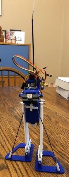

Today the 3D printathon has ended.  I finally have some peace and quiet at my desk.  At 2:00 PM, the final piece of WalkyII was printed (final for now?).  After a bit of assembly, WalkyII can now stand on his own.  Things went pretty well.  I needed to clean-up a few holes, tighten this, loosen that...... But in the end, it looks exactly like what I planned.
Once I assembled him, I decided to see how well he could walk.  I powered the 'original' controller board from the new power pack and hit the switch.  WalkyII did not do too well.  He toddled around like a drunken sailor and would tip over after each step (if not for my helping hand).  I appears that the center of gravity has shifted a bit from the original Walky.  Also some of the joints were a little loose, mostly the 'ankles'.  I did a little rework on the 'ankles' and adjusted the servo linkages a bit to shift feet a little further back.  I also adjusted the front linkages to get the feet a little flatter to the table (the above pictures are post reworks).  I still need to do something to move the feet a little further apart, maybe a slider positioned between the legs and the body, along the bottom edge, to spread the legs out a bit.
I did capture a few short clips of WalkyII walking.  While he is not exactly graceful, he can now toddle about without falling over.  I will need to fine tune his gait some, as he has a tendency to walk in circles.  This is all stuff that I can address when I start coding his new controller board.
Here are some of the 3D views of his legs, feet and ankles:
All of the pivot points on the legs are done using pressed in nylon shoulder spacer, in an attempt to have a free movement with a minimal amount of wobble.  The majority of the hardware to bolt everything together is 2-56 screws.  On the pivoting leg joints I used nylock nuts to lock the nuts on, without over tightening the joint.

    jw0752 over 8 years ago in reply to genebren +6
    Hi Gene, What you describe is a principal that I have come to accept as a factor in all repairs and modifications that I make to devices. Always expect and try to anticipate the side effects of any change…
    jw0752 over 8 years ago +5
    I think he looks pretty good. He almost has to sway to lift the leg that is moving. What would he look like with a rubber sole on his feet? John
    mcb1 over 8 years ago +5
    I've seen people walking like that ... in the same manner as jw0752 suggests. I wonder if a small rubber strip on the rear edge is enough. It seems the walking motion is to lift the front edge, and then…
